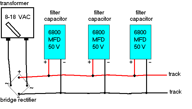

    me off the top of my head 10 V~15V above the transformer AC "unloaded" voltage.
    caps will charge to peak of AC less Vdrops across diodes so say for example
    10 VAC rrms x 1.414 = 14.14V AC peak
    your case with 17 ~ 18 VAC RMS (read as = DC over time) Id say 50 V is the best for you..and I think only voltage you could get 25V would be too low
    Ripple is really more to do with how fast current is pulled off the cap before it get its recharge pulse (of course it a little more complex then that crude statement.)
    so back tracking the flow of this
    the rectifier Bridge turn ac in to pulsating DC the cap acts a a storage bucket
    (smooths out the peaks, so its at one voltage level all the time just like DC
    (well it is DC)
    so what you get is a full bucket all the time if your not taking current from it.
    once you start taking current (add a load like a motor) from the cap depending on how much you take before it get it next fill determines the amount of ripple.
    Now if you already have full bucket but you add another bucket
    (here's were we will fall apart a bit, so lets just say when you add a capacitor in parallel with the filtered DC (which already has a cap) you just have a BIGGER bucket)
    The "bigger" bucket will reduce the ripple for the same amount of current.
    so yes there will be ripple just less of it due to the fact you got a bigger bucket
    I should add that depending on how far apart the caps are and the gauge of wire use to hook between them this may also effect operation.
    when ever you take DC from a psu like this it must be "from the caps" not the bridge
    Hope that makes sense

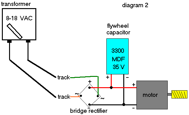

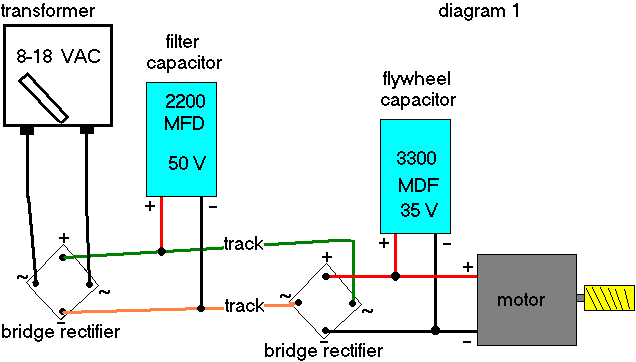

      So when filtered DC is fed to circuit in the locomotive (diagram 1) there is less ripple current to the flywheel cap, as opposed to just AC fed to the locomotive (diagram 2).
      I would like to achieve an effect where little if any ripple current gets to the flywheel cap. Perhaps just additional filter caps in parallel would result in less ripple to the track? Am I correct in assuming that the smoother the DC, the less ripple current? A battery has no ripple current? I guess the big question is: Can I build a supply with little or no ripple current just by adding more filter caps?
      Thanks!
      Take care, Joe.

        you first diagram shows 2 Bridge rectifiers, the second one(in loco) apart from a slight vDrop (2V say) across it would be pretty much the same voltage as the first DC voltage.
        it would have a "steering effect" on the DC
        (which possibly isn't such a bad Idea, Old trick for idiots with CB's)
        So your problem is really physical size of cap?
        As the circuits stands you will need close to the other caps voltage I would say
        the only way to reduce the size is to reduce the capacitance of the second cap
        you may possibly counter balance by having more on the first cap say make it 3300uf
        (yeah now you remind me there is a 35 Volt range with caps)
        Now I know nothing of how they work,
        so is that AC transformer a variable type Between 8Vac and 18Vac?
        So dc Aprox is 12V~26V DC (the 1.414 thing for peak AC)
        yeah more caps less ripple but you do this with in reason as other factors come into play
        So next guess is the varying DC is being used to control speed of loco?
        more capacitance will probably result in a longer latency in control.
        What you could do I think is actually build a "regulated variable DC supply" this would reduce ripple way down and you would get away with less capacitance in the loco I think.

          Thanks for the diagrams it helps understanding.
          Diagram 2 does not supply AC to the engine because the rectifier has converted AC to DC with ripple controlled by the cap.
          Diagram 1 is waste of time in that the first rectifier creates DC and the second simply passes that same DC and adds a circuit loss in the second rectifier. Connecting both caps together will lower the ripple, leave out the second rectifier. I can see that you are trying to run the track on DC . Why? Running on AC reduces contact arking.
          You cannot avoid ripple. It will always be there, except when the train motor is not a load. As soon as a load is applied ripple will be present. The amount is a product of the load current and the total capacitance. So a large cap = less ripple. The only way to completely get rid of ripple is to build a regulated power supply. Having said that, a motor could not careless about ripple, it is not a problem, most DC motors will run with a large ripple and in fact with no capacitor. It is only electronic circuits that are bothered by ripple.
              On bridge 2 True its pointless as far as psu goes DC wise
              Its a removable thing the loco and the line was AC which is why I asked
              it does allow the option of running on AC track
              Also it would ensure DC is feed in right polarity
              I knew there was a reason I liked the AC "contact arking" thanks

                          Hi Folks,
                          Many thanks for all the replies and great information!
                          The reason there is a bridge rectifier in the loco in the example is so it can be run on both AC or DC, and to keep the polarity of the cap correct. And without the bridge in the loco, someone could easily place the loco on the DC rails in the wrong direction and the cap would get reversed polarity, or place the loco in AC rails. I do eliminate the bridge in the loco when I use a bipolar cap on DC rails, but I didn't want to get into that to confuse the issue. (I have 3 rail O gauge track powered by either lightly filtered DC from a wall transformer at a fixed voltage or variable AC from old, but safe, train transformers, some quite powerful. Also 2 rail HO and S gauge.)
                          The size of the cap for my purposes in the loco needs to be 3300 mfd at least. What I want to do is use a cap rated at just about 16 volts because of the physical size limitations. The transformer would deliver approx. 8-16 VAC, but when my house is supplied with about 120 VAC, those toy transformers and wall transformers that aren't regulated will go high. Once I measured 122 VAC from the wall receptacle. However, I will never give the loco more than about 14 VAC.
                          As far the power supply is concerned, the caps can be any size there. I have a few 6800 mfd 50 volt caps that I could used as filter caps on the supply.
                          Would this help to eliminate a good bit of the ripple?
                          Many thanks!
                          Take care, Joe.

                              Sorry Joe I am trying to make sense of what you are doing.
                              1 Why do you require low ripple? Motors do not.
                              2. You say DC on track to reverse motion of loco. If polarity is reversed with a rectifier in loco the direction will not reverse. If polarity is reversed without a loco rectifier there must be no polarised cap in loco.
                              I assume you are going for option 2, keeping cap outside loco.

                                I don't understand the point of what you are doing either but I'll play along.
                                You don't need low ESR caps for these filters. Standard caps should do fine.
                                You say you only need 3300uF yet your drawing shows 20400. ??
                                How much room do you actually have for mounting caps?
                                Where is the polarity (direction) reversing switch in relation to the capacitors, rectifier, and track?

                                  Humm yeah well if by reverse you mean plus+ becomes minus- and minus- becomes plus+ on the rails
                                  then Iam with the others too
                                  it cant happen in the loco with the bridge and cap
                                  simply the bridge will "Steer" it
                                  (old trick to save CB rigs from those that liked to reverse the DC PWR leads called idiot proofing...and I hear all the ARRL members saying WHY????)
                                  So how is the reversing done in your case with that setup? as above
                                  Now without the bridge and a Bipolar cap yeah that will work I think
                                  You can make a Bipolar cap by putting 2 caps in series with either the + tied together or the -
                                  You can force equal voltage sharing by using resistors of same value
                                  (1 in parallel with each cap)
                                  Other wise its at the whim of the actual capacitors were the mid voltage rests
                                  But the BIG draw back here is you going to have to double the capacitors uf to get the same capacitance you want
                                  like for 3300uf you need 2 X 6600uf
                                  get the idea...now that isnt going to fit
                                  Also how well they work in a power type application I am not sure...maybe bonze or davmax can answer that better.
                                  (I am thinking it might be a case to use lower ESR types to reduce internal resistance, I could be wrong)
                                  Mostly you see this done with Audio.
                                  Thats if I remember it all correctly.
                                  Id say that site has something on this "reversing thing" so guess i'll go have a read.
                                  HTH
                                    Are ok you know that bout the bridge

                                        Starfury you are right about power release from caps. It is bad enough using DC that increases arcing damage, adding large cap values will create even more contact damage.
                                        This is not correct. Do not even try it. The caps will not voltage share on one polarity or the other. The one with reverse voltage/current will have a very low resistance. Reverse voltage on these caps should never exceed 1 volt max. Voltage sharing resistors are only used when two caps are connected in series and both in the same polarity.
                                        We still do not know why low ripple is required!!!!!!!!!!!!! If we know why then another solution may be applied.
