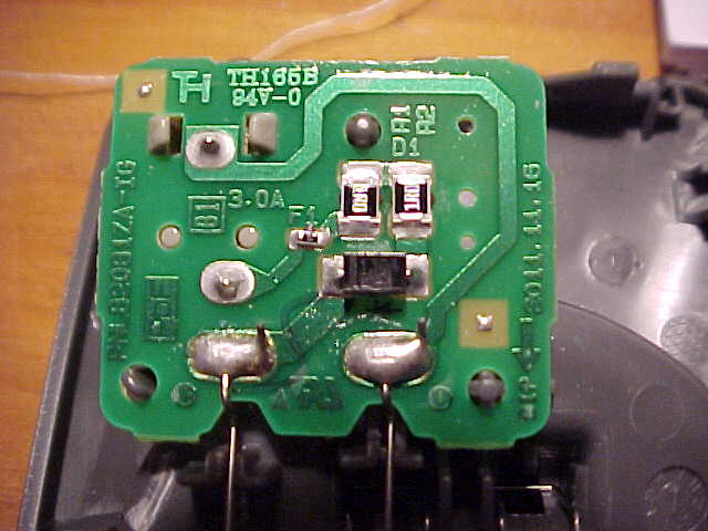

    Panasonic phone cradle not charging phone
    Panasonic phone model kx-tg7745s or kx-tg7741 (both these numbers are on the base unit) handset is kx-tga470 cradle is pnlc1029
    Over the last year, 3 of the cradles have stopped charging the phone. I tested the cradles and there is power at the contacts. The batteries are OK because a swapping cradles solves the problem. So I believe that the problem is with the circuitry in the cradle. I have checked the cradle with a test light and there is power there. See attached pic.

    As you don't mention the fuses
    have you tested them?
      • 31259
      Re: Panasonic phone cradle not charging phone
      the solder joints to whatever is on the other side supplying the power are cracked.
      and you may want to try bypassing the fuse - just for a test.
      other than that, check those 1ohm resistors actually are 1ohm.
