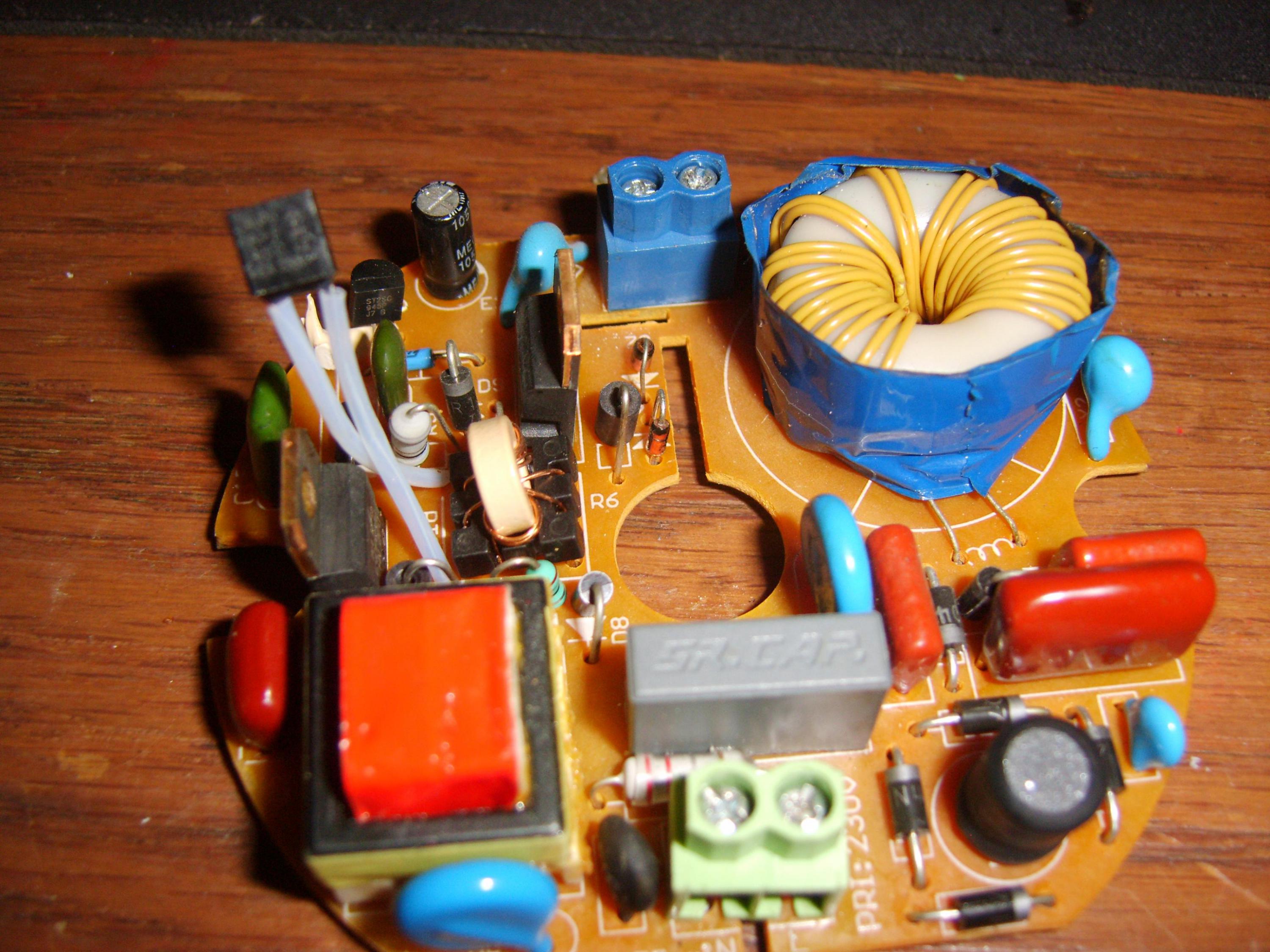

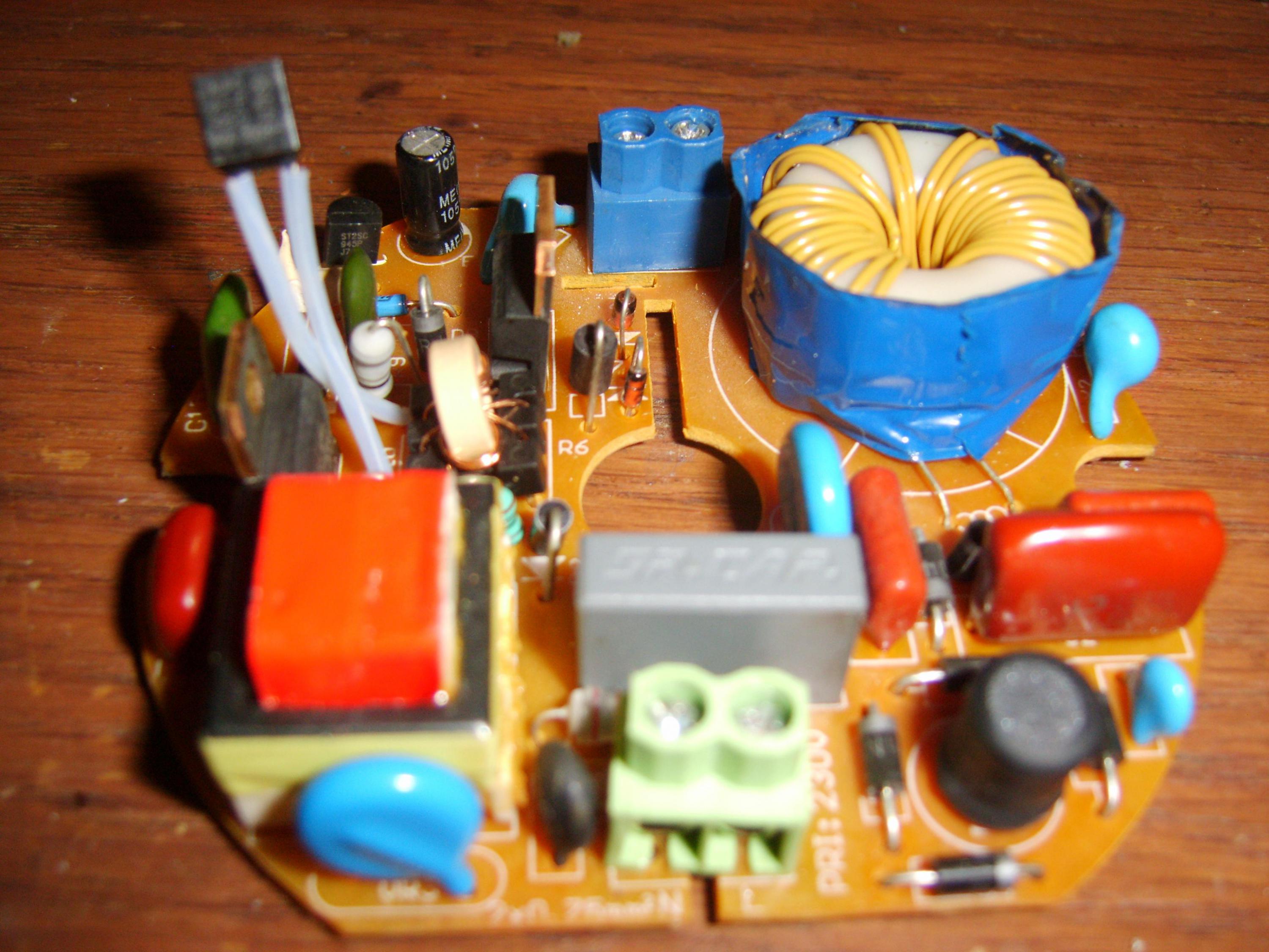

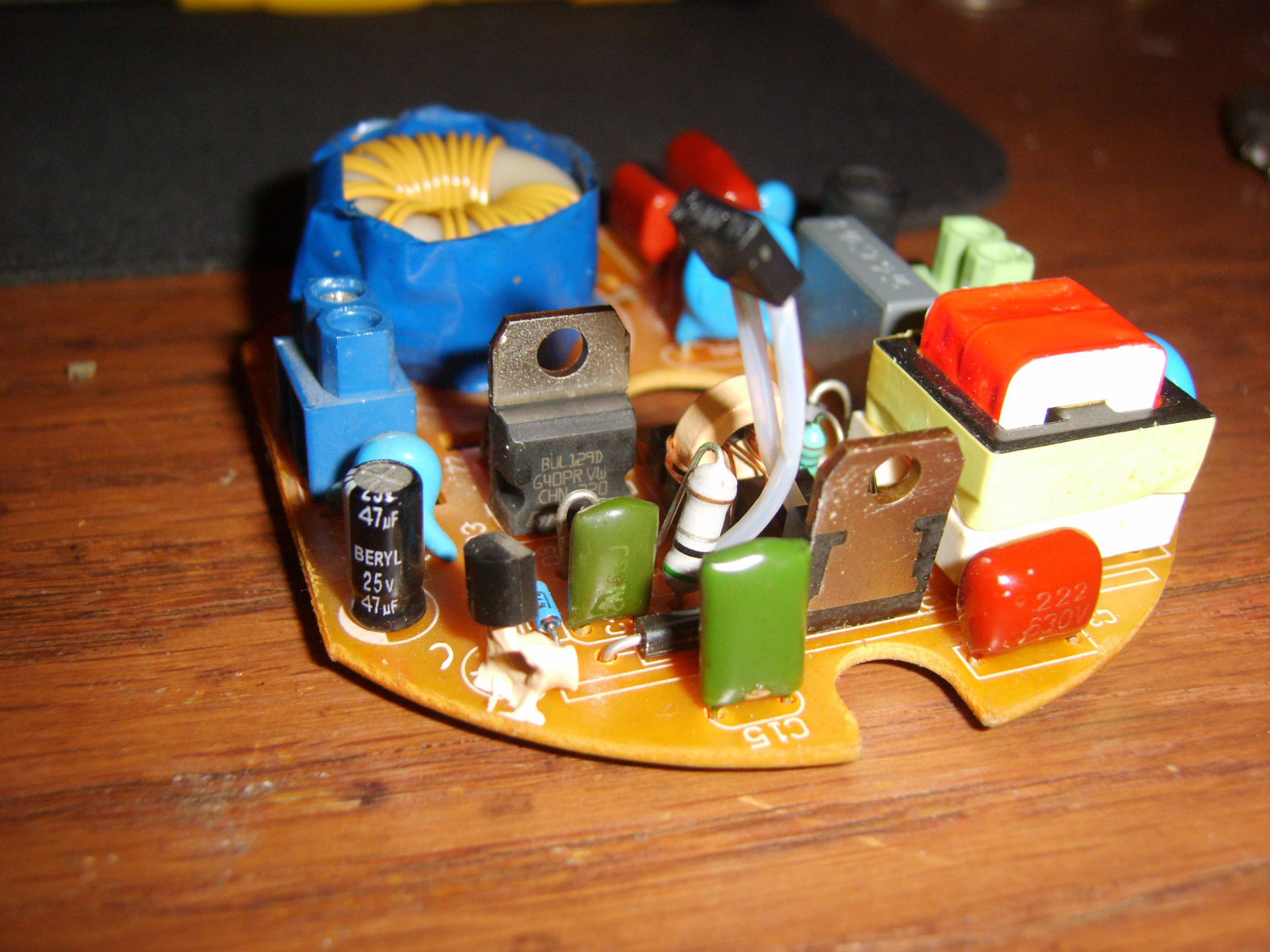

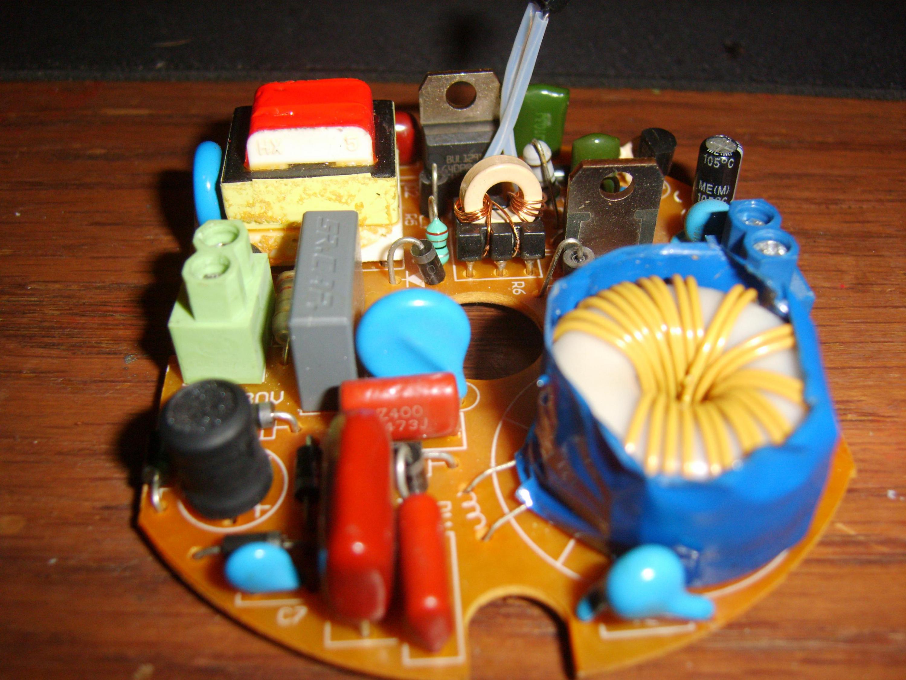

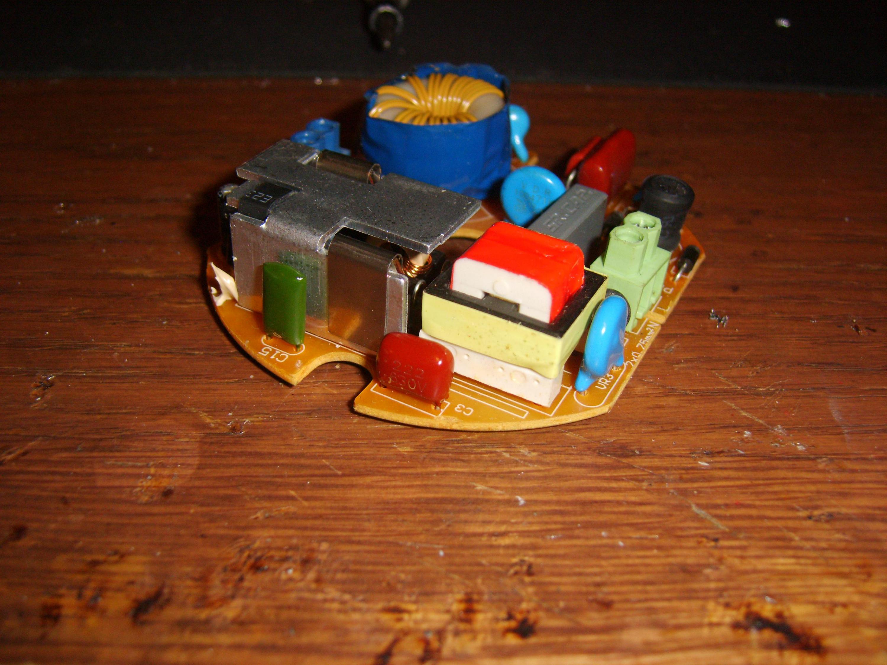

    So a few bulbs had blown a while ago in this rather expensive light fixture, I bought new bulbs (16w) and put them in all was great until later that night when it suddenly completely turned off.
    Having looked at the light again it has stickers next to each bulb socket stating 10w so i'm assuming it's just overloaded, the light has space for 6 bulbs at 10w each.
    So i'd replaced 4 bulbs with 16w ones so it was using 2x10w and 4x16w when it went off, when really it should of only had 6x10w resulting in 60w, instead it had 84w, so I can only assume this was the problem.
    Rather than bin it I thought i'd ask here if anyone can provide any help on diagnosing the faulty part, it converts the 240v to 12v.
    Haven't taken any readings from it yet as it's been removed and been replaced, i'm hoping it's just a fuse somewhere but no idea what really to look for.
    Any help is greatly appreciated.

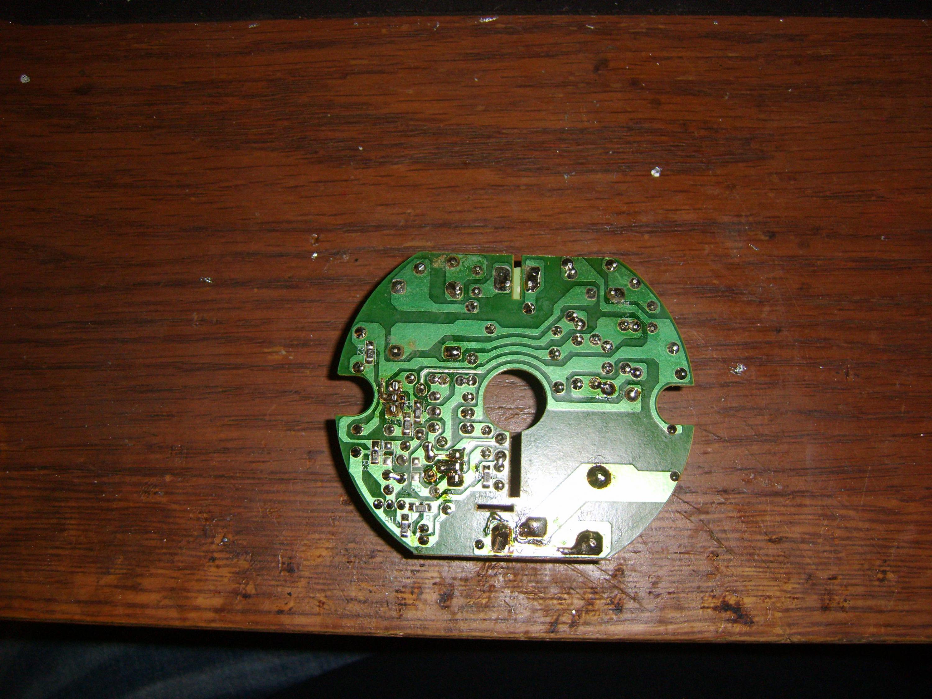

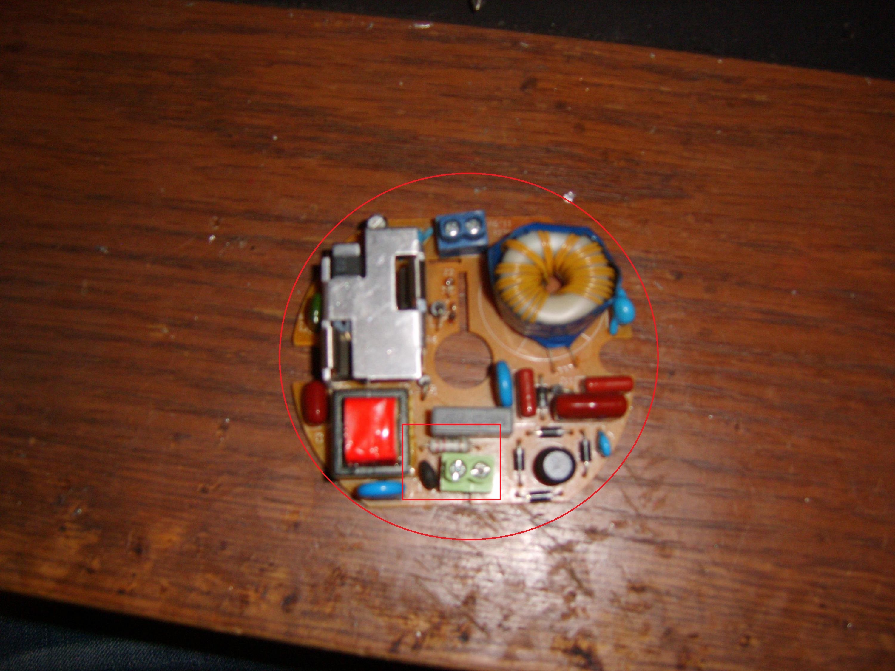

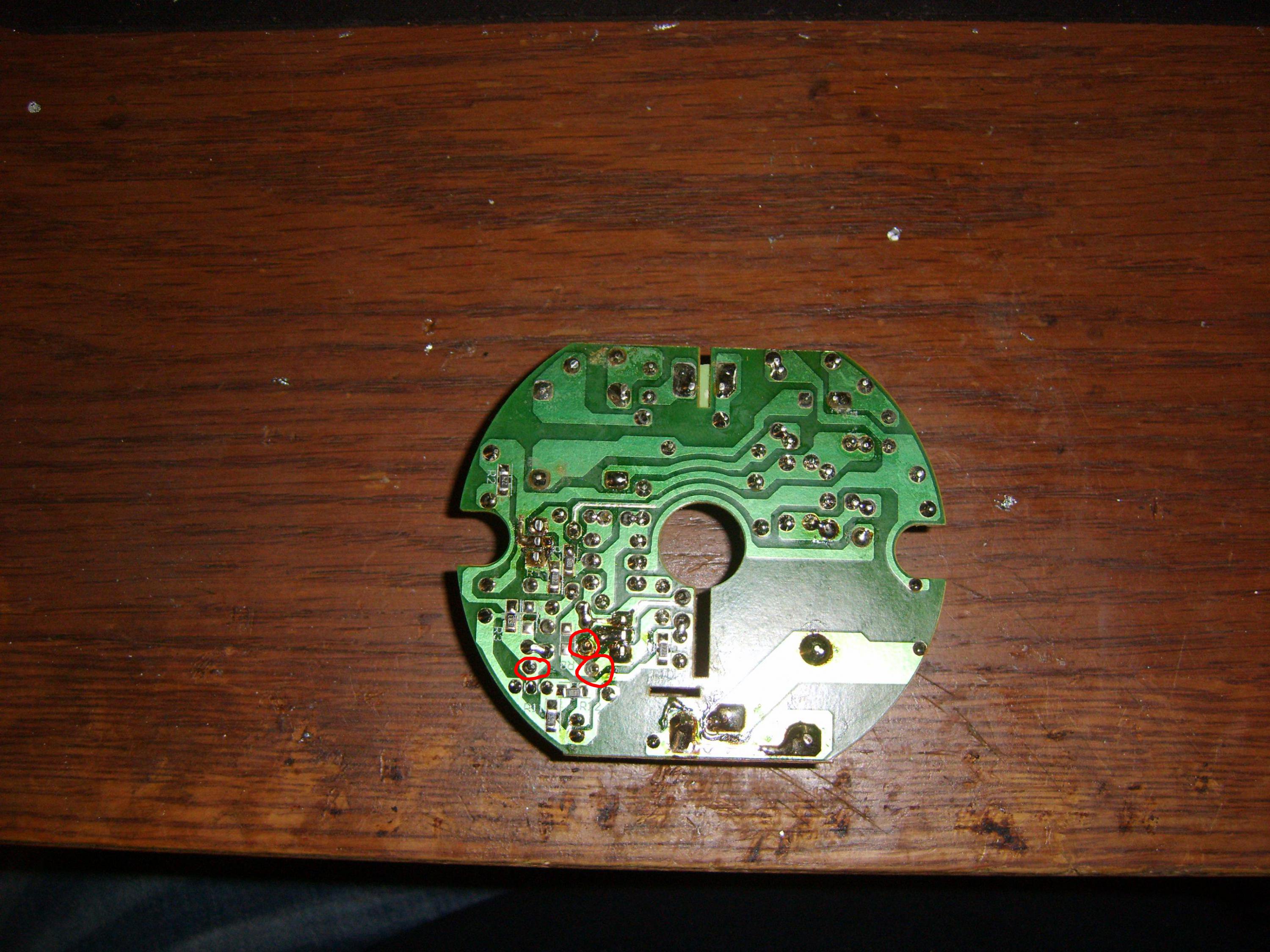

    look closely at the soldering, some joints are cracked.
      • 31068
      Re: Light Fixture UK Overloaded 240v to 12v
      without even trying - i see these.
      • anotherdude
        • Feb 2013
        • 488
        • uk
        Resoldered all points, still the same

          Why did i think you were trying to fix a fluorescent ballast?
          Im going back to bed......
          Follow the white rabbit.

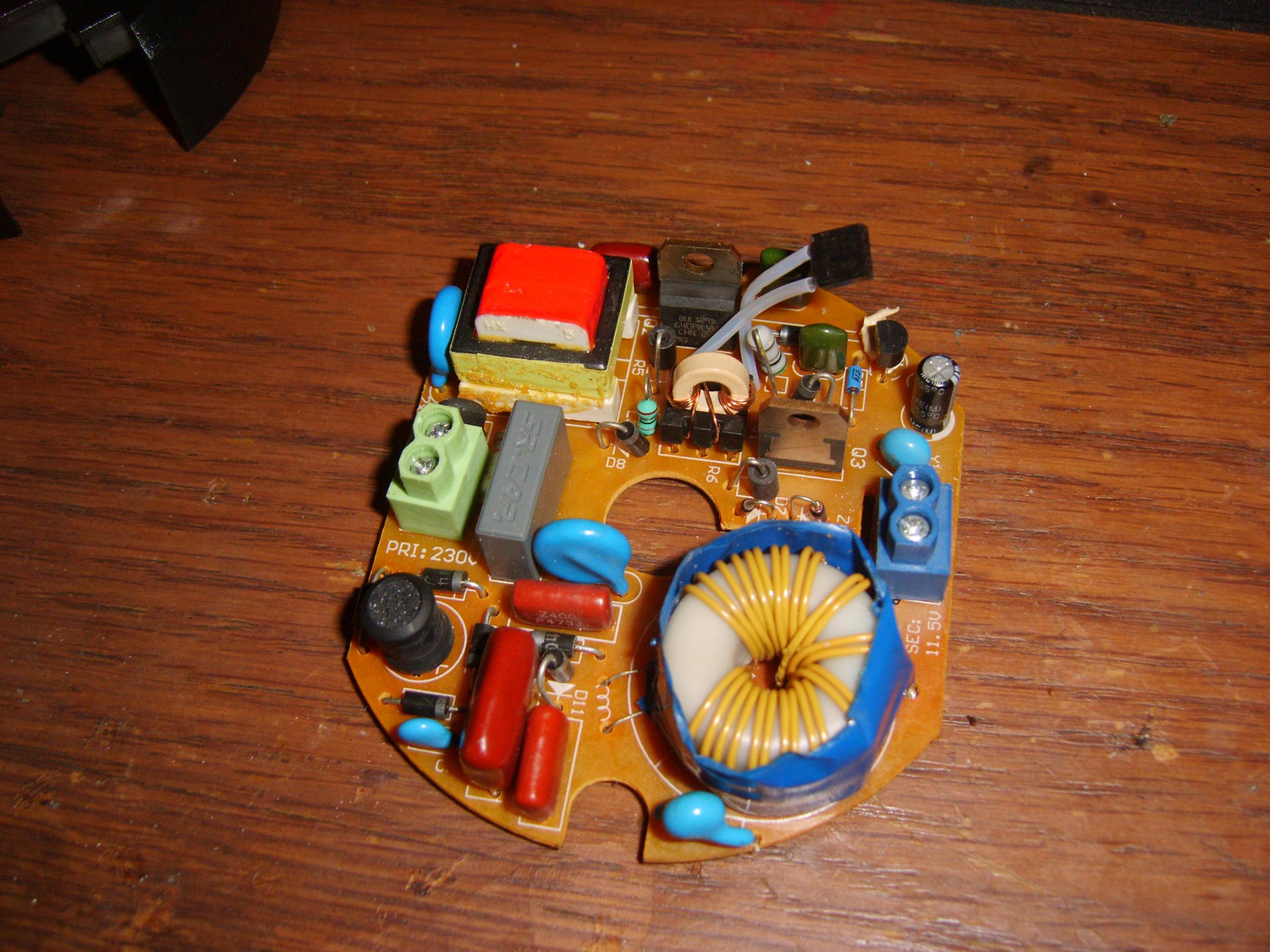

            Are the lamps Halogen 12V Lamps/ It looks like a simple 12VAC output high frequency switcher.

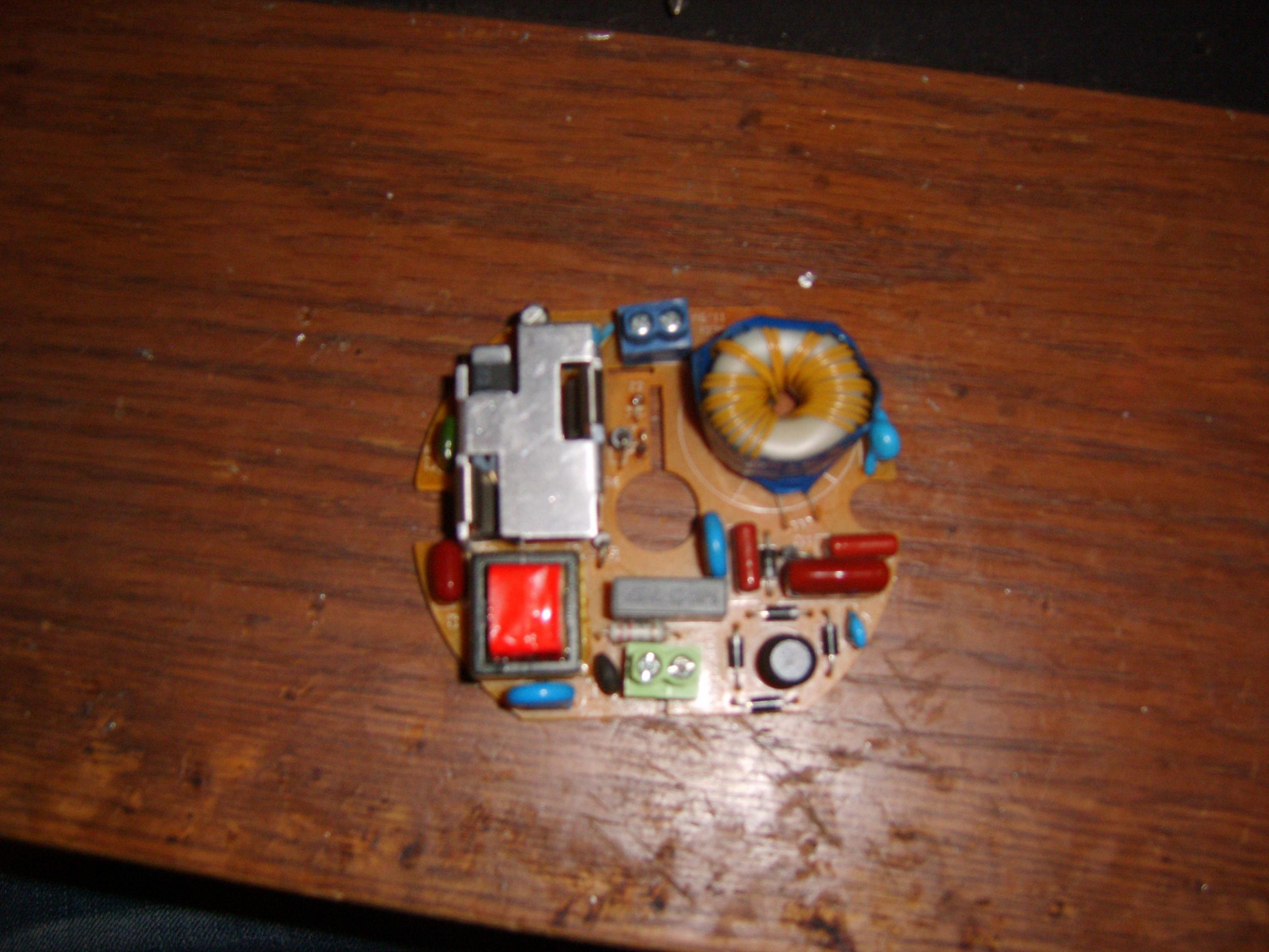

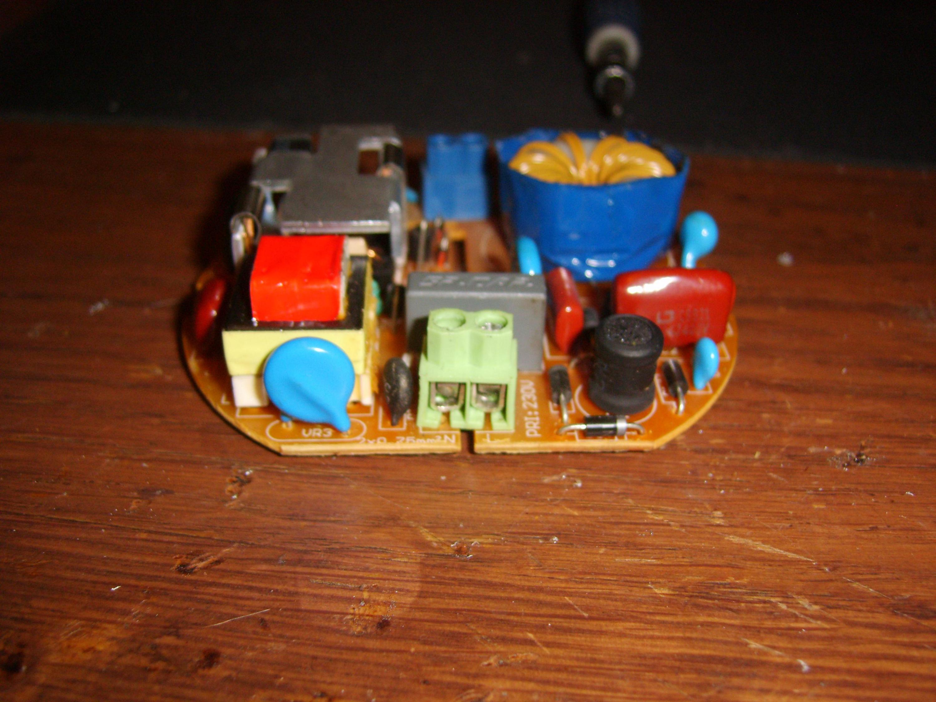

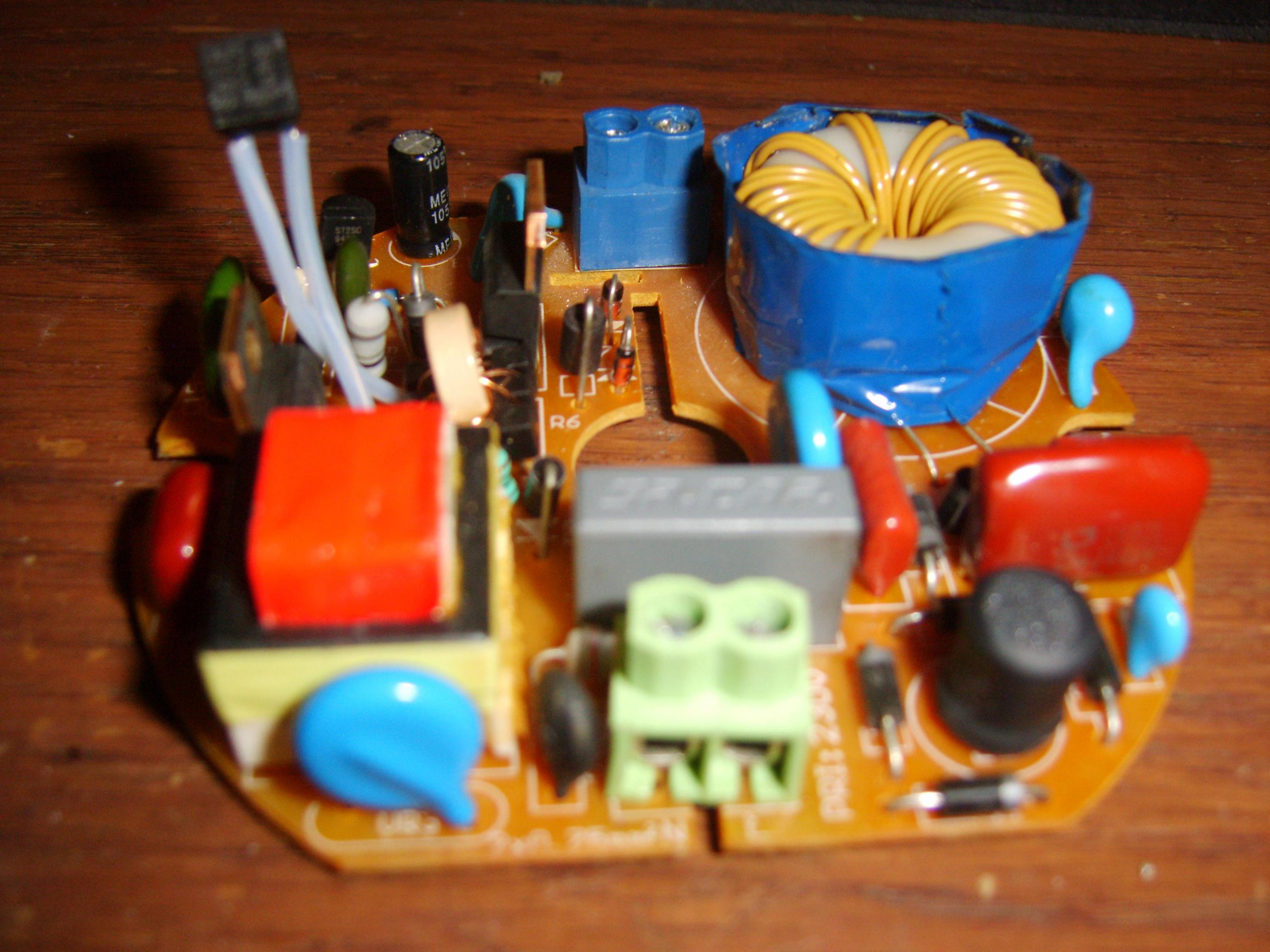

              Can you zoom in so the whole board will show without seeing the table? Make sure they are in focus also.

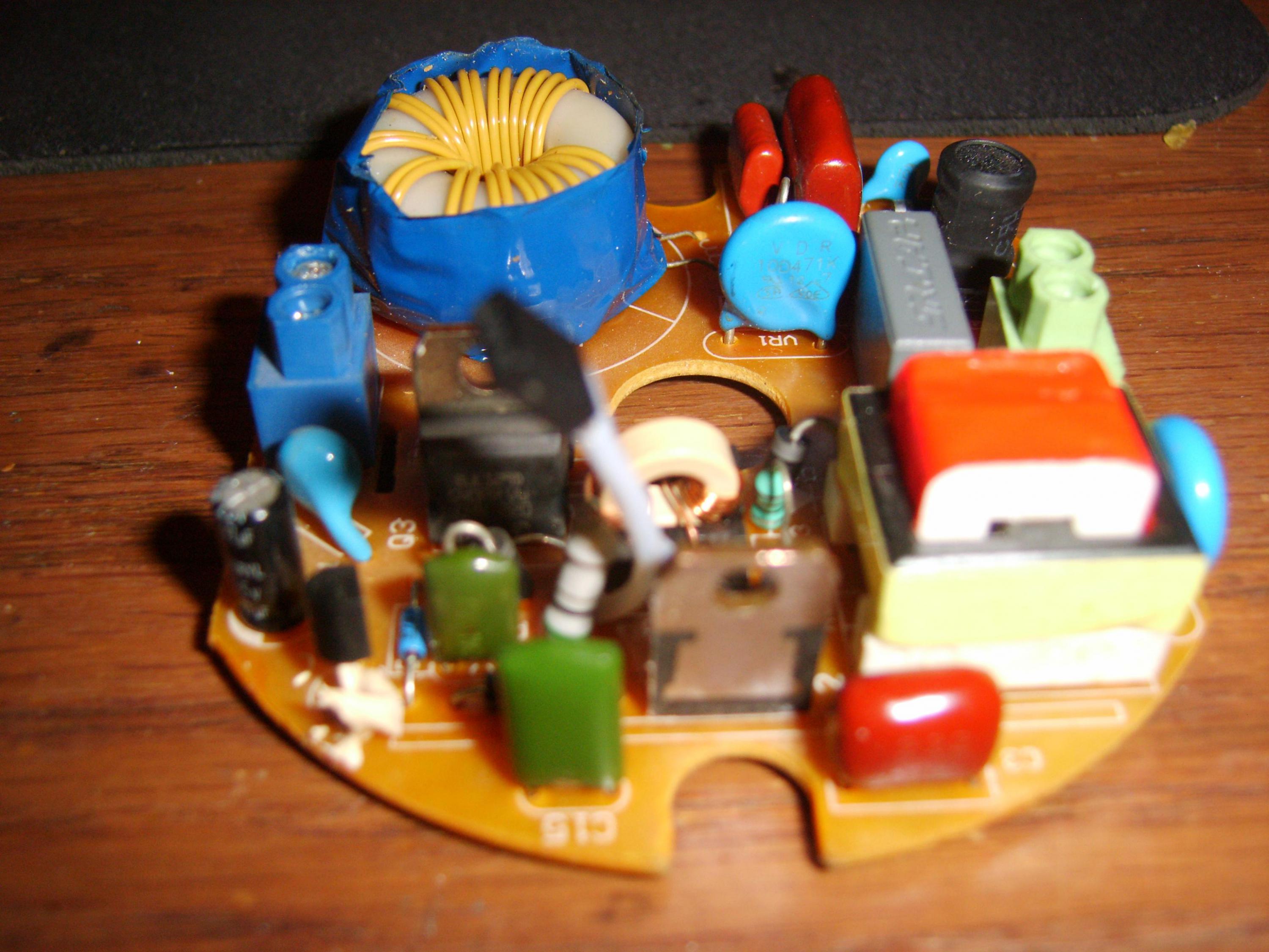

                BTW, the fusible resistor and the Thermistor are OK?
                There two power devices strapped to the heatsinks, did you check them out?

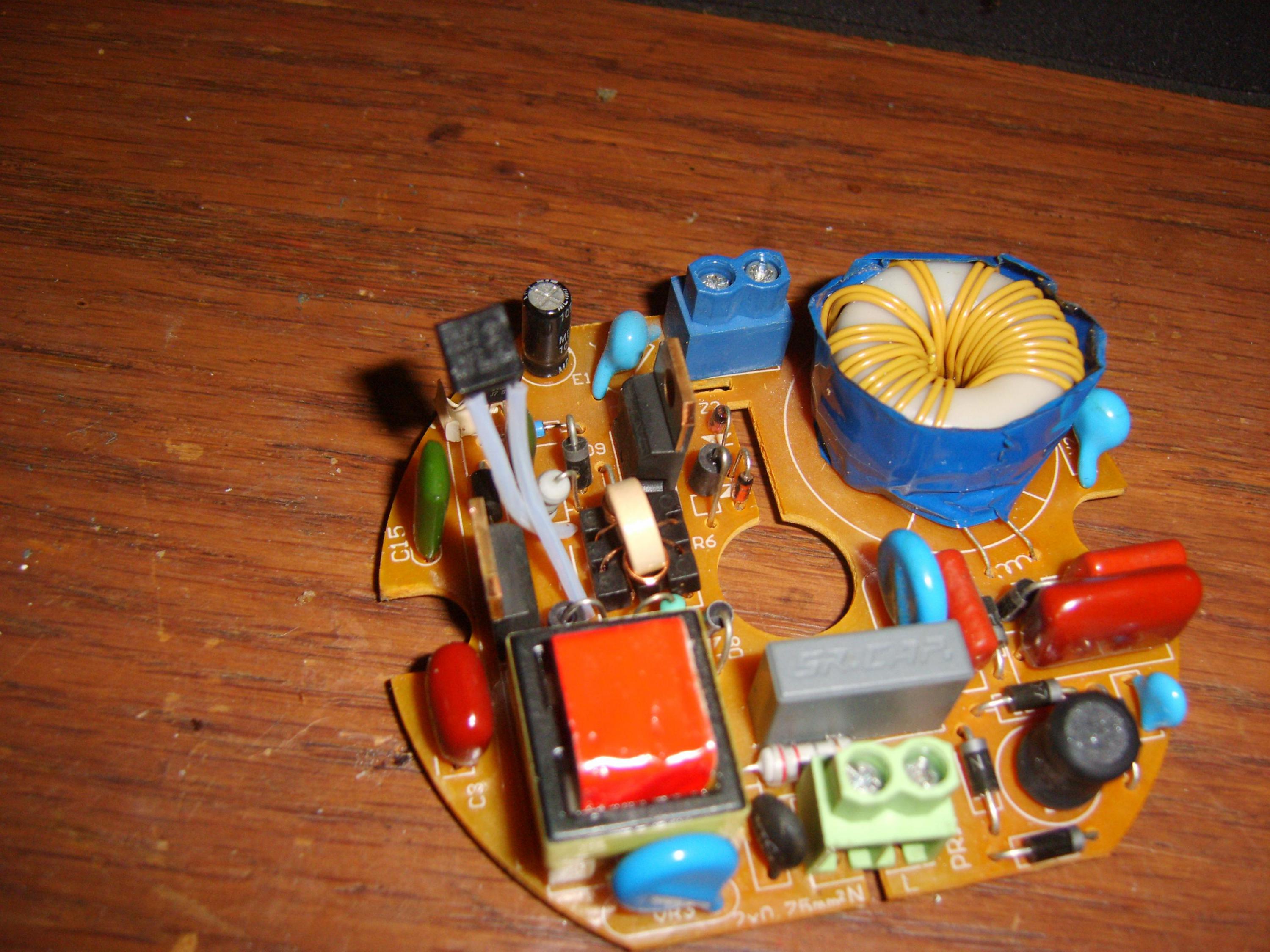

                  yep halogen 12v, will get more pictures later today

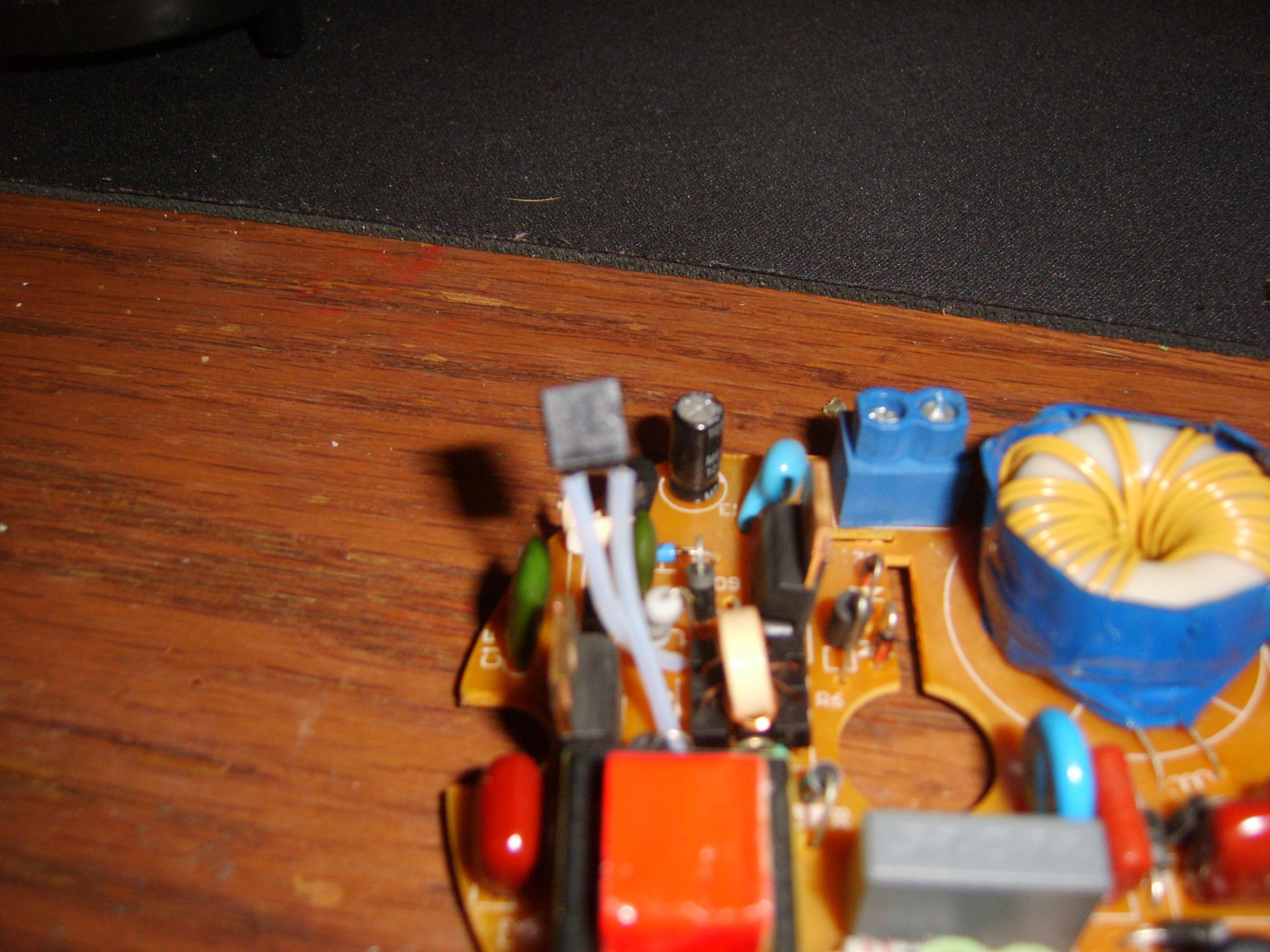

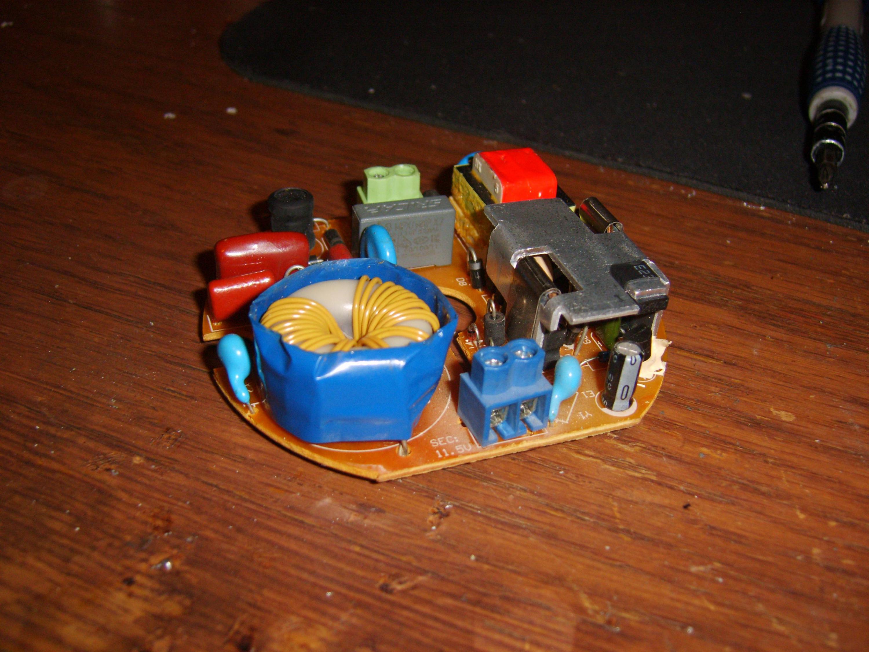

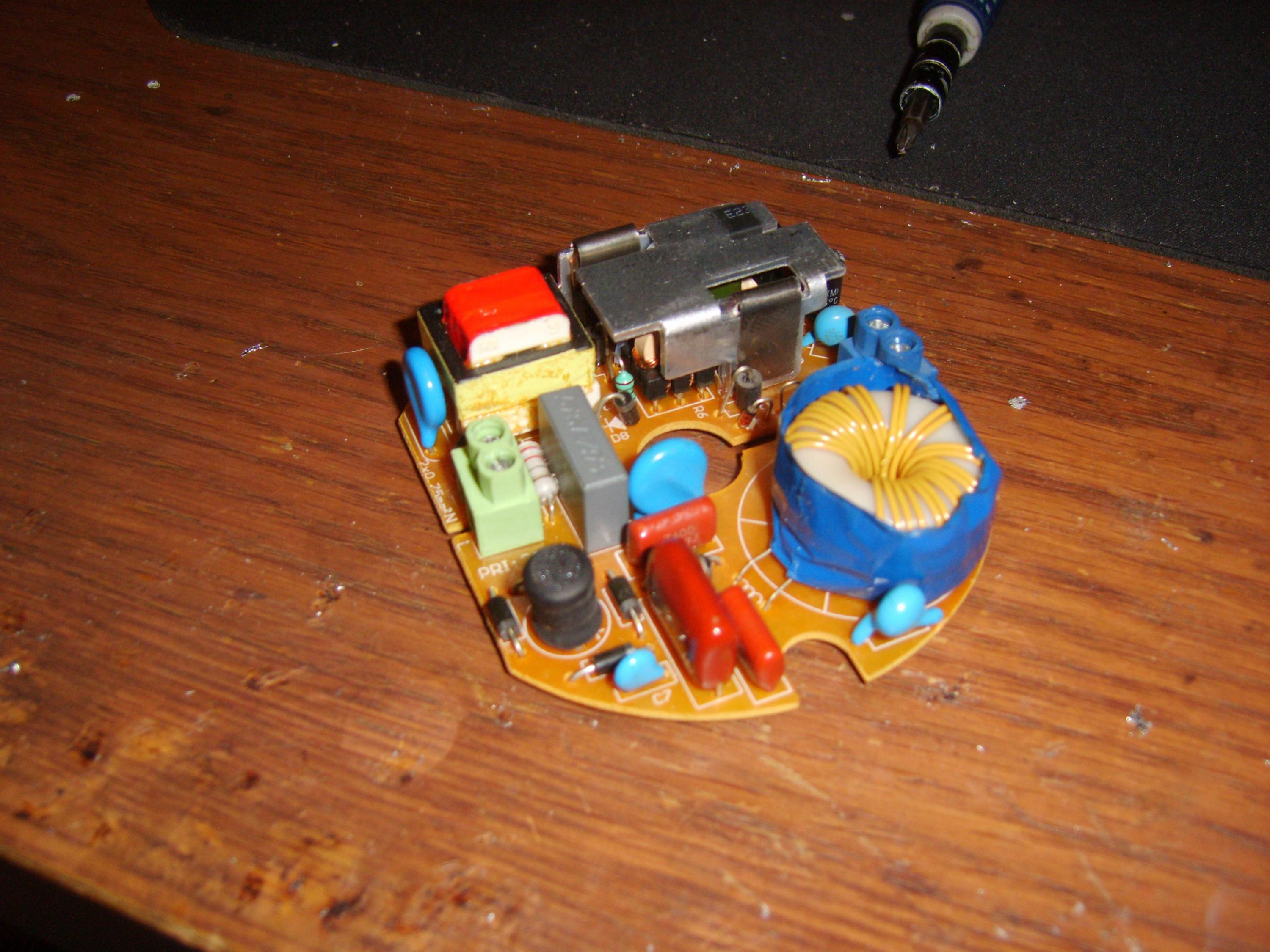

                    No visible damage, will check what you said
                    Heres more pictures best I could do
                    Fusible resistor checks out fine
                    R2 on the back of the board looks damaged looking at it again, camera is playing up will try get more
                      Probably you'll find something has gone open-circuit.
