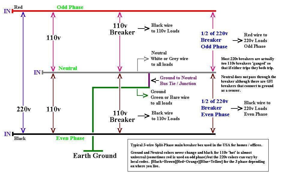

              Re: AC Ground Problem
              Here.
              This should help you 220v guys understand how we are wired over here.
              It's not single phase like there, it's called split-phase.
              Not everywhere is wired like this but it's the most common for homes or non-industrial buildings.
              Mann-Made Global Warming.
              - Dr Seuss
                Thanks Bonez nice pic wish Id have had that before
                yeah mate got that from the other long post started by pentiums pwr meter and then I had to correct the post started by KBcowboy
                Cause I shot my big mouth off without realizing you guys use a "split phase" setup
                So I miss understood his reference to red black / positive negative Active and the meaning of positive and negative generally speaking is what I got on to.
                oddly enough I did find a ref to it being using in the SWER (Single Wire Earth Retun) system here but I don't work for a power company so no real Idea if it is done in reality here
                Difference of course was 220V split phase and still one half to one house type thing so not using it as you guys do with both Actives to house.
                I think its called MENS system (Multiple Earth Neutral System) thats what we use
                Bonding the neutral and Earth together at the house mains box.

                        Our stuff is a little different
                        So just for those like me who don't know I found this on what you are talking about.
                        http://www.faqs.org/faqs/electrical-...section-5.html
                        you will find a few photos in this link about half way down the page.
                        Anyway sounds like you got it nailed to a problem with the wiring, now the hard part of finding it grrr I know what you mean, walls roofs under the floor
                        Hope its does turn out to be an easy one for you anyway.
                        Cheers
                          I understood you davmax the point of the drawing was to clarify how that happens.
                          I guess it didn't take. ???
                          If the neutral has a loose/bad connection somewhere (slight resistance) and the ground doesn't then the neutral will 1) (if there is a load on that line) show a voltage between itself and ground, and 2) (load or not) the voltage hot to neutral will be a little less than the voltage between hot and ground.
                          Focus on what happens with resistance in the return/neutral between the test point and the power box (or other earth ground) and it will make sense.
                          Some electricians here in the US also add backup grounds from various points in the distribution to a water pipe or whatever. It used to be standard but I think it's now optional. A lot of houses have plastic pipes now days. Also there is a risk of a home owner replacing a section of pipe with plastic and unknowingly removing the ground path. So, as I understand it grounds to pipes are optional but the earth ground at the box is required.
                          The earth ground at the power box may not look like much but they are actually quite big. They are typically and 8 to 10 foot copper (or copper clad) rods driven into the ground. - [Driving those buggers in is not fun. I had to do it when I added a sub-box to one of my houses.]
