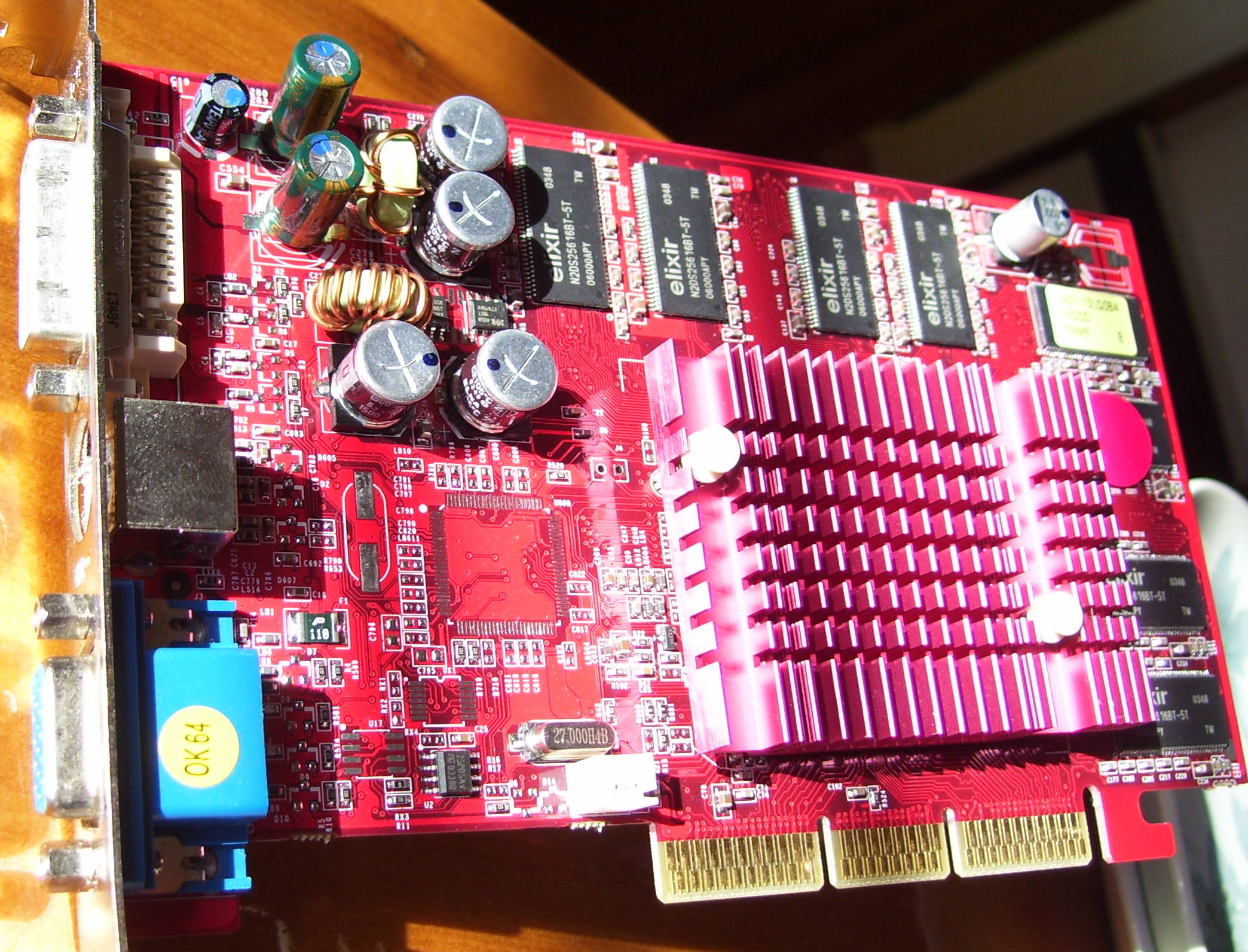

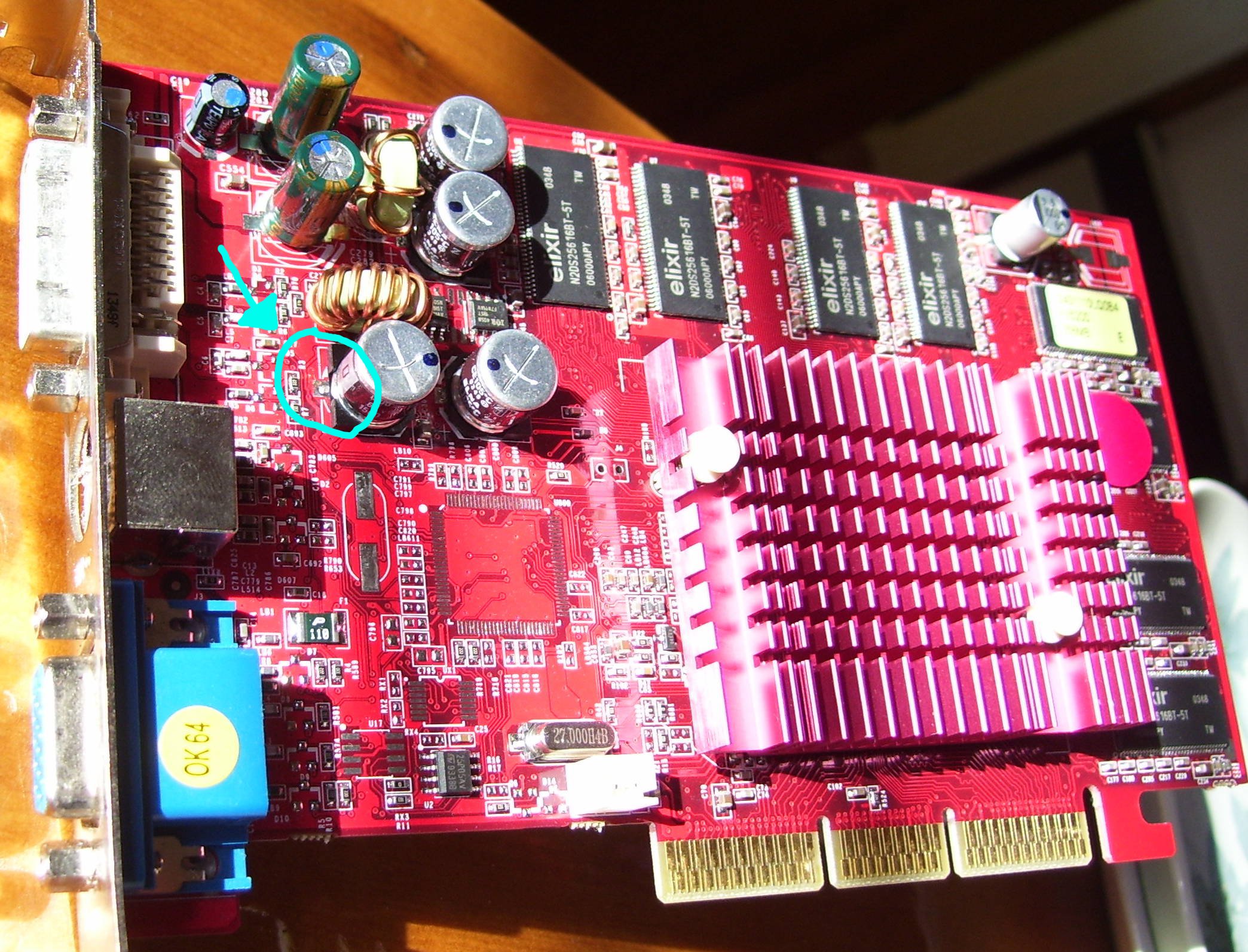

    This card now only works on VGA input.
    The DVI was working, then it sent no signal to the monitor a few times on a reboot, and now no signal.
    Am getting ready to do my first recap of a monitor, video card, and PSU and would like to order all the parts at once (including a basic ESR meter)
    The last 'component' to check out is this video card.
    What could be causing this fault?
    All the caps look good.
    4 caps are Elna 6.3v 1500uf
    2 Green ones are Teapo 10v 1000uf
    The small cap next to the DVI output is also Teapo.
    And the silver one, at the other end of the card, has no name, but has 3, 5, 1000, 6A printed on it's top
    I have another card - (nvidia 7600) which creates artifacts, on both DVI and VGA - so am reasonably sure that that chip is toasted.
    In contrast, the FX5200, has never caused any artifacts or ghosting, so, i'm thinking that the nvidia chip is probably OK.

    Re: FX5200 - no DVI signal
    one of the Elna's has leaked around the legs.

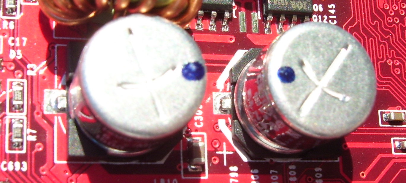

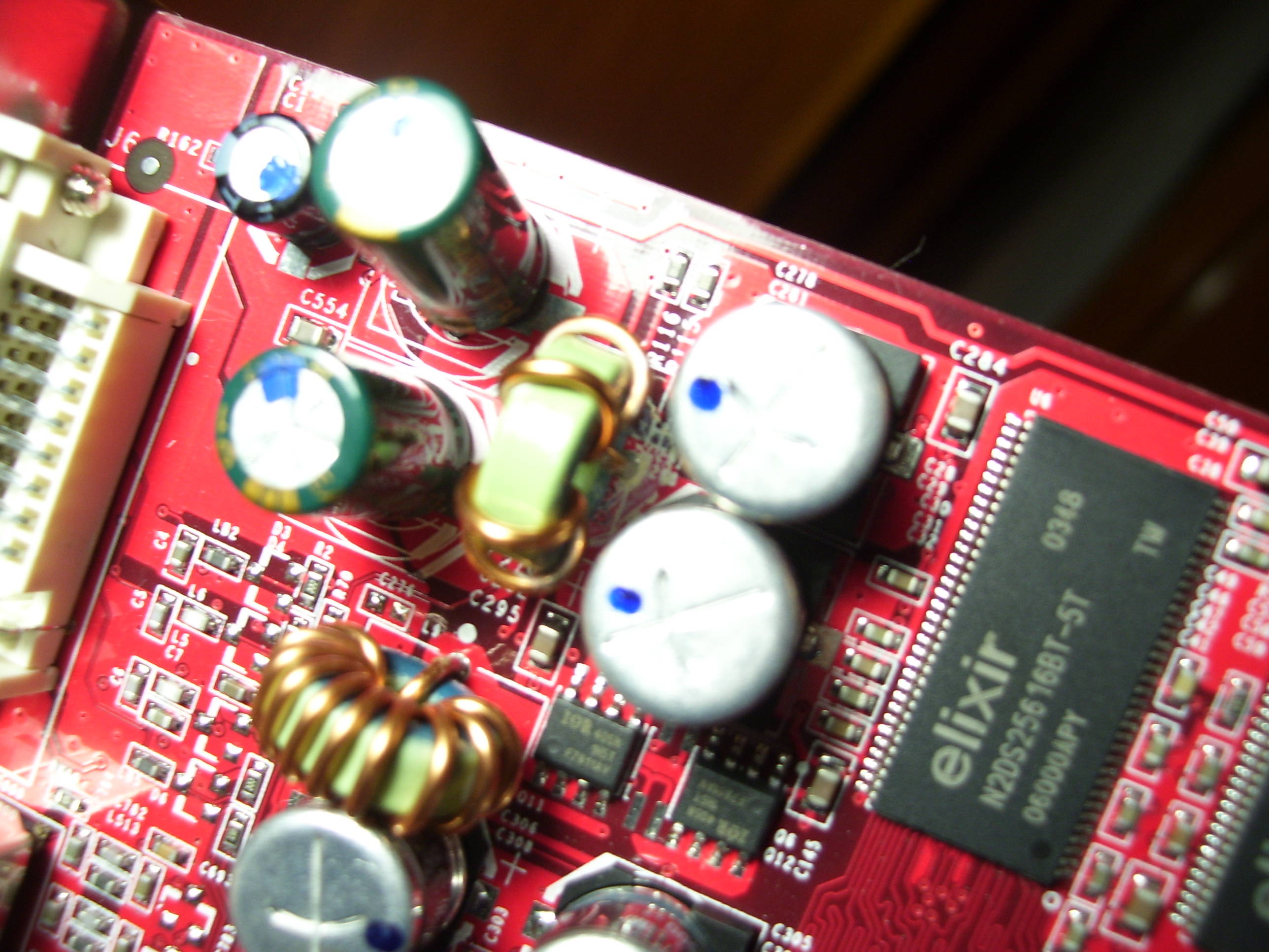

      Hi again,
      Had a good look around all 8 legs, and couldn't find any signs of leakage - they were all shiny and bright.
      Did notice whitening around the base of the 5-windings choke and a light caking on the inside of some of its windings - but it does not appear to be dry-jointed, because one leg is continuous (using continuity test) with a tiny SMD cap, (on the reverse side) and the other is continuous with a elna cap (on the topside of the board)
      What next?
        • 31131
        this ?
          Honestly can not see any sign of leakage from any of these caps, also the sides of the caps are clean with no signs of electrolyte.
          Any dark spots on the pads are due to shade.
