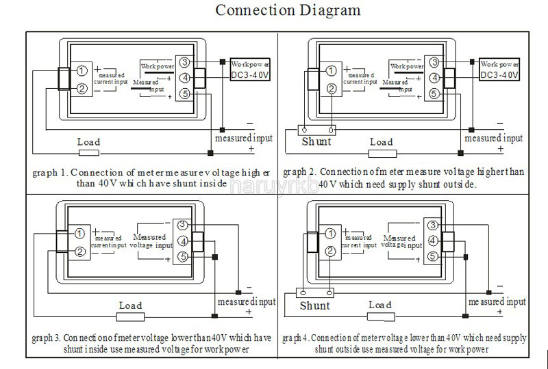

                          maybe this one using post 21 DC 0-600V 10A Voltmeter Ammeter LCD Panel Amp Digital Volt Gauge meter 12V/24V [ D85-3051]
                          http://www.ebay.com/itm/DC-0-600V-20...-/281631696703
                            #33
                            Re: “How to test LED screen?”
                            If that is the one then the max measured Voltage is only 40V per graph 3, and the current mode return is connected to power supply - which is circuit GND of the SAMSUNG POWER supply board.
                            He also need to watch out where the meter is inserted into the circuit to measure the current.
