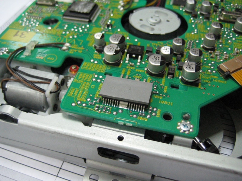

    Does anyone know what the grey, rubber-like thermal pad material is called? I need some rather big pieces for a Crown amplifier, probably about 3x12 inches.

    Re: Thermal pads
    Do you mean Gap Pads?

        Re: Thermal pads
        I had that rather thick, soft stuff in mind...often found in CD/DVD drives between bridge chips and the metal case...or on VGA cards between HS and RAM chips.
        On the other hand, there are silicone pads. They're thin and rather rigid (often reinforced with fiberglass)

            Re: Thermal pads
            [QUOTE=kikkoman]I had that rather thick, soft stuff in mind...often found in CD/DVD drives between bridge chips and the metal case.../QUOTE]
            Yes, the stuff used in CDROM drives is the same thing... that is what I'm looking for.

                    Re: Thermal pads
                    Well... we called it Radiation Rubber Sheet. Some japanese called it "cooling rubber". The one I use in my design is from INOAC co. The product name is MasaSheet.

                              Re: Thermal pads
                              the sil-pads are a whole different thing.... they're much thinner and intended for use between e.g. a transistor and a heatsink. They need PRESSURE, and often come in pre-cut sizes for various cases.
                              The Gap Pads however just provide extra thermal relief, for instance between the PCB and the metal case, but not for the high-power parts. That's why they're called Gap Pads.

                                Re: Thermal pads
                                I think those Sil-pads are, what Maxxarcade initially was talking about.
                                Personally i rather prefer mica, as they are profen reliable isolators.
                                And i think adding thermal grease isn`t that hard for a non production working environment.

                                    Re: Thermal pads
                                    The ones I needed were the Sil-pads. I got some originals directly from Crown Audio for about $3.00 each. Thanks everyone for the help!
