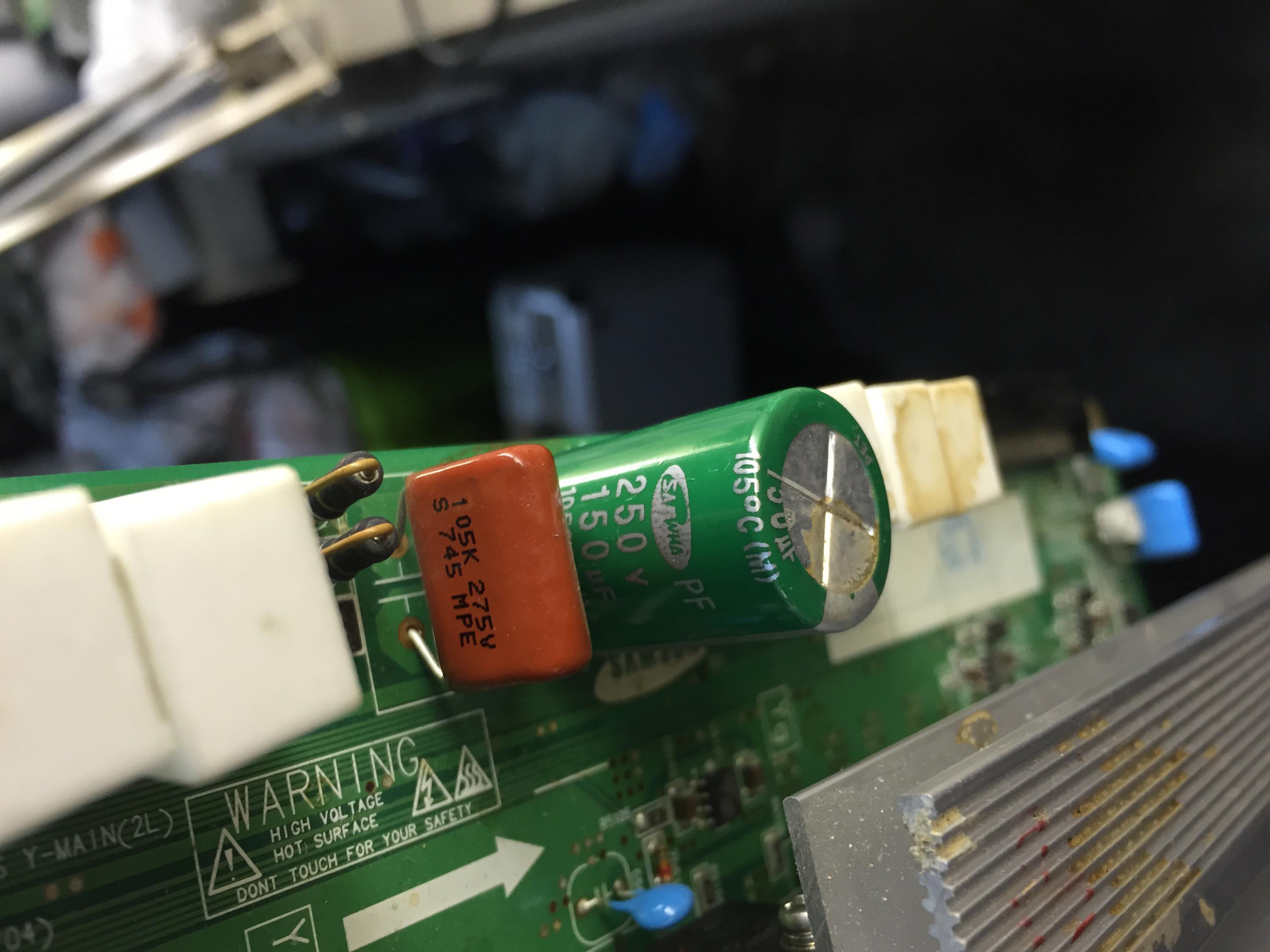

    105k 275v film cap
    I am looking for a replacement part for this cap not sure what uf rating is.If any one knows a good part number.Here is a pic of the cap it is on y-main of the model hpt-5054.
  • selldoor
    Slow Learner
    • Dec 2010
    • 7870
    Re: 105k 275v film cap
    Perhaps one of these
    http://www.digikey.com/product-detai...540-ND/2117919
    105 =1UF K is the tolerance code 275v is the voltage but 275v is not common so suggest
    go 400v- dont think it really matters.
    Need to check if it will fit
    • selldoor
      Slow Learner
      • Dec 2010
      • 7870
      275v seems common in the yellow box types just google 1uf 275v
      • ricosavy
        • Jul 2012
        • 457
        • united states
        Thanks see some ebay yellow box
