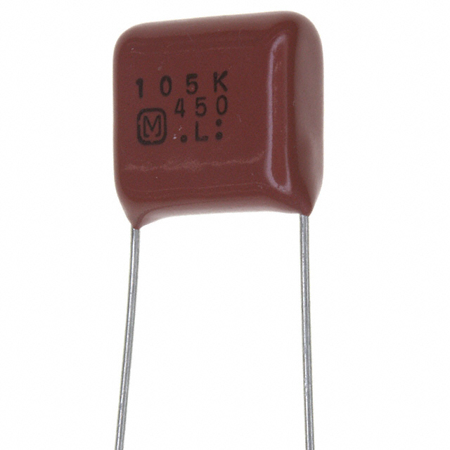

    Which voltage is this 1uF Matsushita film capacitor?
    I am having difficulties finding which voltage is this Matsushita 1uF film capacitor. Cannot find any reference online.
    It looks to be an old serie.
    Link:
    https://i.ibb.co/qFt7hPZ/WHICH.jpg

    Re: Which voltage is this 1uF Matsushita film capacitor?
    Panasonic has only two lines of film capacitors, PP and polyester.
    I think you'd have to check part's size, there's no info on marking codes.
    105=1uF, K=±10% and "CDI" might mean capacitive discharge ignition duty. Is it from an igniter?
    An ECQ series pic shows the voltage there.
    I'd guess 250VDC from the size.
      No, the mark is not "CDI" but "CDT".
      I would like to use this one in a valve amplifier as it measures perfectly without any loss and the leads are very long but the voltage is not clear.
      It matches the size of a 0,22uF/250V Philips MKT but it is smaller than any 1uF/250V film capacitor I ever encountered.
      It'd be great if it was 250V.
