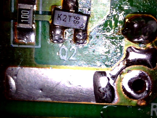

    Hi Guys,
    I am looking for info/ availability for a smd transistor marked K2T ,with the marking "S" or "8" and 6. I attach a pic of the transistor. It is from a SMPSU used on a Proscan 32LA30Q, Board no :SBGD-200-3HP
    Any help in this regard will be highly appreciated, even a replacement part number will do.

    Re: Looking for info on Transistor
    mmbt4403
      Wow!!!! Thank you so much STJ, I really appreciate the fast feedback, hopefully now I will be able to get this bloody supply repaired!!!!
