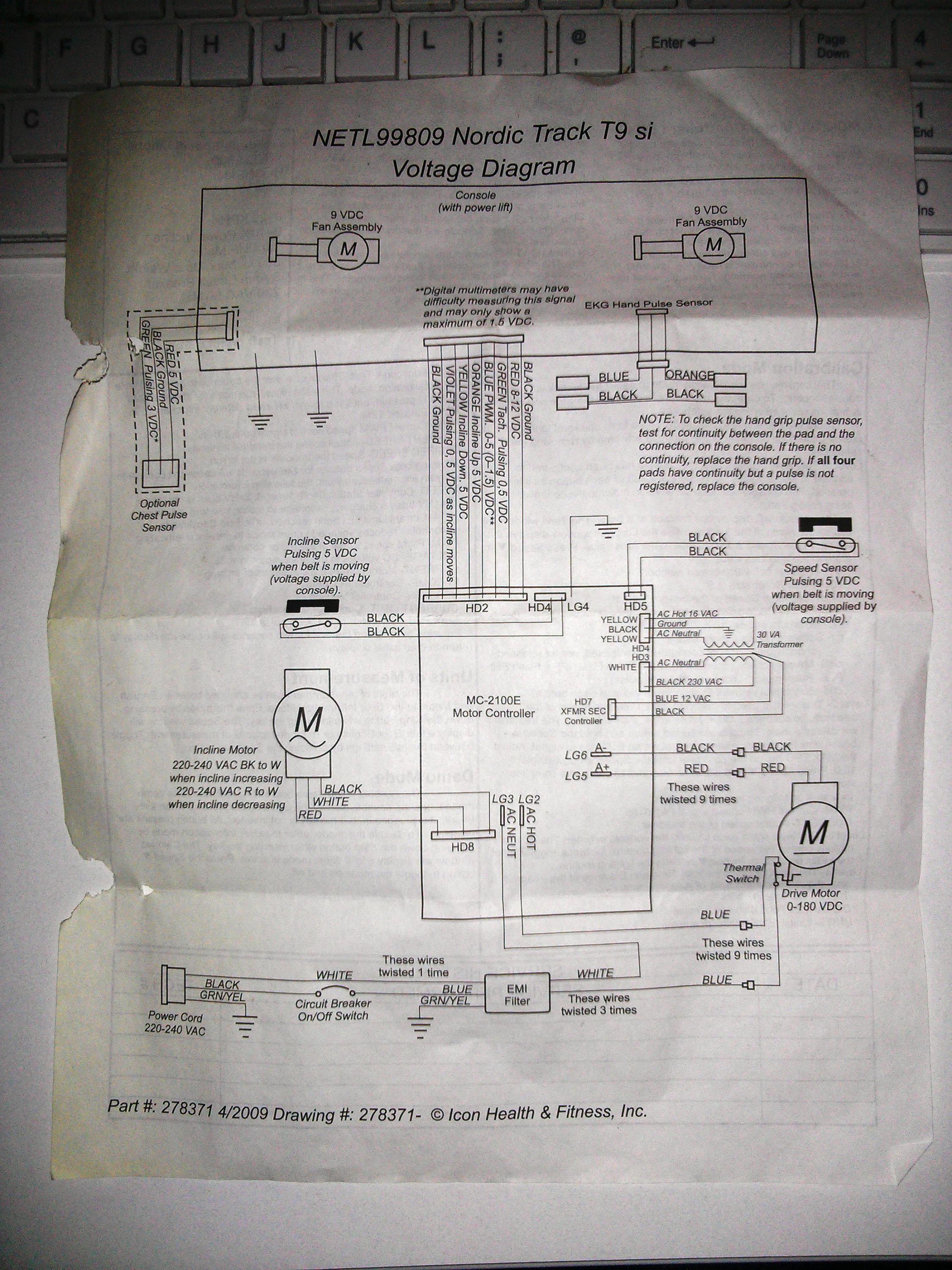

          Does anyone here have a schematic on a " MC2100LTS-50W REV50"?
          Kinda need the values on some of the resistors that i cant see the color bands.
          this board came out of Nordictrack commercial threadmill.
          Thanks..
