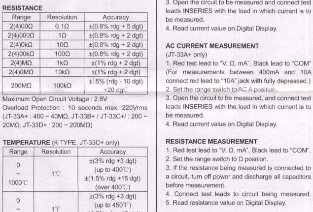

              • themadcapper
                • Oct 2007
                • 7
                Re: help with difference between ESR, LCR, and impedance meters
                I just got specs to a "Digital LCR MultiMeter Inductance Meter Tester". Understanding correctly it seems to be able to check resistance at .1ohm resolution, but the lowest ohm reading seems to be in the 2(4)00 ohm range. So I guess that's the real difference, is that an ESR meter can measure under an OHM whereas most multimeters are measuring MUCH MUCH higher ohm levels. Feel free to correct me if I'm wrong in this understanding.
