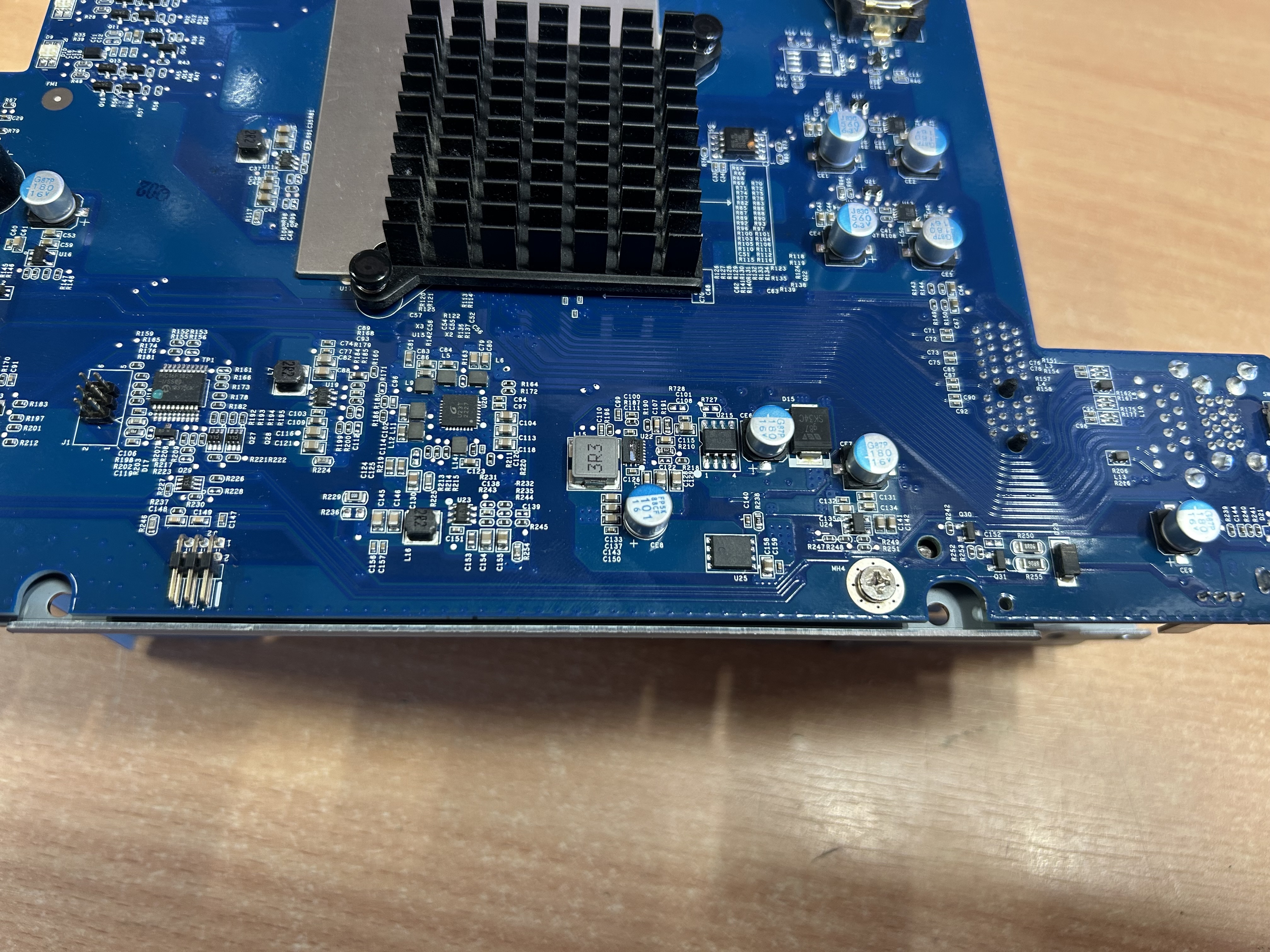

    Hi everyone,
    This morning I noticed my Synology nas doesn’t turn on, opened it up and saw this component in a rather bad state next to 3R3 inductor, there are some shorts further down but maybe it’s this part. I need some help with identifying and trying to replace it, if it’s possible to find it

    What are the markings on U215? Maybe its datasheet will give us a clue.

      Is that a QFN that only has pads on 3 of the 4 sides?
      I wonder if you can find the piece that blew off, it may still have the part number on it...

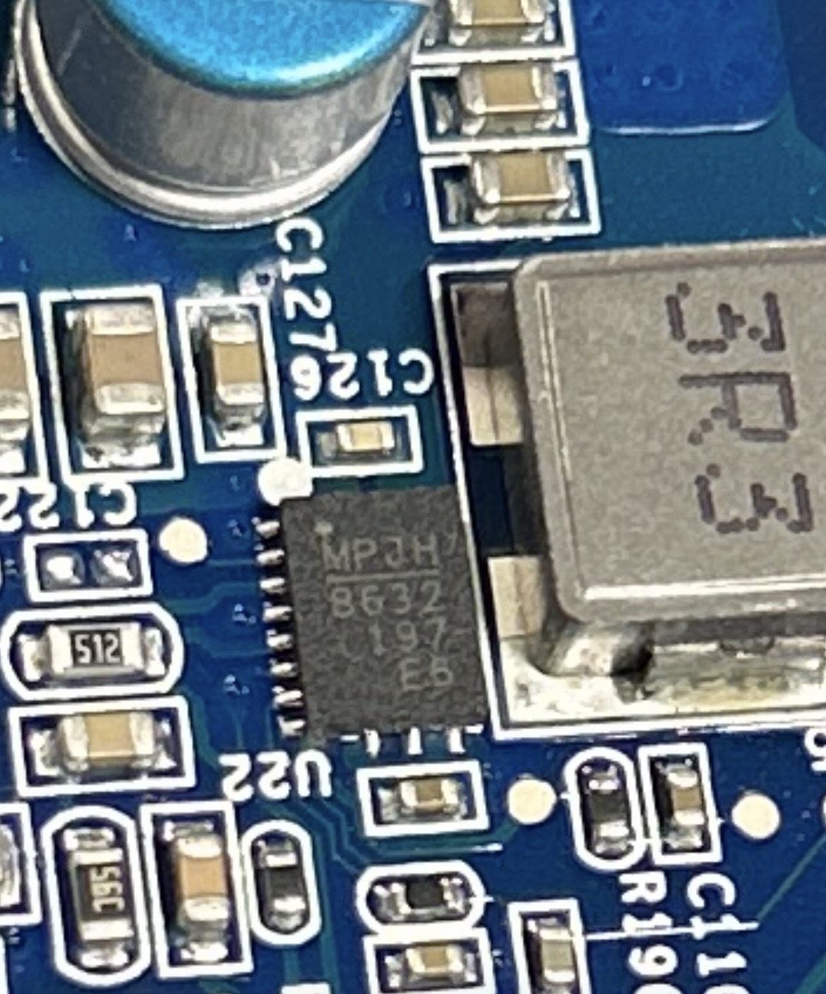

        I found a second device to look it up, part says MPJH 8632 197 E6, sadly no luck finding this part anywhere. Any help would be appreciated thanks

          Monolithic Power MPQ8632

            How interesting, I have not seen an IC with this package style before
