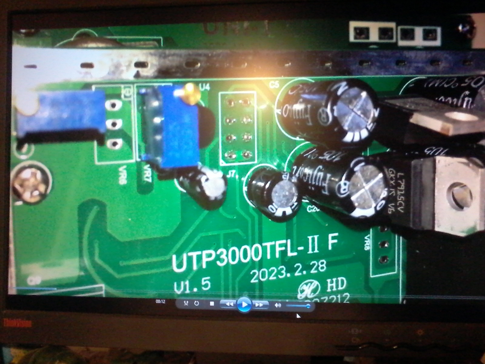

    I have UNI-T UTP3315TFL (2025 model) and just want to measure some zenner diodes directly with it. Set it to 12v and 7mA and connect BZX85C9V1 to it... shown on display 8.91v at 7mA... that seem fine to me. But, I guess I have in box a larger zener, let set it up to 16v, same current. Relay inside clicking to bigger range over 15v. When I test the sameone zenner accross probe, it clicks back to lower range, but displayed about 0v. The zenner was samehow killed by switching winding on 7mA limit... It was a 1W zenner, and can take up much higher voltage and current, so what is hapened realy, am I invent new psu quality test, or do some fullish thing?

      I am not get it... the switching between taps is done before rectifier, and not interference with setted current limmit. If it generate a high voltage spike by induction, there is much control electronic on the way before get to the output. I am a bit worry, because, if it connected to some circuit (that has to be repaired) and start to switching between taps for any reason, it can silently kill protection diodes in mosfets, ICs, makeing them shorted........................... I like to hear from different users and psu (linear) model, if they can perform above zener test and worrylessly swipe a full voltage range at fixed 5mA limit with no damage a diode, to dismmiss a possibiility to only one issue with my model/these model from UNI-T?

          I just kill another 9v1 zenner at 5mA, that say, it is repetable indeed. I have no digital scope so I can do only a yt review, capture execution on video clip... so guys be aware of that. I think it is only issue specificaly with zenner and zener properties to conduct at some point and too slow regulation (or too fast letting go) that control current. When it switch to lower tap, current limit is fast release in gap while induction surge hit zenner and slowly initiate again when is diode yet damaged........................ This topic is for someone who has needed equipment (on mind eevblog), I beleave that is no likely manifest in real circuit... but... not happy at all...

              The initial idea was to use psu as measure device, not only as power source. The whole purpose of haveing a current limit is to prevent damaging circuit, and I use and explore that option... if the current realy stay at 5mA level all the time I dont think that while switching taps there can be enough surge power to damage 1w diode........................... So function of CC is no acomplish his task for fine electronic, I see that on that way...

                    I go with extend testing and kill some regular LED diode at "5mA". Now I can conclude, it is not issue about switching between taps and induction, but inertion of regulation circuit to do real "constant" current. I tested in first range on 7.6v (without switching occure), and noticed that led initialy briefly flash much stronger that can on 5mA. Then I set it to 10v, and visualy is the same even switching occure. LED stay undamaged. Then I setup to 30v, and led instant die after initial flash...................... as many as I watch lab psu review, in all is pay attention to not overshoot in voltage while switching taps, but never seen a measurement of overshoot in current... what is consider good, normal, poor I dont know...

                                "and forget about the current limit on the PSU."... and for me that is the only point of haveing lab psu in use........................... Have someone schematics of that psu UNI-T UTP3315TFL, I have noticed that they did a improvement in meantime by ommitting vr6 and vr8 in 2025 selling model... and flip over top to220 element... How hard can be that do a propper CC function, I dont think thay pay any attention at all for startup detail in firstplace... so perhaps it can be easely fix?

                                    Yes I read eevblog link, and see there is the same issue even with branded psu. Everything point to electrolitic capacitor on output, so that seems for that ammount of energy isnt controlled... ridiculus... for my perspective it is a mayor flaw in design, and wonder how and why that problem isnt yet consider by (analog) psu designer, even on cheaper one psu... Now I have to worry if my psu has silently destroy some components while "repairing" something.................................. Everything starts with try to test zenner, but now it really isnt it, it is about psu, has he deliver what supposed to do all the time, partialy or just in some condition...
