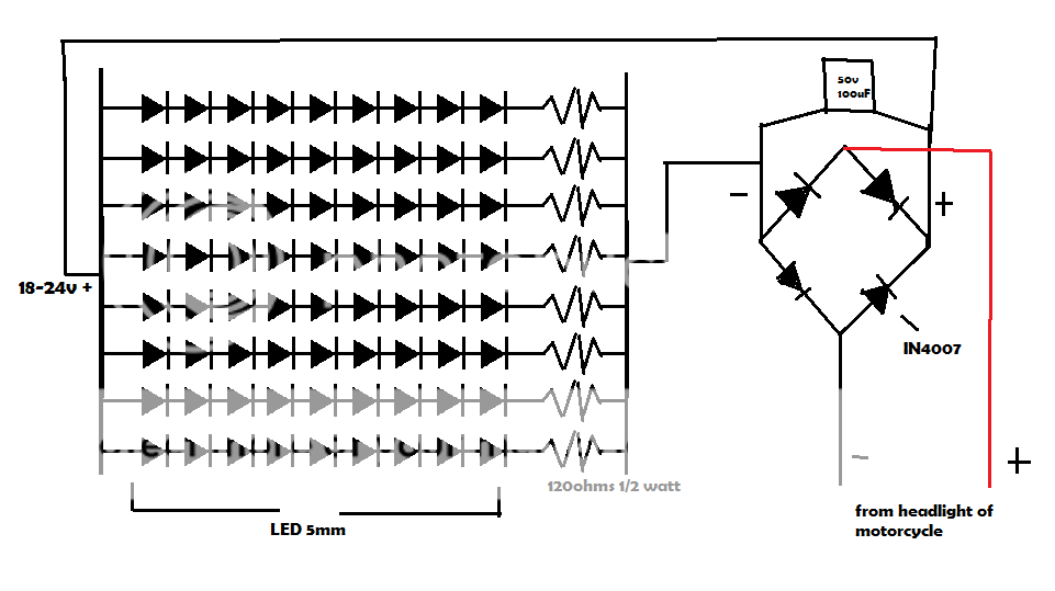

LED Headlight for Motorcycle
  • boyrekta
    • Aug 2014
    • 23
    • Philippines
    LED Headlight for Motorcycle
    Hi Guys,
    I saw a diagram of a LED Headlight for a Motorcycle. So I tried following it's instructions.
    I've used these:
    72 pcs 5mm LEDs
    120 ohms 1/2 watt 12 pcs
    also created a rectifier to convert the AC to DC:
    50v 100uF Cap
    4pcs IN4007 diodes
    so here is the diagram: ( sorry I just did it in mspaint )
    The lights are so bright and I tested them on standby for 2-3 minutes.
    The problem is the resistors heats up that you can't touch them. I'm worried if I use my bike that these resistors might burn.
    Can you please tell me what resistor should I use or what are other options I can do? Thanks!
    Last edited by boyrekta; 09-03-2014, 02:15 AM.
  • smeezekitty
    • Aug 2009
    • 32
    Re: LED Headlight for Motorcycle
    What kind of LEDs?
    Measure the voltage drop across the resistor.
    I would also measure the current going to each string to make
    sure it is within the LED's spec (although you can calculate this from
    the voltage drop)
    • SteveNielsen
      Retired Tech
      • Jun 2012
      • 2327
      Re: LED Headlight for Motorcycle
      "I saw a diagram of a LED Headlight for a Motorcycle. So I tried following it's instructions."
      It might help if we coud see that diagram and instructions.
      • boyrekta
        • Aug 2014
        • 23
        • Philippines
        Re: LED Headlight for Motorcycle
        Originally posted by smeezekitty
        What kind of LEDs?
        Measure the voltage drop across the resistor.
        I would also measure the current going to each string to make
        sure it is within the LED's spec (although you can calculate this from
        the voltage drop)
        hi thanks for the reply!
        they are 3v to 3.3v LEDs
        drop is 4.2v
        unfortunately I don't have a tool to measure the current, my tester is crappy
        • boyrekta
          • Aug 2014
          • 23
          • Philippines
          Re: LED Headlight for Motorcycle
          Originally posted by SteveNielsen
          "I saw a diagram of a LED Headlight for a Motorcycle. So I tried following it's instructions."
          It might help if we coud see that diagram and instructions.
          Thanks for the reply!
          here is the original diagram, i did not include the 3 big LEDs though, they are not available from our stores here
          Last edited by boyrekta; 09-03-2014, 07:35 PM.
          • boyrekta
            • Aug 2014
            • 23
            • Philippines
            Re: LED Headlight for Motorcycle
            OMG im sorry guys I had the LEDs in parallel.......
            I'll give you guys an update after I put them in series...im so emabrrassed
            these LEDs came from flashlights and I didn't bother removing them from their mini PCB so I assumed they're in series.
            sorry.. just a noob in electronics
            Last edited by boyrekta; 09-03-2014, 07:57 PM.
            • eccerr0r
              Solder Sloth
              • Nov 2012
              • 8706
              Re: LED Headlight for Motorcycle
              What's with the bridge rectifiers? Automotive/Motorcycle electrical systems should be DC so they can recharge the onboard battery, and except if you're worried about plugging in backwards and having to disconnect and reconnect in the right way (or there is no battery system), the bridge shouldn't be necessary.
              I noticed you had 9 LEDs in series, and this 9 corresponds to the Harbor Freight Tools 'free' flashlight offer... Yes these are hooked up in series and no wonder why the 120 ohm resistor was burning up as it had to dissipate about 3/4 W per on a 12V system. You should use at least a 1W or better a 2W unit.
              Hooking up these things in parallel like in the HFT flashlight isn't recommended of course but it may be the cheapest way to light the LEDs. You probably could hook up three of these 9-LED clusters in series for a 12V battery and reduce the resistor resistance down to 10 ohms or so... Here a 1/2 W unit would be sufficient for 27 LEDs...
              • boyrekta
                • Aug 2014
                • 23
                • Philippines
                Re: LED Headlight for Motorcycle
                Originally posted by eccerr0r
                What's with the bridge rectifiers? Automotive/Motorcycle electrical systems should be DC so they can recharge the onboard battery, and except if you're worried about plugging in backwards and having to disconnect and reconnect in the right way (or there is no battery system), the bridge shouldn't be necessary.
                I noticed you had 9 LEDs in series, and this 9 corresponds to the Harbor Freight Tools 'free' flashlight offer... Yes these are hooked up in series and no wonder why the 120 ohm resistor was burning up as it had to dissipate about 3/4 W per on a 12V system. You should use at least a 1W or better a 2W unit.
                Hooking up these things in parallel like in the HFT flashlight isn't recommended of course but it may be the cheapest way to light the LEDs. You probably could hook up three of these 9-LED clusters in series for a 12V battery and reduce the resistor resistance down to 10 ohms or so... Here a 1/2 W unit would be sufficient for 27 LEDs...
                hi thanks for your reply, I was told that the headlight supply of the motorcycle has AC and that is the reason why there is a rectifier so that it will be converted to DC, ( it does light up though ). But I will try to series it first and use the same resistors, maybe I'll copy the same 3 LEDs in 1 series with a 120 ohms 1/2 watt. I'll do it when I arrive home ( still at work )
                • boyrekta
                  • Aug 2014
                  • 23
                  • Philippines
                  Re: LED Headlight for Motorcycle
                  hey guys I did this and the resistors are still hot but not as hot as before. Still thinking they might burn when I give it a long ride. Any suggestions?
                  [/URL]
                  • SteveNielsen
                    Retired Tech
                    • Jun 2012
                    • 2327
                    Re: LED Headlight for Motorcycle
                    The orig schem does not specify what the R values are. Where dd you come up with 120 ohms?
                    • boyrekta
                      • Aug 2014
                      • 23
                      • Philippines
                      Re: LED Headlight for Motorcycle
                      Originally posted by SteveNielsen
                      The orig schem does not specify what the R values are. Where dd you come up with 120 ohms?
                      hi,
                      here is the site where I tried to copy it.
                      http://www.instructables.com/id/DIY-...ens-Headlight/
                      I just used less LEDs
                      • SteveNielsen
                        Retired Tech
                        • Jun 2012
                        • 2327
                        Re: LED Headlight for Motorcycle
                        Originally posted by boyrekta
                        hi,
                        here is the site where I tried to copy it.
                        http://www.instructables.com/id/DIY-...ens-Headlight/
                        I just used less LEDs
                        That explains it. You changed the circuit, eliminating some LEDs. That increased current flow throught the circuit, overheating the resistors. You need to increase the value of the series resistors to compensate but I'm not doing the math.
                        • eccerr0r
                          Solder Sloth
                          • Nov 2012
                          • 8706
                          Re: LED Headlight for Motorcycle
                          It would also be interesting: what motorcycle. Though in the thread may hint at it being AC I am not convinced unless that motorcycle does not have battery start. You'll then also need to measure voltage, is it really generating around 20 volts ? What was the spec of the original bulb? Does the alternator have a regulator on it? You may need to incorporate a regulator as for the same amount of light, the LEDs will use less power (if designed properly) and the voltage may shoot up.
                          • boyrekta
                            • Aug 2014
                            • 23
                            • Philippines
                            Re: LED Headlight for Motorcycle
                            Originally posted by SteveNielsen
                            That explains it. You changed the circuit, eliminating some LEDs. That increased current flow throught the circuit, overheating the resistors. You need to increase the value of the series resistors to compensate but I'm not doing the math.
                            hmmm maybe ill just copy the exact diagram then...
                            thanks!
                            • boyrekta
                              • Aug 2014
                              • 23
                              • Philippines
                              Re: LED Headlight for Motorcycle
                              Originally posted by eccerr0r
                              It would also be interesting: what motorcycle. Though in the thread may hint at it being AC I am not convinced unless that motorcycle does not have battery start. You'll then also need to measure voltage, is it really generating around 20 volts ? What was the spec of the original bulb? Does the alternator have a regulator on it? You may need to incorporate a regulator as for the same amount of light, the LEDs will use less power (if designed properly) and the voltage may shoot up.
                              My MC is a Yamaha Mio 110cc. When I tested the headlight pins while engine is on, it reads 18-24v when I rev it.
                              • kc8adu
                                • Nov 2003
                                • 8832
                                • U.S.A!
                                Re: LED Headlight for Motorcycle
                                dont waste your time with 5mm leds.
                                since they came from flashlights in paralell this means they are crap.
                                only cheap n nasty flashlights are built like that.
                                the ones i have built use lumileds altilons.
                                note to be safe and road legal your modded headlight must have the proper cut off.
                                otherwise you just blind oncoming drivers and your eyes never adjust right due to the bright spill near you.
                                • boyrekta
                                  • Aug 2014
                                  • 23
                                  • Philippines
                                  Re: LED Headlight for Motorcycle
                                  hey guys I used a LED resistor calculator which a searched in google and ended up on this circuit, resistors aren't heating up ( although warm ).
                                  Thanks for all your replies!!
                                  • boyrekta
                                    • Aug 2014
                                    • 23
                                    • Philippines
                                    Re: LED Headlight for Motorcycle
                                    Originally posted by kc8adu
                                    dont waste your time with 5mm leds.
                                    since they came from flashlights in paralell this means they are crap.
                                    only cheap n nasty flashlights are built like that.
                                    the ones i have built use lumileds altilons.
                                    note to be safe and road legal your modded headlight must have the proper cut off.
                                    otherwise you just blind oncoming drivers and your eyes never adjust right due to the bright spill near you.
                                    I've adjusted the headlight so it won't affect others
                                    So far these LEDs are ok for now.
