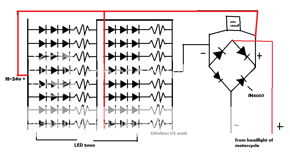

    Hi Guys,
    I saw a diagram of a LED Headlight for a Motorcycle. So I tried following it's instructions.
    I've used these:
    72 pcs 5mm LEDs
    120 ohms 1/2 watt 12 pcs
    also created a rectifier to convert the AC to DC:
    50v 100uF Cap
    4pcs IN4007 diodes
    so here is the diagram: ( sorry I just did it in mspaint )
    The lights are so bright and I tested them on standby for 2-3 minutes.
    The problem is the resistors heats up that you can't touch them. I'm worried if I use my bike that these resistors might burn.
    Can you please tell me what resistor should I use or what are other options I can do? Thanks!

    What kind of LEDs?
    Measure the voltage drop across the resistor.
    I would also measure the current going to each string to make
    sure it is within the LED's spec (although you can calculate this from
    the voltage drop)

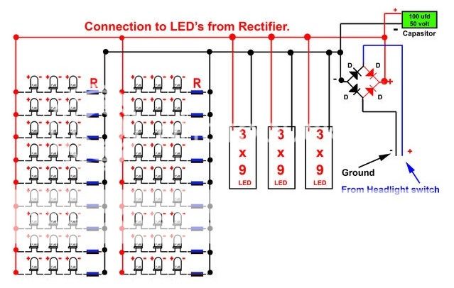

      "I saw a diagram of a LED Headlight for a Motorcycle. So I tried following it's instructions."
      It might help if we coud see that diagram and instructions.

        Originally posted by smeezekitty
        What kind of LEDs?
        the voltage drop)
        hi thanks for the reply!
        they are 3v to 3.3v LEDs
        drop is 4.2v
        unfortunately I don't have a tool to measure the current, my tester is crappy
          Thanks for the reply!
          here is the original diagram, i did not include the 3 big LEDs though, they are not available from our stores here

            Re: LED Headlight for Motorcycle
            OMG im sorry guys I had the LEDs in parallel.......
            I'll give you guys an update after I put them in series...im so emabrrassed
            these LEDs came from flashlights and I didn't bother removing them from their mini PCB so I assumed they're in series.
            sorry.. just a noob in electronics

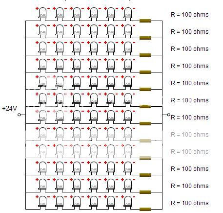

                  hey guys I did this and the resistors are still hot but not as hot as before. Still thinking they might burn when I give it a long ride. Any suggestions?

                    The orig schem does not specify what the R values are. Where dd you come up with 120 ohms?
                    • boyrekta
                      • Aug 2014
                      • 23
                      • Philippines
                      hi,
                      here is the site where I tried to copy it.
                      http://www.instructables.com/id/DIY-...ens-Headlight/
                      I just used less LEDs
                      • SteveNielsen
                        Retired Tech
                        • Jun 2012
                        • 2327
                        Originally posted by boyrekta
                        hi,
                        That explains it. You changed the circuit, eliminating some LEDs. That increased current flow throught the circuit, overheating the resistors. You need to increase the value of the series resistors to compensate but I'm not doing the math.

                                  hey guys I used a LED resistor calculator which a searched in google and ended up on this circuit, resistors aren't heating up ( although warm ).
                                  Thanks for all your replies!!
