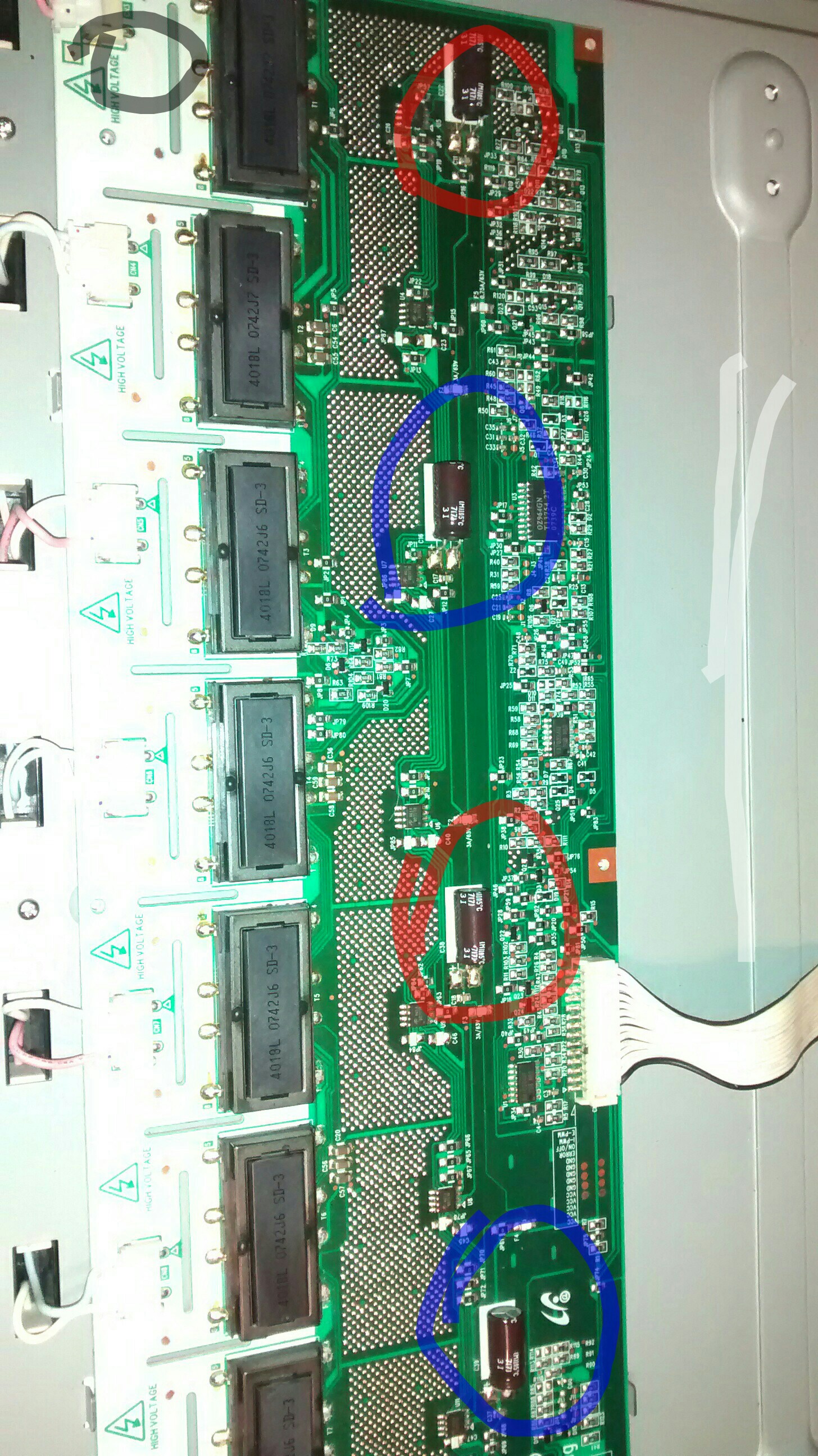

function?
  • spoksta
    • Jun 2014
    • 20
    function?

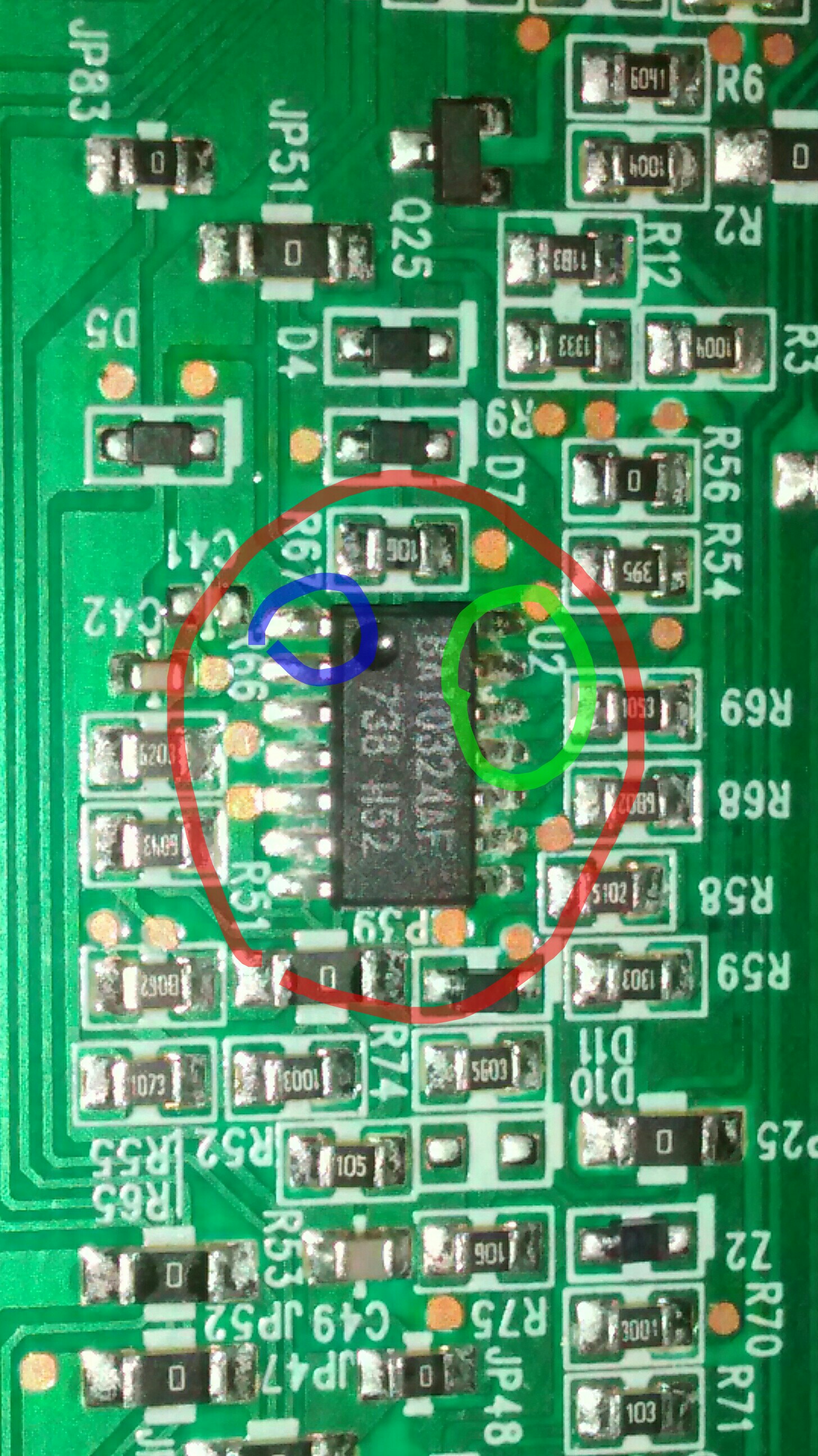

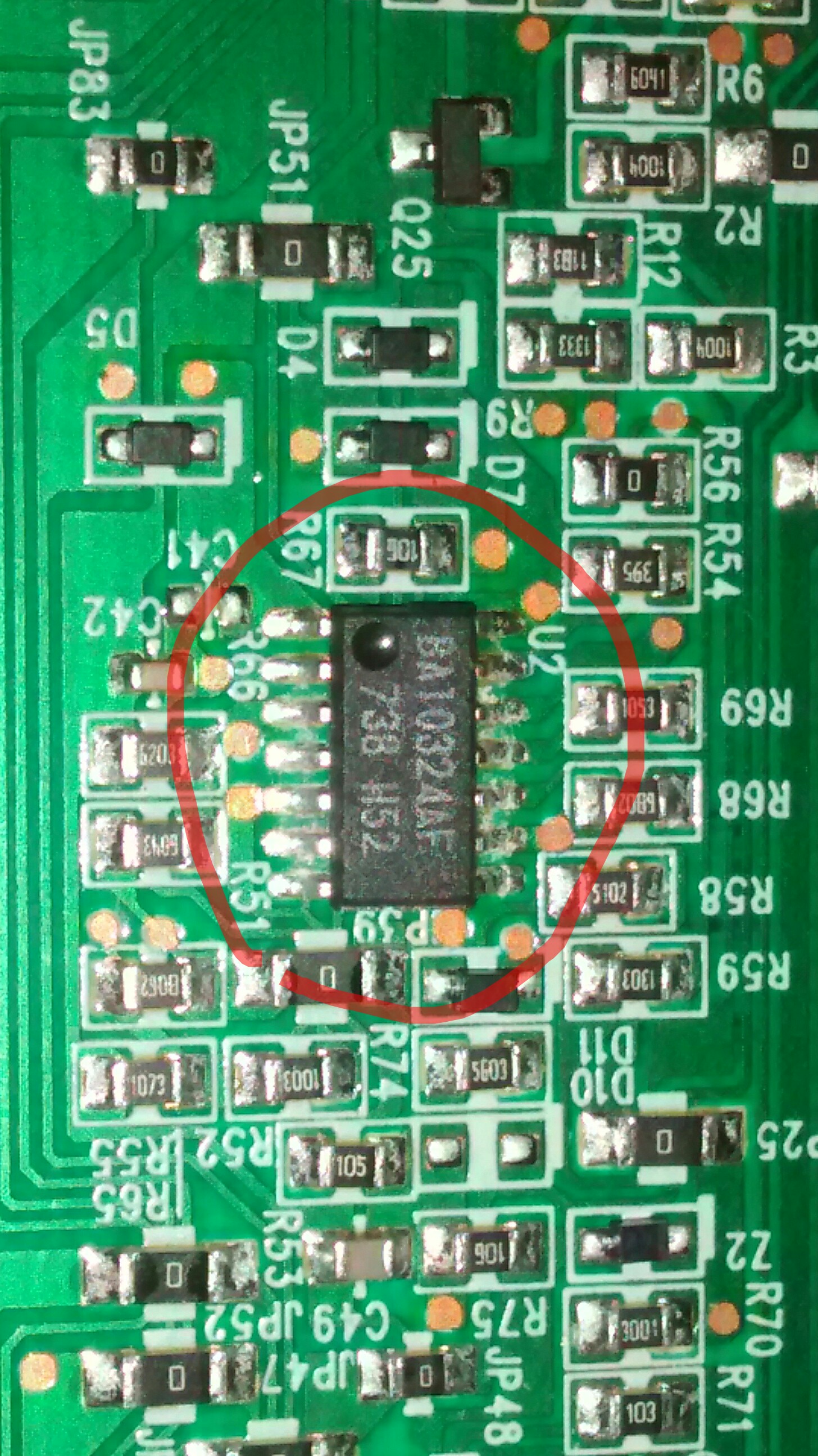

    Can someone tell me what this is?

    Here is the data sheet for what it is and how it works.

      Re: function?
      A simple google search for what it's written on the chip says what it is.
      General-purpose BA10358/BA10324A family and high-reliability BA2904 /BA2902 family integrate two or four independent
      Op-Amps and phase compensation capacitors on a single chip and have some features of high-gain, low power consumption, and operating voltage range of 3[V] to 32[V] (single power supply ). BA3404 family is realized high speed
      operation and reduces the crossover distortions that compare with BA10358 family.

        Re: function?
        Its on the invertor board? Of a samsung lnt3242hx/xaa, it has sound and picture but no back light, if I jump the terminals together my back light works agaim

            Re: function?
            The backlights come on and stay on and you can see normal pictures?
            You basically connected pin 4 (+VCC) o the non-invert input pin 3 of the Opamp which will make pin 1 output pin to go high. I have no idea what that IC is being used for in that section of the circuit, you should check the DC voltage at pin 1 without jumping pin 3 to pin 4 see what you get, then when the pins are jumped.

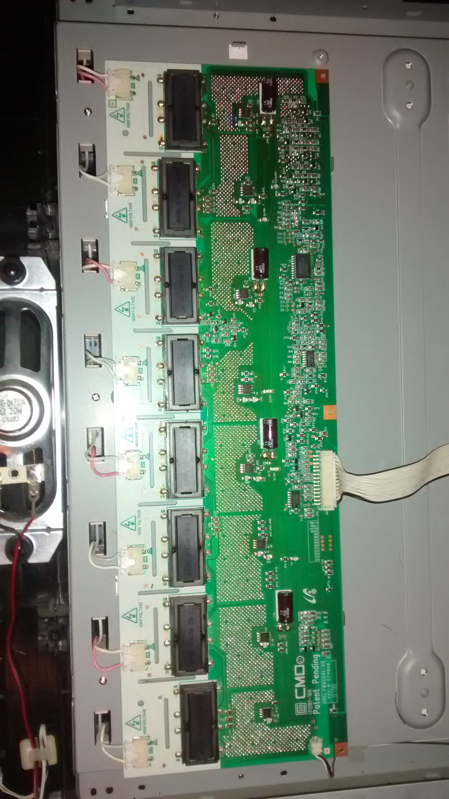

            Also post the whole picture of this inverter board so I can tell you where to check and see if it is getting the bl_on (inverter_on) signal or not.

              Re: function?
              Sorry I work long hours, but yes I let it play like that's for about 5 mins and everything seemed fine, this is the board
                Re: function?
                Check the DC voltage on the ON/OFF pin on the inverter board when TV is OFF and when TV is ON, then report the readings. You can see the connector pin out printed close to the connector.

                  Re: function?
                  I'm not sure I have the right meter for this, its 0 off 4.17v on, if I reverse the ground and positive. Its 14.13?? Please be patient on this with me...

                    Re: function?
                    You have several lamps in that tv, each with its transformer ... from each transformer there's a signal which tells if the current used by the lamp is too high, or maybe if the lamp turned on or not.
                    The signal coming in the opamp may be a sort of "sum" of all signals coming from all those transformers, so if the voltage is too high, the opamp will turn off the whole set of lamps to protect the transformer/driver etc etc.
                    The incoming signal is compared to a "good" voltage level and if you signal voltage is too high, there's a problem with the lamps.
                    By shorting the pins, you're probably disabling the opamp so the protection is skipped and the lamps stay on, but if there's a problem with one of the fluorescent tubes or with one driver/transformer, you may have problems in the future (overheating, maybe it's loose wire at a fluorescent tube or something like that, maybe tube is just too old and uses too much current...)
                    I'm just guessing though...
                      Re: function?
                      So the BL_ON signal is fine, beside what mariushm had indicated, we do not what that pin 1 output pin of the Opamp goes to, without diagram, will never know unless you will try to trace out the wiring on that inverter board and draw up the diagram to see how it is put together.

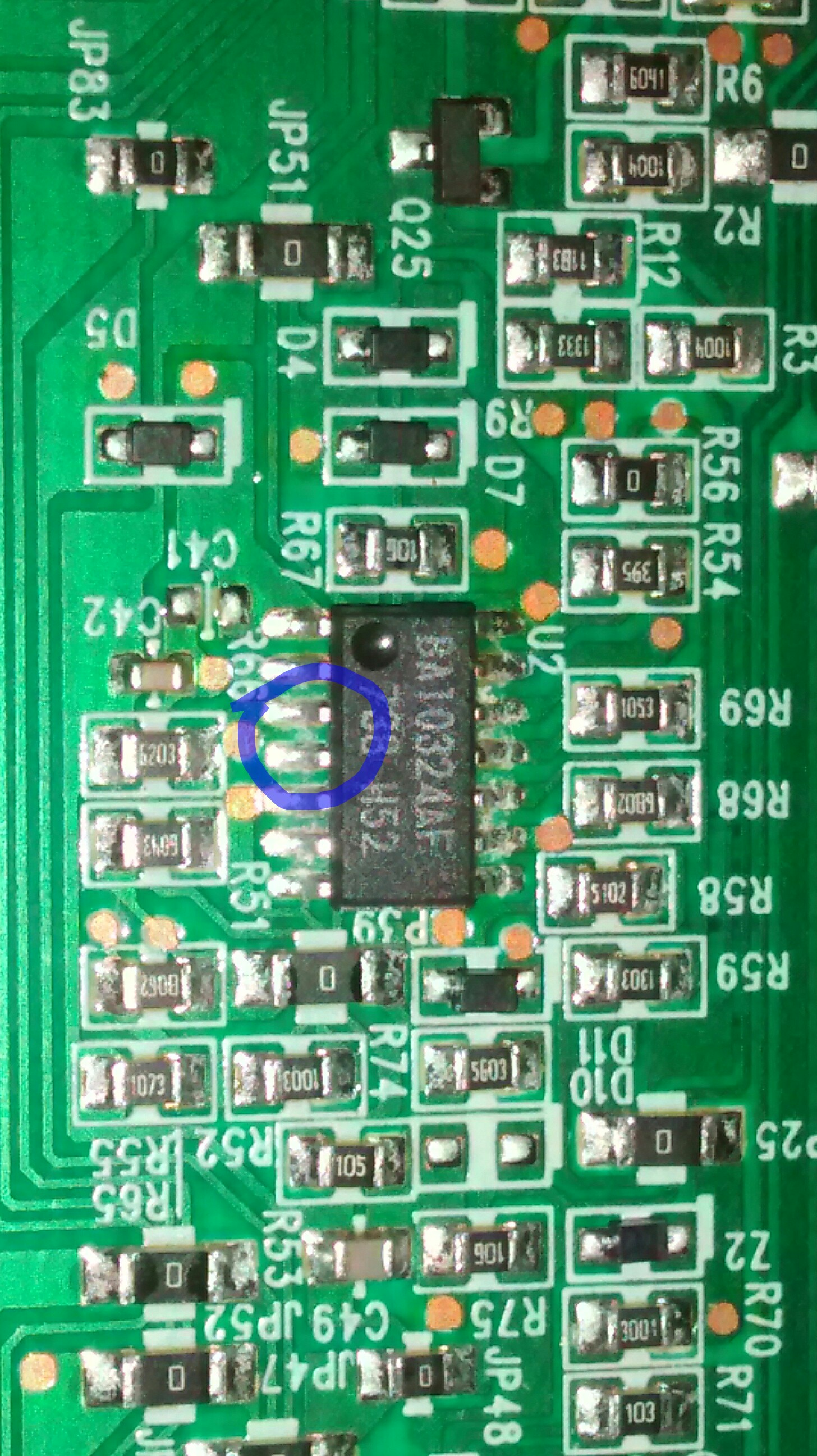

                        Re: function?
                        Is the blue pin 1?? And does the connectors in green look OK? There's quite a few dark spots like that on the board? The other boards look fine visually

                          Re: function?
                          It appears to run to e-pwm?? I could be wrong I it runs under a connector so I kind of lose it for a min
                            Re: function?
                            Yes, that is output pin 1. I cannot see well on the blue circle.
                              Re: function?
                              So what voltage do you have on the white connector I_PWM and E_PWM? Check in DC mode and in AC mode.

                                Re: function?
                                E doesn't read?? I is 23.7 and 14.35??
                                  Re: function?
                                  "I is 23.7 and 14.35" is that 23.7VDC and 14.35VAC? or mV? It is way too high.

                                    Re: function?
                                    Vac I believe, I'm pretty sure I jus killed it :-(

                                      Re: function?

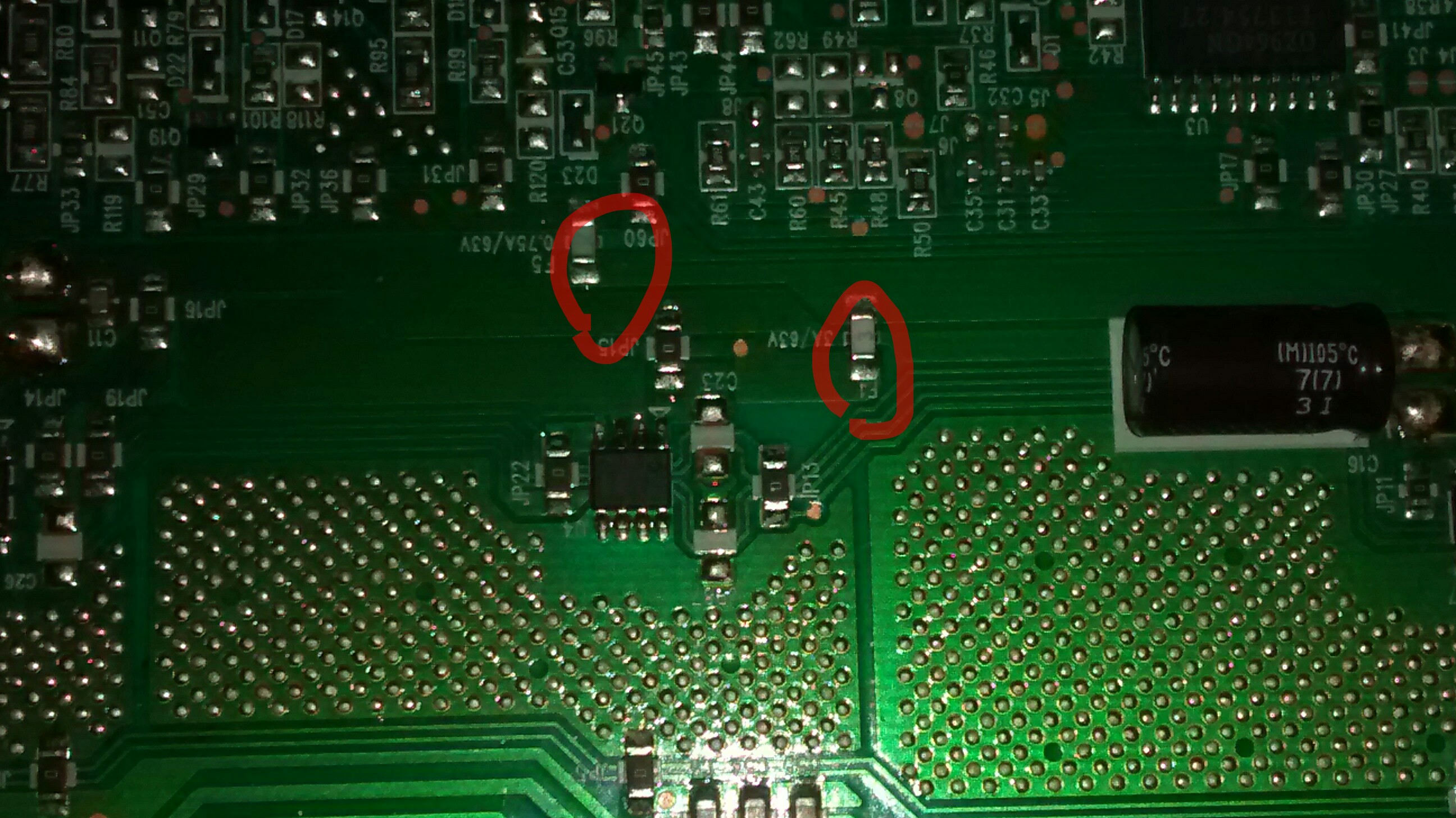

                                      These are fuses right? The were three ohms before the thing I asked in the first post kinna popped? Now the back light doesn't come on at all and they read 15.21 and 23.11 volts now...
                                      • spoksta
                                        • Jun 2014
                                        • 20
                                        Re: function?
                                        These were also roughly 24v when I started now the two in blue are still 23-24, the 2 in red are 2.224 also all the cconnectors to the lamps were 14.4 volts now the black one hhas no reading... The pins all still read fine, so the power doard is still functioning isn't it?
