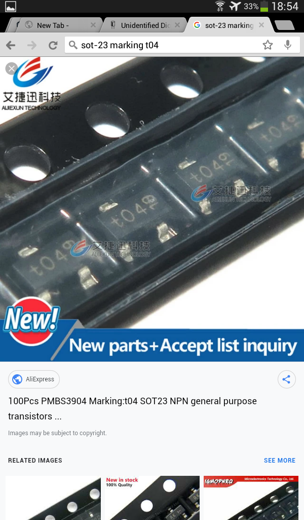

    Hi everybody,
    can anybody please help me identify this diode?
    It is somehow attached to the HDMI port of an Asrock VisionX 471D (ASR1501, HM87-MXM).

    Identified as PMBS3904 NPN transistor

      I am 80% sure that is not a diode. That is a transistor. Unfortunately that is all the help I can provide.

          • 31145
          or it could be an 11v zener
          BZX84-A11

            Thanks to all!
            BrandonCarriveau set me on the right track, so i could figure it out myself before i read harp​'s reply.
