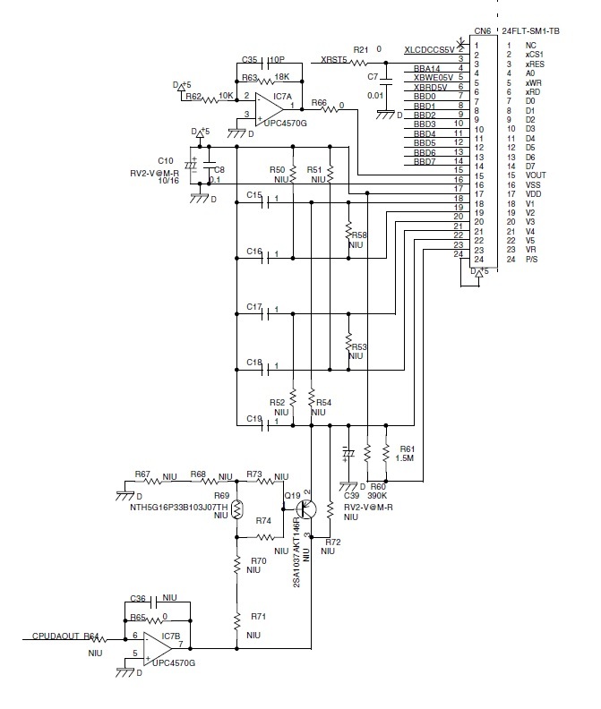

    The LCD screen on my Roland Fantom XR rack synthesizer has gone blank. I managed to get the schematics for the connection to the LCD.
    The standard LCD has D0 to D7 pinouts (in addition to the normal VDD, VSS, CS, RES, RW, EN etc).
    Can someone help me to identify what V1 to VR is for? Also how does VR work?
    Any help is truly much appreciated.
    • 31305
    can you see what the chip(s) are on the display or are they just blobs of resin?
    it looks like a hitachi standard interface but with a lor of the voltage bits off the display board.
    read this datasheet to learn a lot about how they work

      See https://www.hpinfotech.ro/SED1530.pdf
