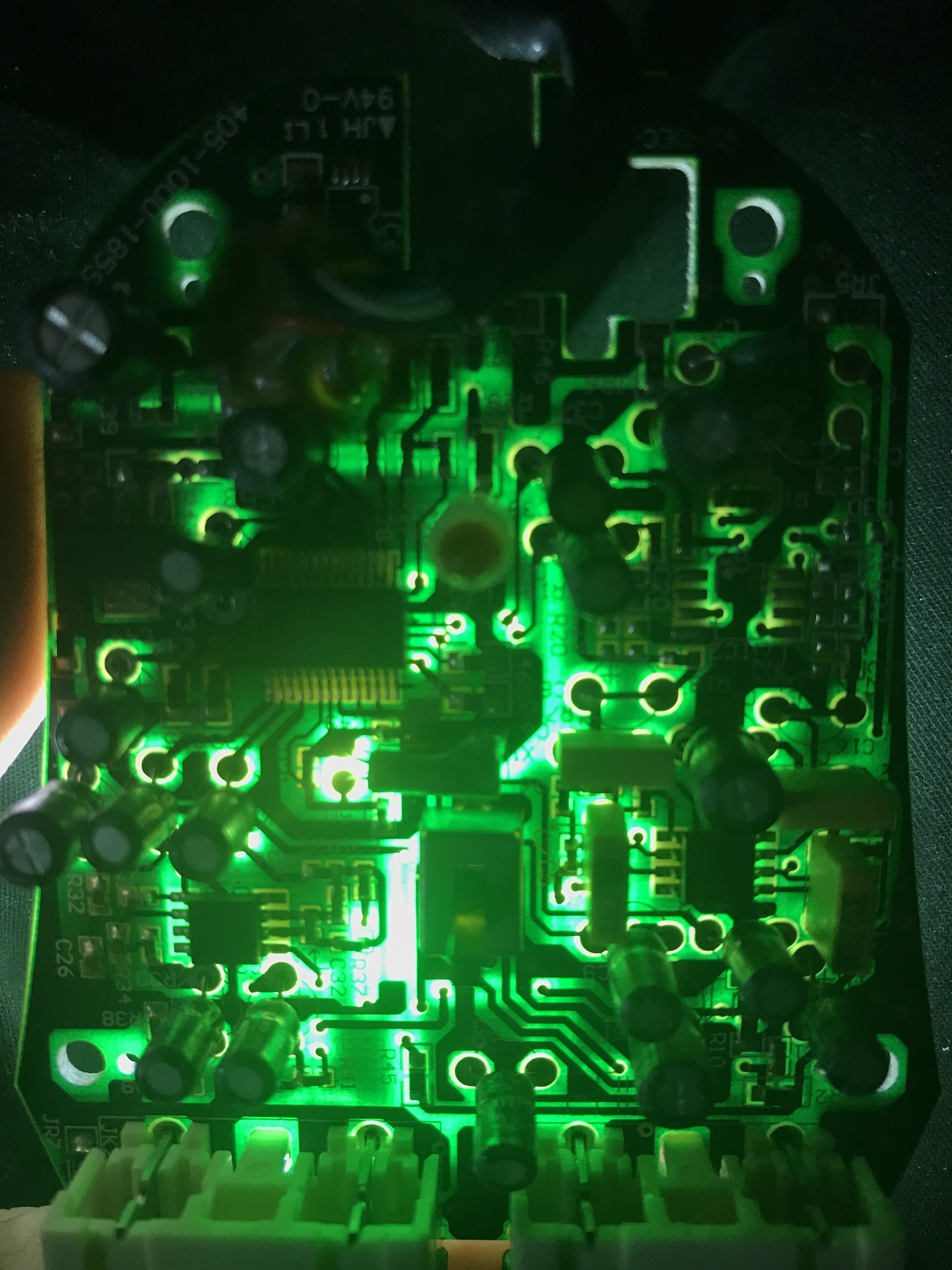

    Hi
    I have a Citronic AC-1USB.
    When I run a turntable into it and then try to record it. The volume is too loud and distorting. In the red. Mainly 12” Singles. I haven’t tried a CD into it yet. I’m wondering if there is any way to bring the volume down inside the unit itself. Change a part or two. Put a small pot somewhere as there are no adjustments at all in there. I’m looking for the schematic but not found one yet.
    Heres the circuit board inside.

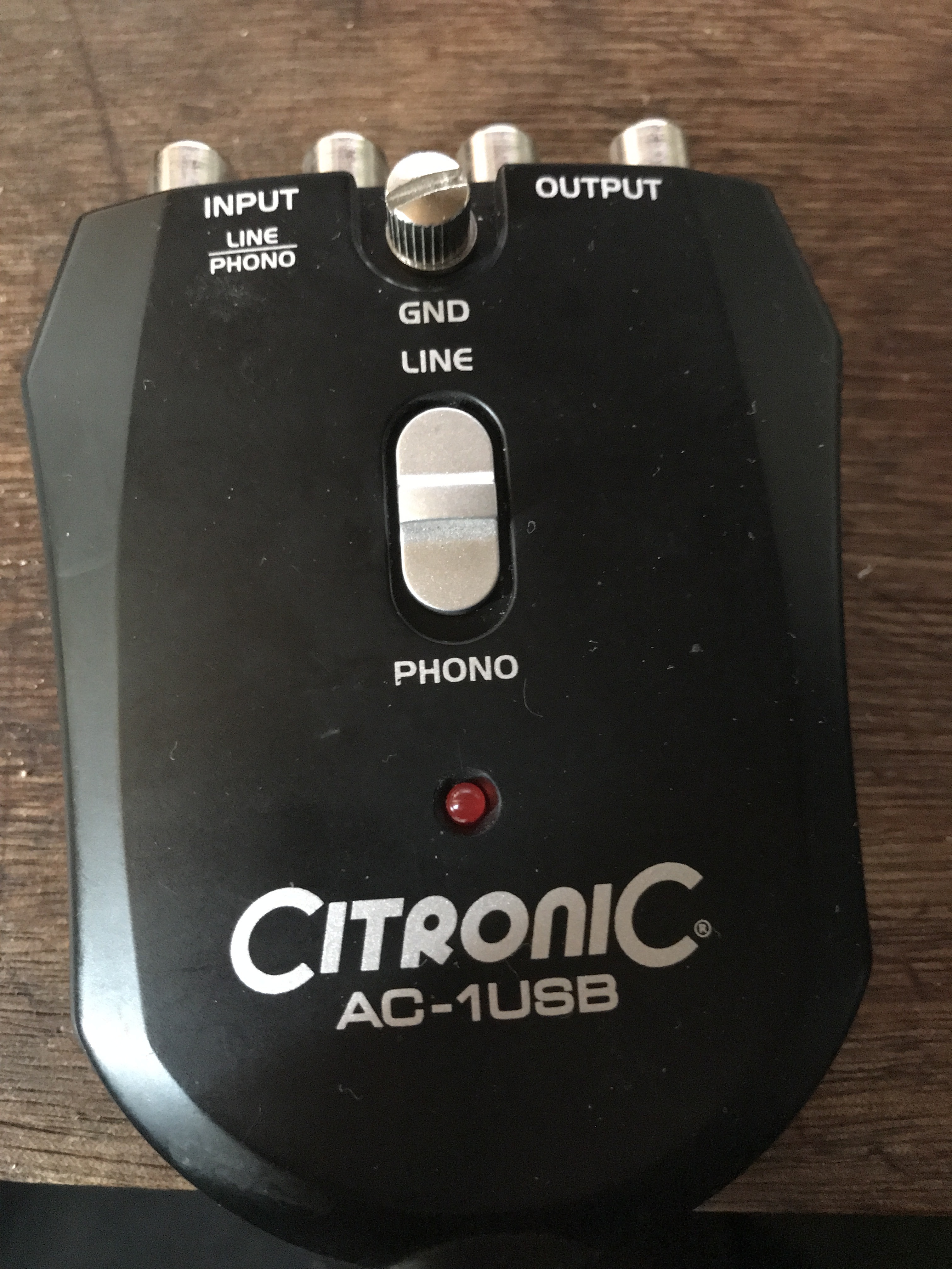

      It’s a usb audio interface but you can connect a turntable to it or another audio source.
      I’m talking about the input via USB.
      It’s too loud for some reason.

        If you record on a computer, make sure that your inputs are not checked with "busting mode or so". That amplify input to very high level. Also, check where is input connected: in line-in or in mic... and review settings sliders.
        That switch Line - Phono, what efect do on recording?
        Is that device before work normal, on different computer?
        I see jrc4580 opamps, maybe to adjust lower gain by replacing/adding some resistor in IC3 area...
        And, on main chip legs... near LED, is this green corrosion, liquid damage?
        Try to clean it with ipa and toothbrush.

          1st: make sure input on the AC-1USB is set to PHONO and not LINE. A phono signal has to go through RIAA equalization (also usually a high-pass "rumble" filter), otherwise the signal will sound "teeny-tiny" with no bass.

                Here is a better photo.

                      you can get a datasheet for the chip and calculate the gain of the op-amps

                        Took some photos with a light under the board to see the tracks. Click image for larger version

                          Hi again.
                          I measured the voltages on the chips.
                          Im getting +4.9v+ on pin 8 but 0v on pin 4 on both of them.
                            • 31192
                            thats not important - you need to just build a small mixer or variable atenuator

                              I was testing it again with a turntable and Albums are -6 to -8db.

                                      Hi
                                      Its a 1210mk2. Cartridge is a Stanton 500.
                                      The LPs are a nice volume. It actually sounds pretty good. I was playing all sorts. Al Jolson. Brenda Lee. George Jones. Del Reeves. Eddie Cochran.
                                      I don’t think it’s made for 12” singles. If I somehow reduced the volume. The LPs would be too low then.
                                      The 12s are more than 10db louder. Surprisingly ,one of the LPs peaked around -3.5db too ,but didnt go near 0db.
                                      Yea I don’t understand it either ,I’ve been playing vinyl for over 40 years. I’ve never known a phono input to be loud like that. From Amplifiers to Recievers and Various Mixers ,Record players.
                                      It’s great for LPs though.
