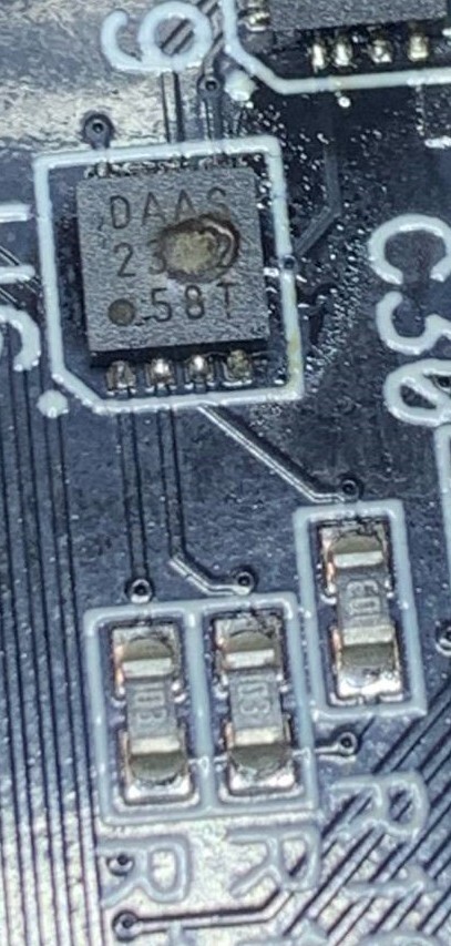

    Not sure if this is the correct place. I need to identify This IC id anyone could help please.
    Kind Regards.

    http://markingcodes.com/search/c/daas
    DAAS = MCP4151-104E/MF DFN3x3-8 SPI Single Volatile Memory 8-bit Potentiometer
    https://www.alibaba.com/product-deta...494452279.html (photo)
    http://ww1.microchip.com/downloads/e...doc/22060b.pdf (datasheet)

      Thank you so much.

        What device is part going to be used in

          It is for a Svod4 I ordered it over 2 month ago. They kept saying it will be posted at end of the week this went on till I asked for a refund .It did turn up and after i plugged it in and did not work. When I contacted them they did some tests and told me to open it up.When I did it had a melted ic the one in picture. I replaced it and still not working. Contacted then and now they just ignoring my messages. Asked for a replacement and they told me it's my fault. All I did was plug in the usb port and install the drivers. I have other programmers so I know how they work. Now left out of pocket so got to try to fix it. They are just ripping people off I would avoid if I knew that before. I am in the process of reading the MCU to get the info from it to reprogram a new one if I need to replace that also.

            Read access will most likely be 100% blocked for the MCU; there will be protection against reading the firmware (security against cloning...).

              I seriously doubt that you will be able to read the MCU because a lot of them are locked from being downloaded unless you have what call a token or something similar to that

                Yeah mainly do electronics on cars ie MCU reading from vw clocks ecu's etc. As I am auto electrician have access to lots of programmers. We have to crack the mcu so we can gain access to the clocks. Sure it's no different.

                  Can you show us a photo of the whole PCB?
