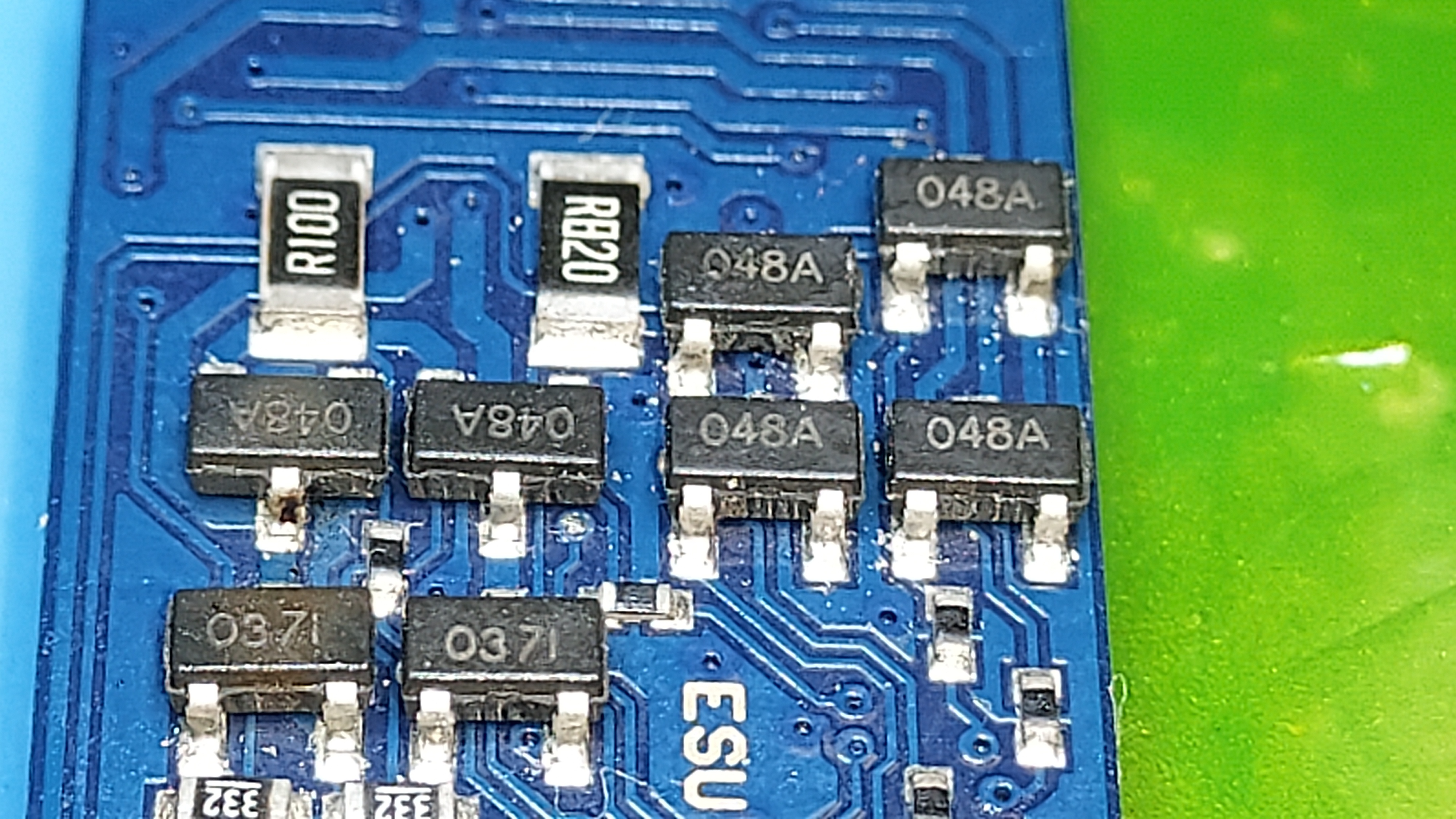

O48A and O37I components..........could you please help me to identify them?
  • Francesc V.
    Tempus fugit
    • Nov 2022
    • 231
    • Catalonia
    They are from a DCC railroad decoder.
    I am "almost certain" that O48A might be a N-Channel mosfet, and O37I a P-Channel mosfet...........however, not able to find them with these references.
    Thanks in advance for any hint.
    Francesc.
  • truclacicr
    • Apr 2019
    • 321
    • australia
    03XX SPP2303S23RG SOT-23-3L 3 P-Channel Enhancement Mode MOSFET
    https://www.cheertech.com.tw/Syncpow...et/SPP2303.pdf
    04XX SPN2304S23RG SOT-23-3L 3 N-Channel Enhancement Mode MOSFET
    http://www.cheertech.com.tw/Syncpowe...et/SPN2304.pdf
    http://markingcodes.com/search/c/03xx
    http://markingcodes.com/search/c/04xx
    • Francesc V.
      Tempus fugit
      • Nov 2022
      • 231
      • Catalonia
      Thanks!!
      • Francesc V.
        Tempus fugit
        • Nov 2022
        • 231
        • Catalonia
        Are these 03xx and 04xx replaceable by AO3400 & AO3409? These are cheaper and I have them in stock. :-)
        I would say yes but happy to have a second opinion.
        Regards,
        Francesc.
        • truclacicr
          • Apr 2019
          • 321
          • australia
          AISI, the Vgs cutoff is different, so you will need to determine if that makes a difference in your application.
