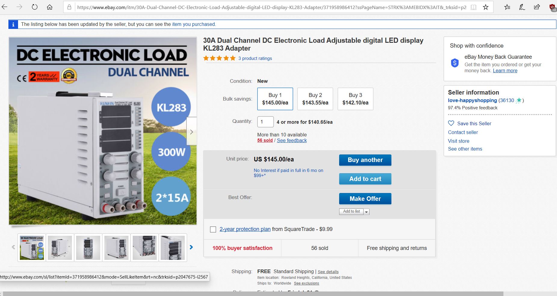

    This unit is widely available on Ebay, Amazon, etc. I paid $145 for it with this listing:
    https://www.ebay.com/itm/30A-Dual-Ch...53.m2749.l2649 but prices may very slightly.

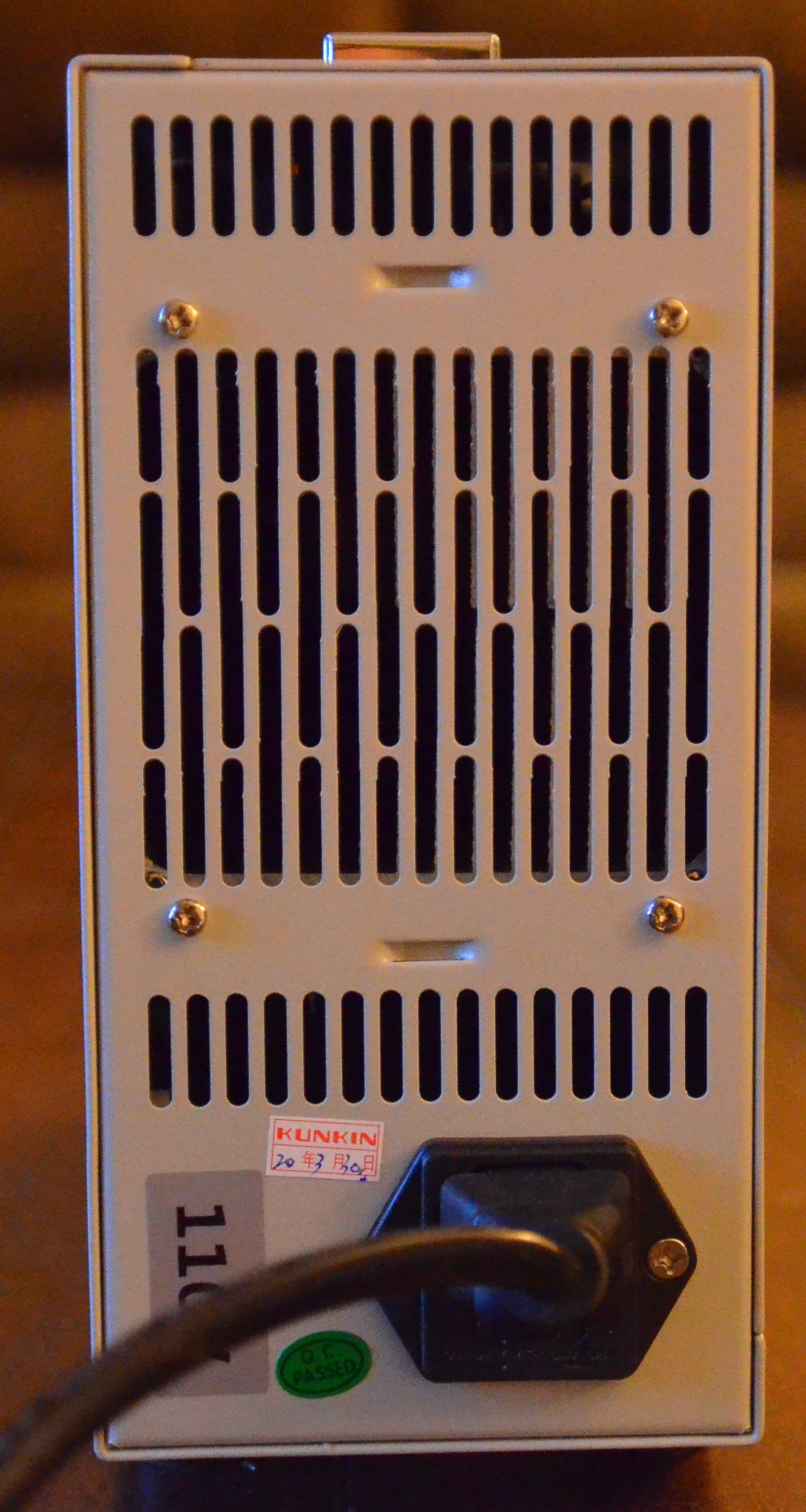

    Here's the unit
    Overall it seems like a decent unit for the price, but there is some evidence this isn't a "high-end" piece of test equipment with some minor fitment issues with the case and "cheap" feel to the buttons (a little loose in the cutouts).

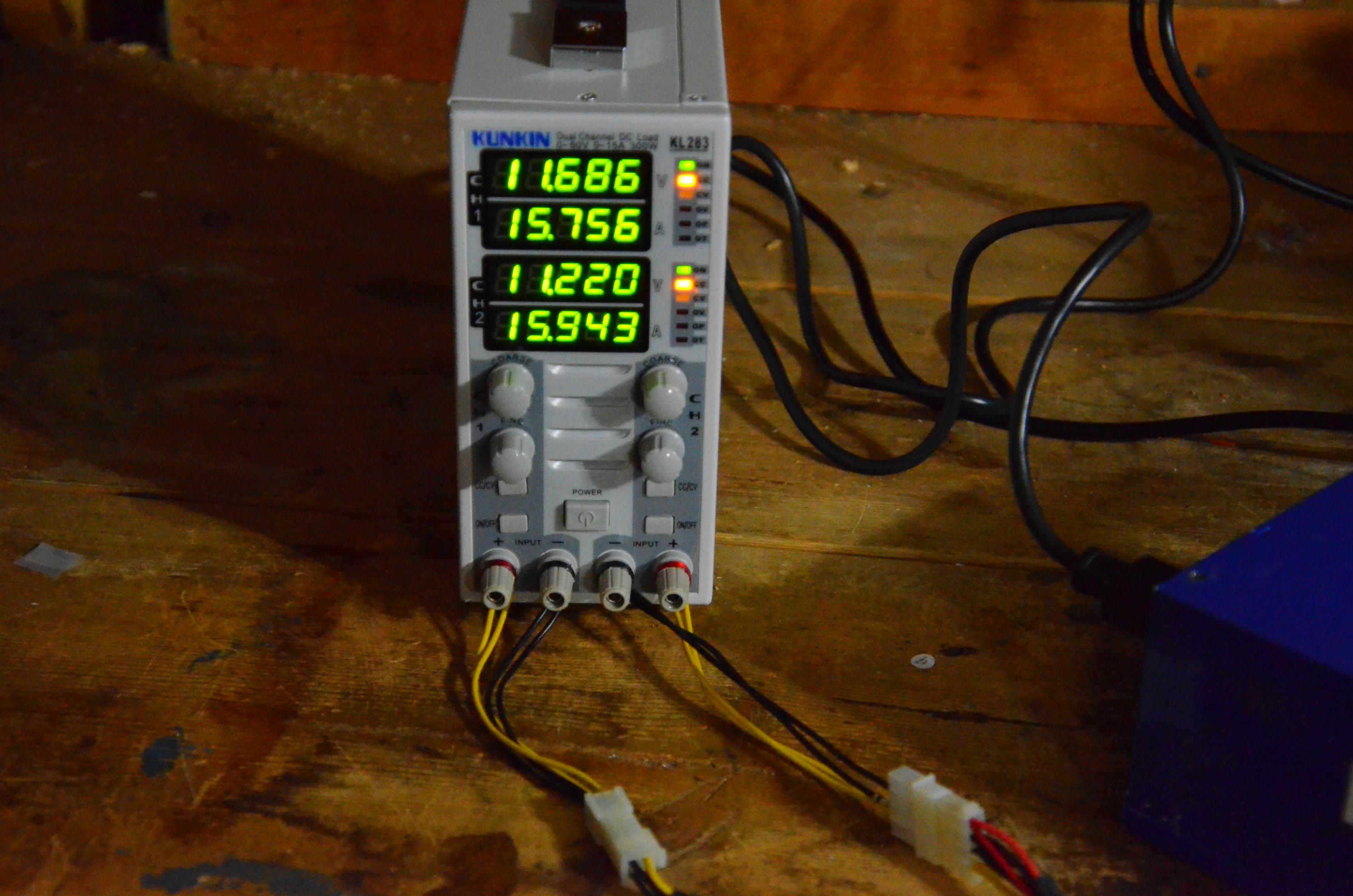

    The accuracy of the meters on the display also appears to be pretty good:
    To give this unit a real test I pulled out my PC Power & Cooling Silencer 750W and hooked the 12V rail (rated at 60A max) to the KL283. Given the 300W rating I was expecting the tester to cap me at 12.5A per channel since I was using 12V, but surprisingly I let me pull the full 15A per channel (30A total) without issue (note: each channel uses 3 IRFP250M FETs rated at 200V/30A):

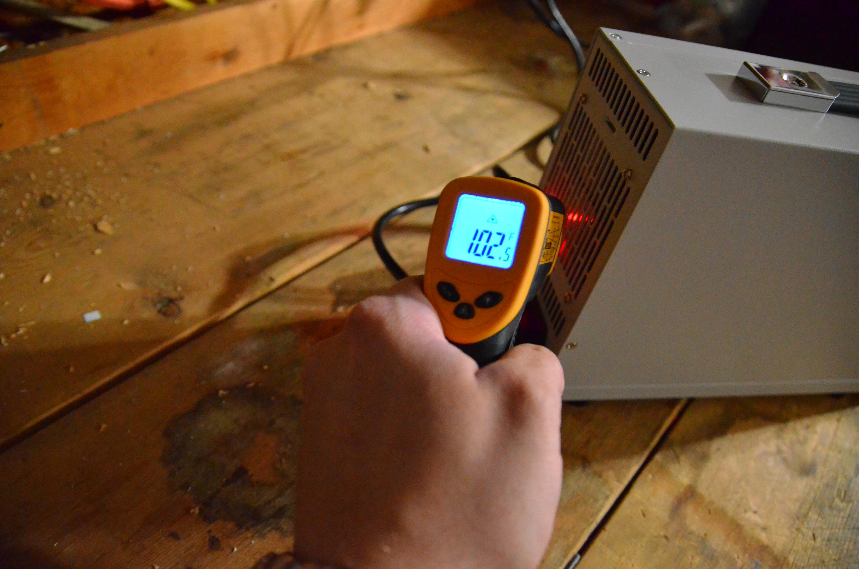

    Exhaust Temperature was 102.5F (39.2C) with an 80F (26.6C) ambient Temperature.

        Re: Kunkin KL283 300W (150W X2) electronic load
        Nice!
        For a sub-$150 lab precision instrument, it's not a bad deal at all. Hopefully it lasts, though I don't see any reason why it shouldn't. After all, it did survive the full 15 Amp load on both channels. Thus, whatever MOSFETs they used inside are either genuine or at least capable of handling the load. And looking at the internal pictures, I do see a linear transformer, which I presume is for powering the electronics. Therefore with no SMPS inside for the electronics, I think at worst you might have to recap the linear PSU outputs eventually... but that may not be in at least 5-10 years, as linear PSUs don't stress caps much. As such, even crap cap brands tend to last a long time.
