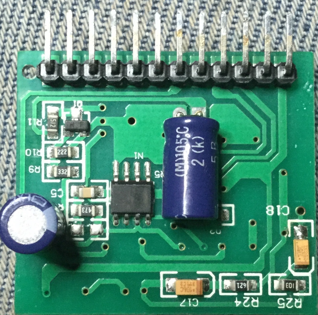

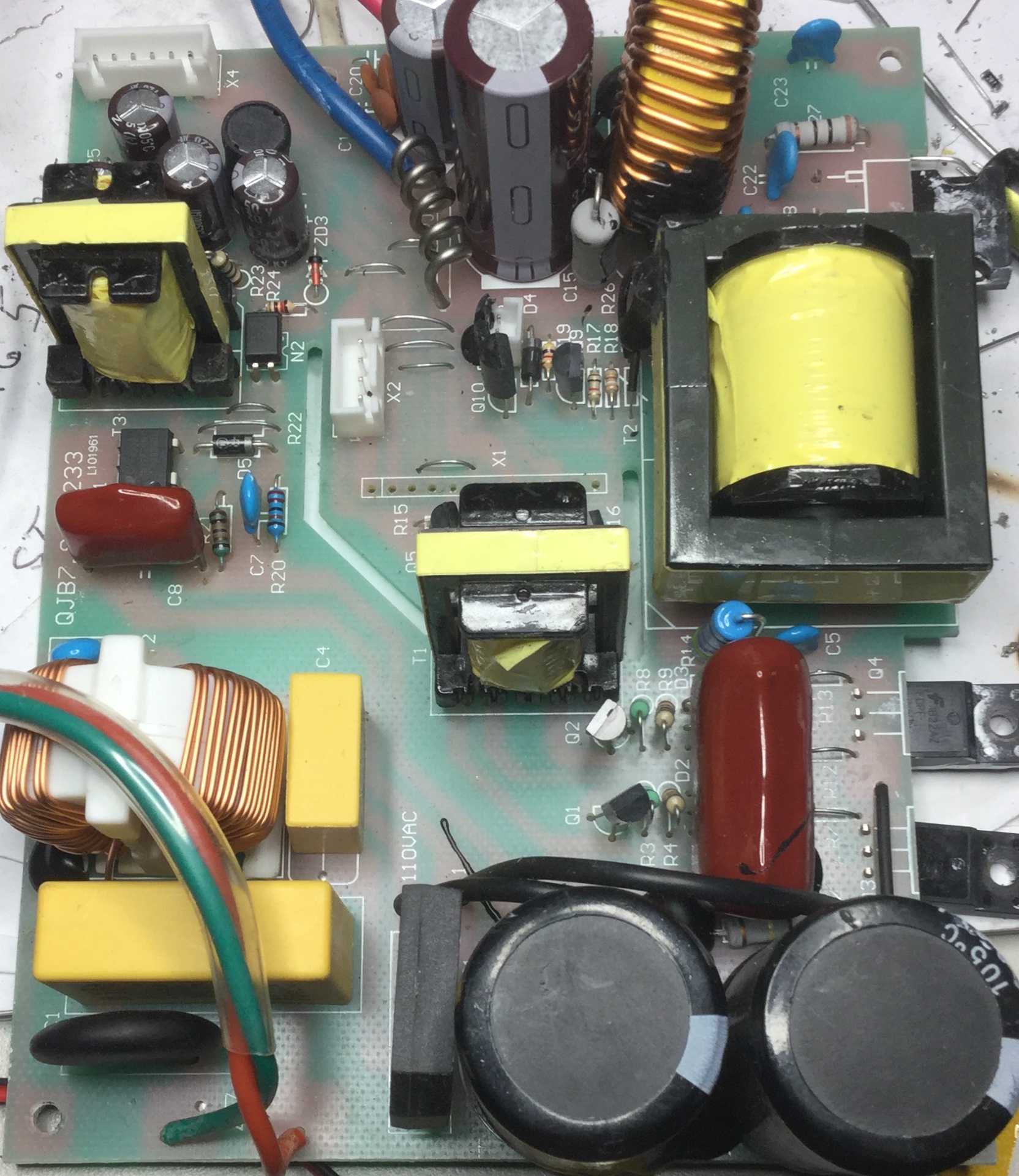

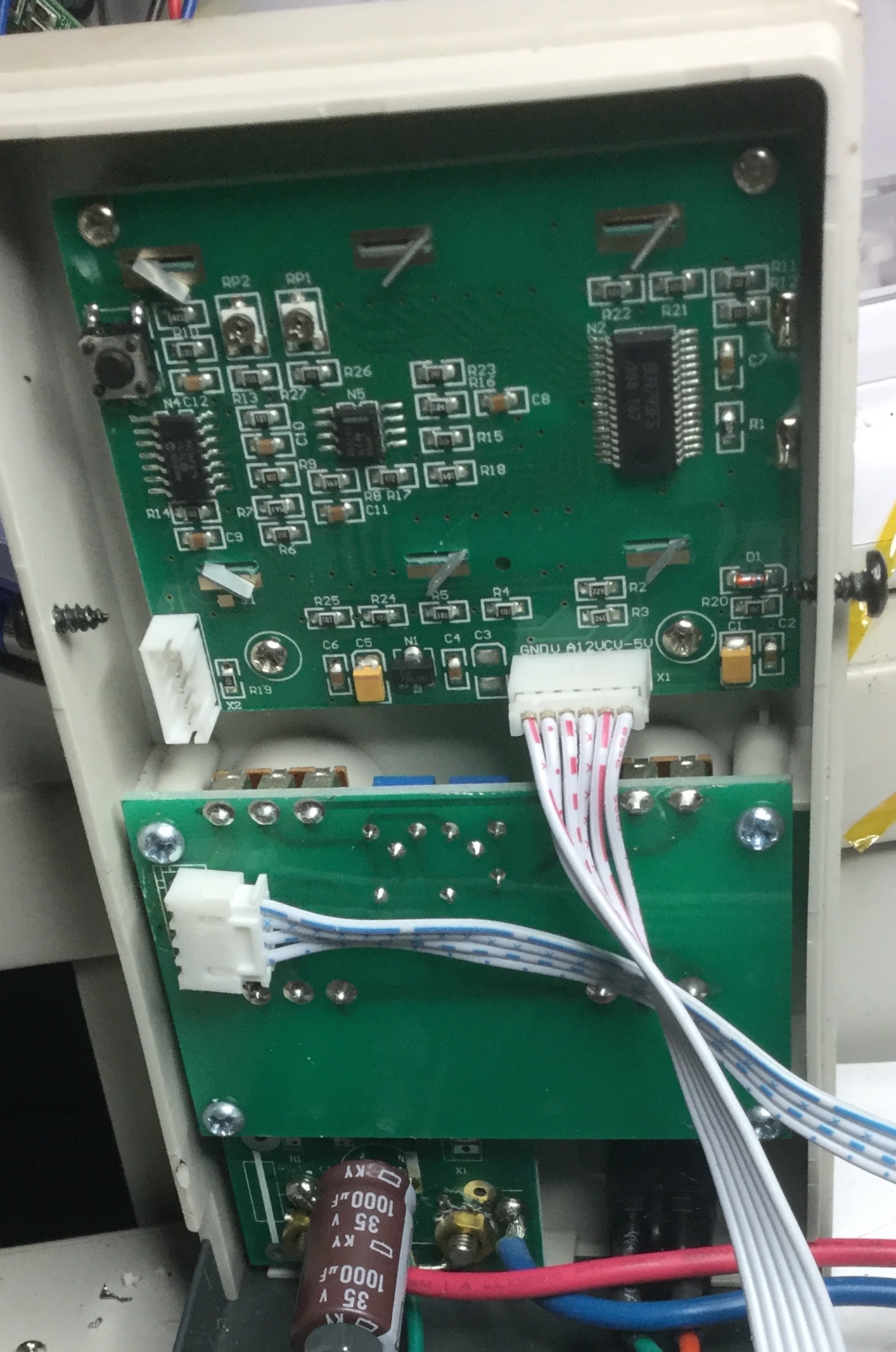

    I have this 10 amp 0 to 30 volt switching power supply that decided to have a 630 milliamperes draw on it at 0 volts
    I open it up to find non brands name capacitors in it
    I am not sure how this switching power supply is set up
    Could someone please explain how this power supply works
    Here is the capacitor ESR results
    (1) 47uf@50 volts 0.46
    (2) 47uf@50 volts 0.45
    New 47uf@50 volts 0.35
    (1) 100uf@25 volts 0.34
    (2) 100uf@25 volts 0.35
    New 120uf@50 volts 0.08
    (1) 220@25 volts 0.13
    (2) 220@25 volts 0.13
    New 220@35 volts 0.03
    (1) 1000@35 volts 0.03
    (2) 1000@35 volts 0.03
    New 1000@35 volts 0.02
    3300uf@35 volts 0.02
    New 3300@35 volts 0.02

    Re: MPJA 10 AMP @ 0 to 30 Volts Switching Power Supply Cap Fault
    interesting.
    see the current shunt coil?
    it connects to the small board - i suspect the 2 ends feed an op-amp to monitor the voltage drop.
    btw, the internal tactile switch is just asking to be pressed!! they should have painted it red!

      Yes
      I wonder about that button as well just what does it do
      The button does not seem to do anything at all but there is another connector that might be how you program the controller but this is only a guess
      On the small board the small IC chip is a LM 358
      The switching power supply is back working again
      The only problem this power supply has is that it has to be ON a little while for the voltage to stabilize it drift a little bit a couple hundredth of a volt for first 5 minuets or so and then it fine
      But it has done this when I first turn ON new out of the box

        I used the following caps
        KY
        KZE —> maybe
        LXZ
