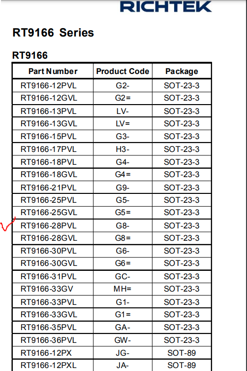

    Hi powered with 12v and should be 5v smoked and this 3 leg component is shorted then removed and short is gonne but need help to replace alternative (to G8 ss6)
    thanks a lot!!
    product: 5v wanscam ip cam ws00036
    damage: connected to 12v and someked

    I suspect that it's a voltage detector or PSU supervisor.
    http://markingcodes.com/search/c/g8
    http://markingcodes.com/search/c/g8-
    G8 (or G8-) is a RT9808-42CX detector in an SOT-89 package, but RT9808 also comes in an SOT-23 package.
    I suspect that you have a 4.2V RT9808-42CV detector.
    https://pdf.dzsc.com/T98/RT9808.pdf

        G8- xxx - RT9166-28PVL (Ultra-Fast Transient Response LDO Regulator).
