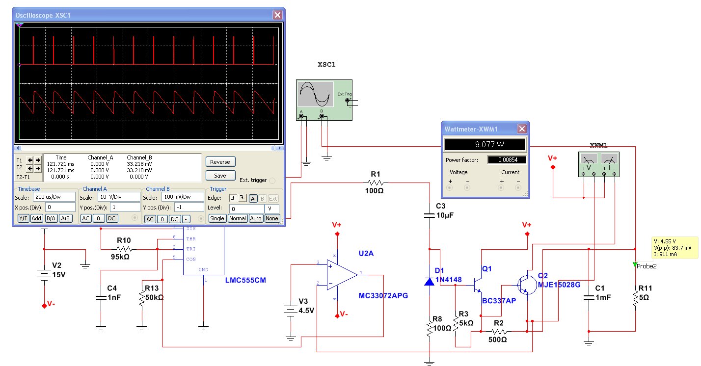

    Hello
    Has anyone built a practical circuit that uses capacitors (not coils) to convert DC to DC? I have experimented a little and have made these topologies so far:
    all the below with common ground which is also important
    DC -> 555 -> inverter
    DC -> 555 -> doubler
    DC -> 555 -> +Vs/2 -Vs/2 (ie split a 20V into +/-10V)
    I have not taken some of these circuits beyond a few mA on the load.
    I am looking for ideas/circuits to step down, eg DC -> 555 -> Vs/2 or Vs/3 as an example, or even variable.

          Thanks. I have found a few not only from MAxim and Linear, but also NS : LM 2751 - but they all seem to be low voltages and currents (eg 5V at 80mA). I have not discovered an equivalent to, say, LM317 but in a switched capacitor topology.
          I have built and tested a very simple switched capacitor DC inverter circuit that is good for any voltages (I think it was tested to 15-20V and 500mA), so I was confident that the idea(s) could also be applied/scaled to other DC-DC conversions and currents, especially DC step down.

                  I also tried simulating the two caps in series and then in parallel, but could not create a suitable circuit (too many switches were needed), was becoming very complex.
                  I have also many times fallen foul of efficiency - I design something which I think is great only to realise it still spends just as much power as a linear approach would do. Here is a schematic of such an attempt.
                  Voltage supply is 15V. Output voltage is 4.5V/1A. A 555 generates a fixed frequency of about 7.3KHz. A switching transistor arrangement charges the charge/load capacitor from the power supply. An op-amp controls the duty cycle of the 555 based on a desired voltage and what's actually on the load.
                  In order to achieve efficiency, the switching transistor should never be in the linear region. Secondly the switching transistor should spend more time being on or off, rather than transiting from one state to the other. If both these conditions are met, then we have good efficiency. Unfortunately as the schematic shows, we are pulsing this transistor so many times, that we spend so much power on it, just as much as if the transistor was driven directly by the op-amp (linear operation).

                    Did you try using MOSFET with low Rdson? You will need low Vsat if you are going to use transistor to achieve better effi.
                      Re: switched capacitors for DC to DC
                      Again, that circuit will have basically the same efficiency as a linear reg, probably less. But it will never be MORE efficient. The reason is simple, if you connect a capacitor to the supply directly it charges up instantly drawing a very high current.mIf you want to limit the output voltage you need an inductive charging source, i.e. a buck converter, otherwise the cap will charge instantly OR the charging will be limited only by the resistance of the power switch which will dissipate power to limit the voltage.
                        Reading from Maxim's documentation, it should be possible to monitor the charge capacitor's voltage - it should not have to charge to full charge instantly. At least that is how they build their own switched capacitor ICs.
                        In practice however, as you said, I am discovering that the only way to keep that capacitor from charging to the full voltage, is to interrupt the charge cycle, in other words NOT to allow the pass transistor/MOSFET to open fully. And that right there is the problem, since the transistor is not open fully, you are in the linear region and you waste power.
                        At least that is what I think is happening.
                          That's exactly why every regulated inverter type IC has on resistances of around 20 to 30 ohms. They're designed for low current outputs and also so the output can be regulated by a simple control loop.
                          If you want a stepdown, you build a buck or flyback.
