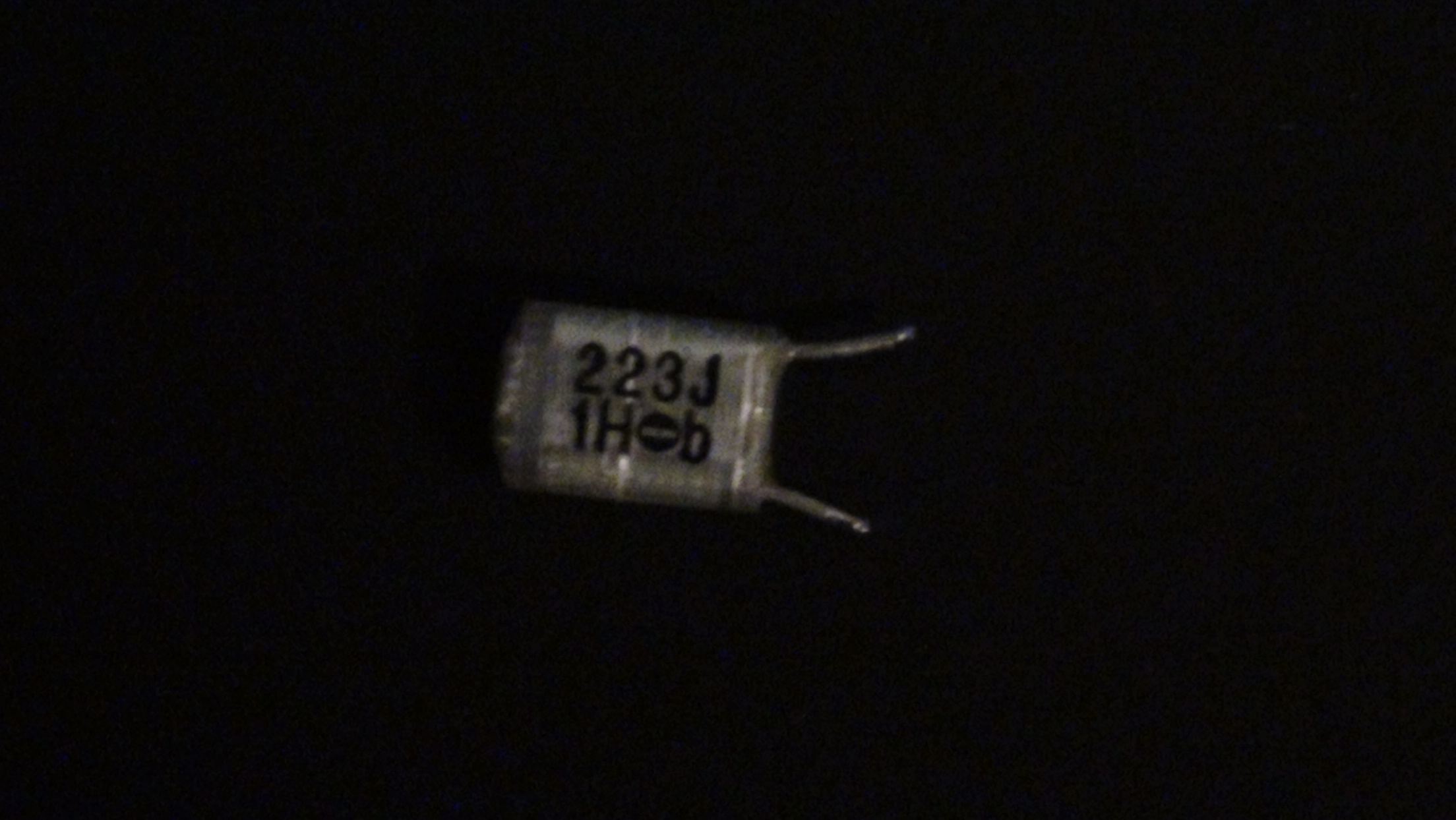

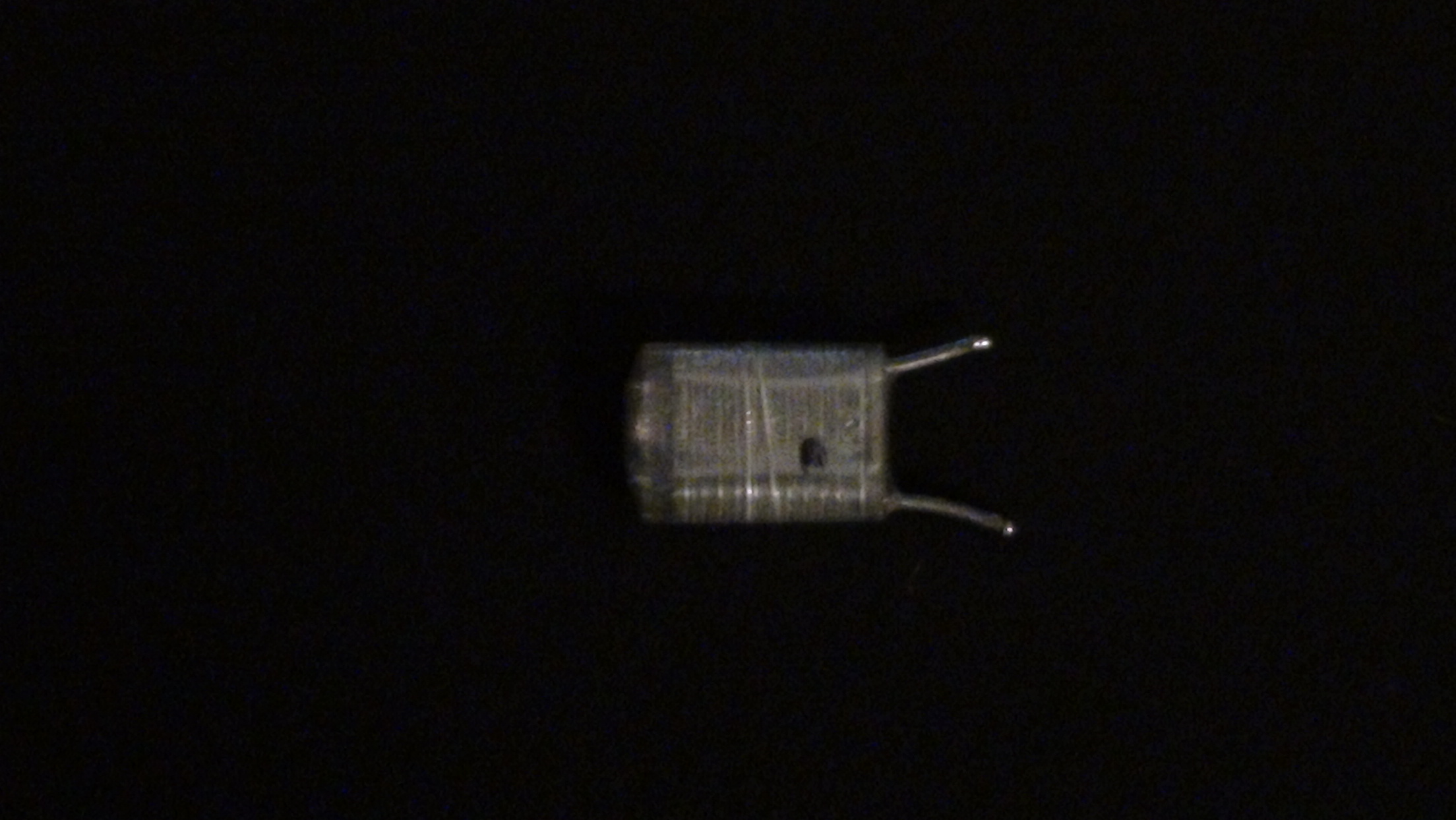

    Is this a capacitor?
    Hello everyone. I have a Ibanez Distoration pedal that I'm working on for someone. When the battery's plugged in, it works. When it's running off a transformer, it doesn't. I've checked the jack and it works and everything. Things that should read ground read hot with the transformer but not with the battery. Almost everything reads hot with the transformer hooked up. I'm testing components and wanted to know if this was a capacitor. I've never seen anything like it before. If so, can I test it with my ESR meter and is it polarized or non-polarized? The black dot is from a marker so I have an idea of how it goes back in... Thanks.

    Re: Is this a capacitor?
    yes, its some type of plastic film capacitor. 0.022uf or 22nf.
    The J indicates its value tolerance, 5% I think.
          Thank you rievax_60. My ESR meter won't test them. I have to use my DMM. Are they polarized? Not 100% sure which way the first one came out.
