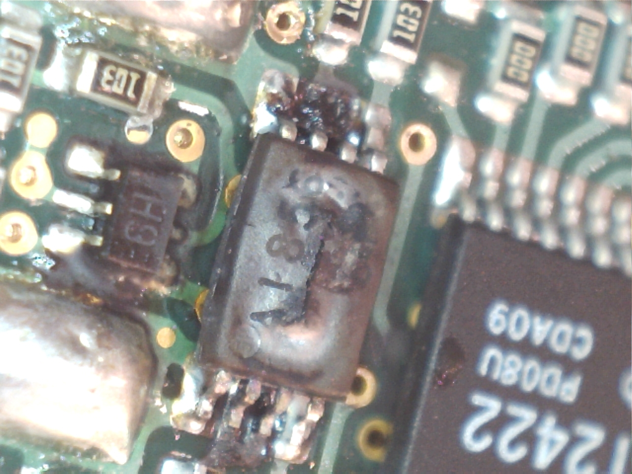

    Hi, I've go a futaba S9550 servo with a burned component.

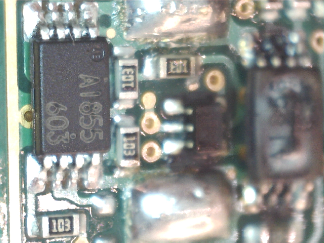

    There is a similar one next to it with the marking "AI855 603" or "A1855 603" But the burned one is clearly "856"
    Can someone tell me where I can get a replacement part?

    It's a µPA1856 P-channel mosfet.

        Thanks for the response.
        I've been trying to locate a spare but I'm unsure what I should look for in the datasheet to find a replacement.
        I know the pinout has to be the same but how about the voltages, can it be higher?

          Digi-Key has the IRF7750 which seems to me like it would substitute. Of course you need to verify this for yourself, but it would be what I would try.

            Thank you so much for your help.
            Got the chip today and soldered it on, first time soldering a chip this small so it was a bit of a challenge.
            Connected it to the rc car and it seems to work flawlessly but I wont be sure until I put it on the track.
