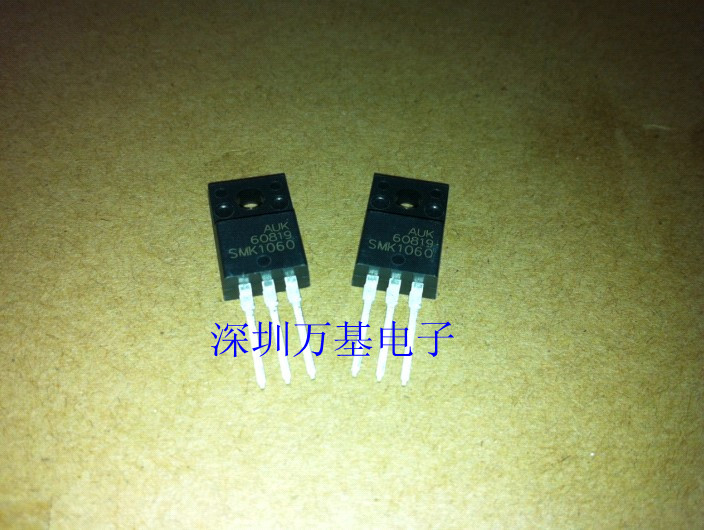

    I have two SMK1060 I would like to replace, can find datasheet, but no one selling them, does anybody know an acceptable replacement that they would sell on Digikey, it is used on a led tv power supply, thanks.
    Included a stock picture, but mine is 21914 not 60819 like it is in picture at the number above smk1060.

    You can use STP10NK60Z. Since those appear to be in an isolated package, you'll need the FP variant, so the complete part number you are looking for would be STP10NK60ZFP. It's a pretty common part. And yes, they do have it at Digikey: http://www.digikey.com/product-detai...2-5-ND/1039515

      Thank you very much, ordering from digikey now. appreciate the help.
