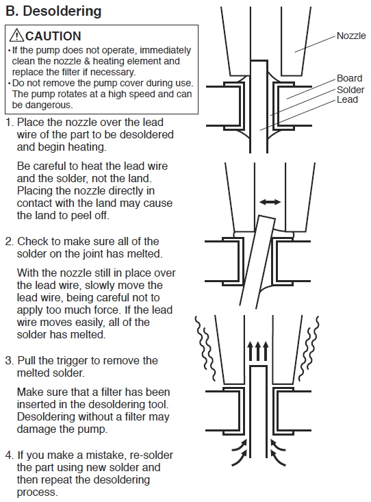

    I broke down and bought a Hakko 808 for desoldering caps from motherboards etc. I've found that for most of my projects the nozzle opening is too large and often doesn't even come in contact with the solder. The one it comes with is A1005. Which smaller nozzle should I get for use on a typical motherboard? I have no idea how large the heat pads (or whatever you call them. lol) are on these boards.

          The lead size on most caps is 0.4-0.8mm so a 1mm nozzle hole is fine for the larger ones, but maybe yours are 0.5-0.6mm (for 5-12.5mm dia caps). The nozzle (hole) has to be a bit bigger or else there's no room for suction. The A1005 is 1mm hole and 2.5mm OD so 0.75mm annular ring, seems ok. The nozzle "fatness" (annular ring, difference between OD and ID) needs to match the pad size. Is that where you are having trouble?
          If a nozzle is too big, I just use it pressed to the side of the cap's lead, not in the middle. Almost all the heat transfer is from the nozzle contacting the part's lead anyhow, esp. on multilayer boards.
          My technique is to put the nozzle gently on the lead, not mashing the pad, and wait a several seconds for the heat to flow through to the top-layer before hitting the vac.
          If it didn't work (i.e. solder still holding the part on the top layer), I re-solder the lead and re-do the vac.
          Sometimes while heating, I will gently push the nozzle to one side so you can feel it move once the lead breaks loose (then hit the suction!)

                I'd suggest you experiment and try a few things to get best technique, on a scrap board. People who have no luck with these are usually just impatient, too quick. There is some art to it.
                For multilayer pcbs, crank the heat to 5 and wait the recommended 5 minute warmup. You might be using too low heat.
                Wire-brush the nozzle to make sure the suction path is clear.
                Put the nozzle on the lead, offset like the pic shows. Heat is transferred from the nozzle to the part's lead (not the pad!). Even if the lead moves, wait a bit for the top-layer to melt good and then hit the suction and wiggle a bit.
