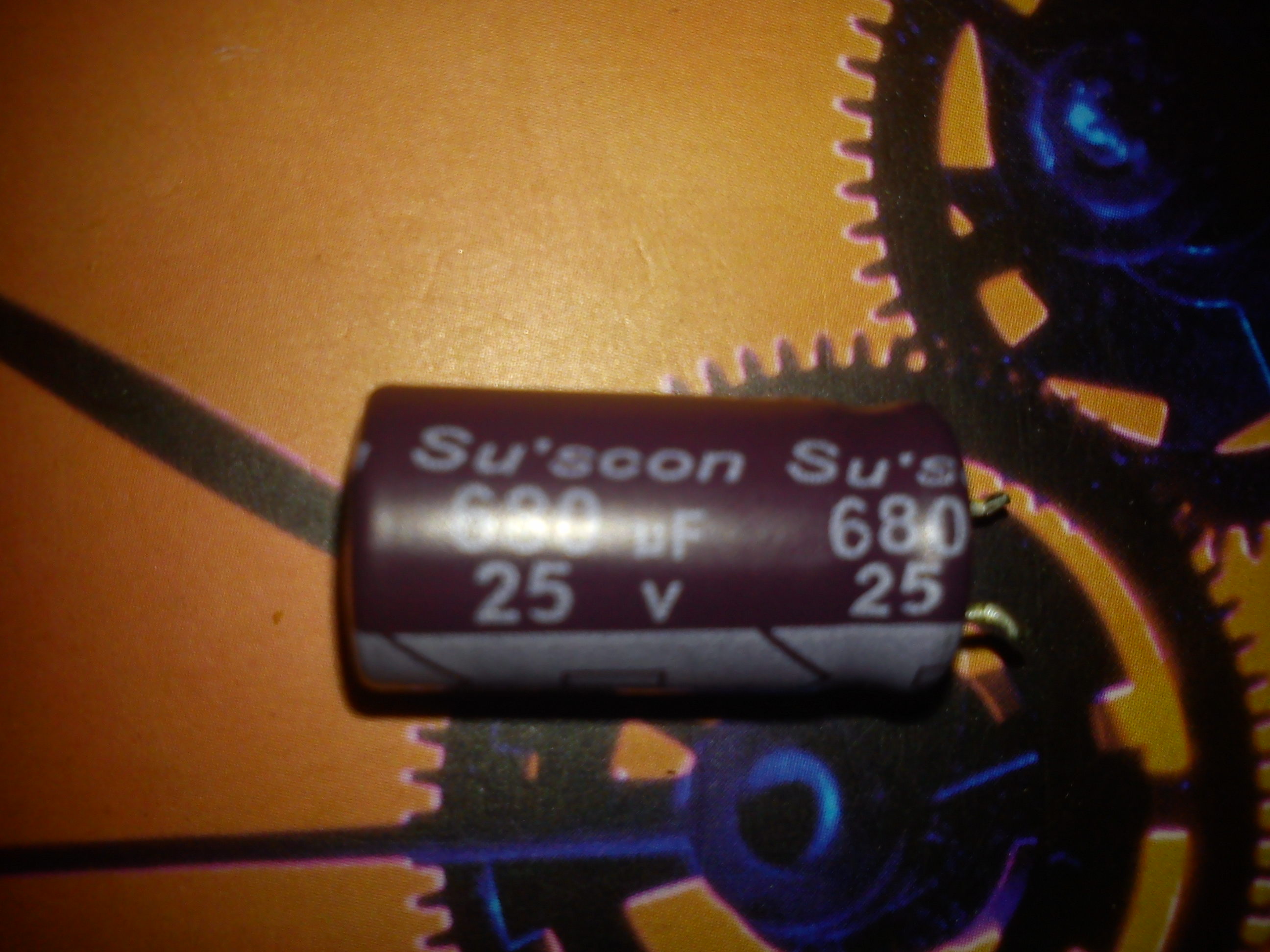

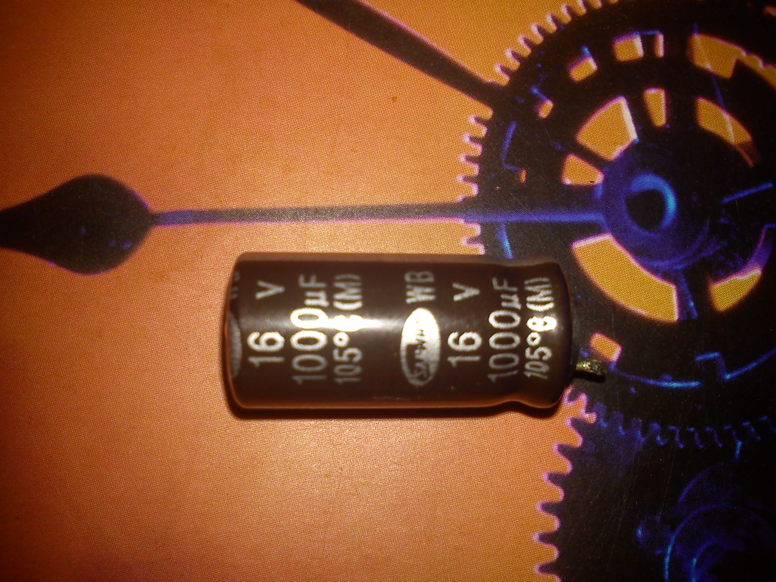

    Hi people. I have another bad PSU this time it seems like some of the caps are bad. It's a LG monitor.
    I'm still learning so I need to ask a this.
    There's 6 caps all near each other 4 are Suscon 16v 680uf 105 and 2 are Panasonic caps I think.
    I'm still not sure if I need to find an exact replacement or not, obviously they have to be the correct v,uf, temp range but do I need to source exact replacements.

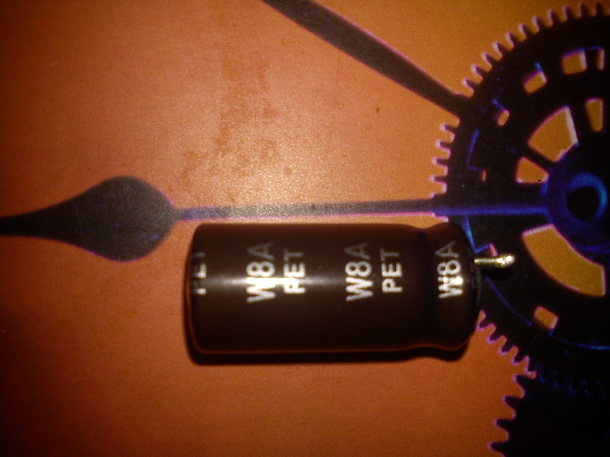

    these have an (M) and also pet on the side which I beleave stands for polyester?.
    I'm unsure about the 2 with pet on the side, is it super important or not.

      PET =Polyethylene terephthalate the substance the plastic coating is made out of.

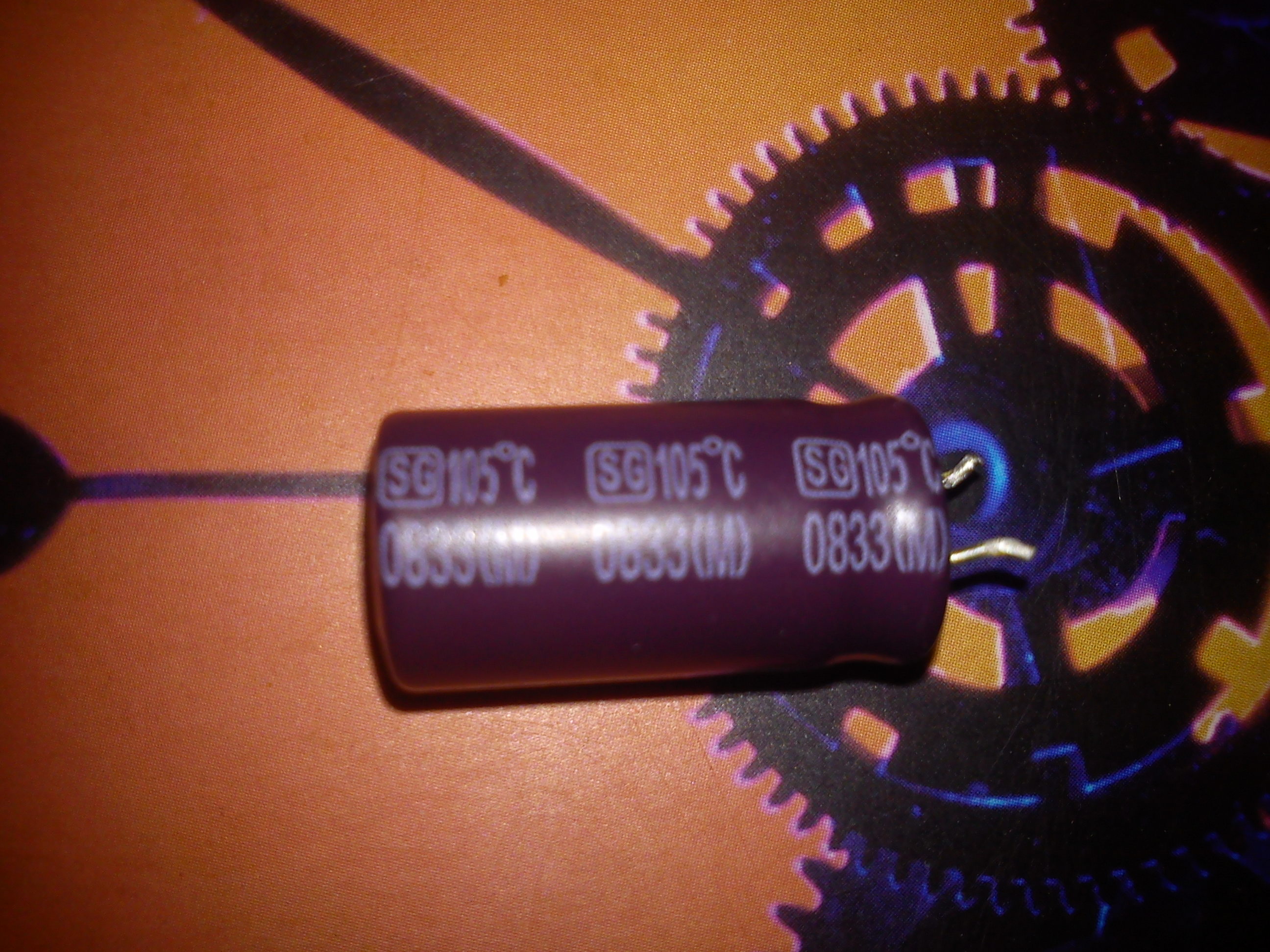

        Thanks for the reply's, yes PET =Polyethylene yes that's the one. So there's nothing special about these really. I also notice someone mentioning suscon as being rubbish.
        Here's some pictures hopefully they will help, the size of both are Hight 20mm Width 10mm
        The first 2 pics front and back there are 4 of these
        The 3-4 pic front and back there are 2 of these.

          Ok, so they're not Panasonic.
          They're
          * Su'Scon SG :
          * Samwha WB: (page 32, WB is discontinued... Samwha recommends to use MK series instead)
          Replace with capacitors with >= ripple , <= impedance .. basically Panasonic FR, FM, FC like selldoor said would be good.

                mariushm posted much of this, but "translating" ...
                Su'scon: Probably the SG series; made in the 33rd week of 2008; M = +/-20% tolerance
                Samwha: WB is probably the series; M = +/-20% tolerance; W8A is the date/lot code; PET does seem to mean polyester, possibly referring to the sleeve (major brands switched from PVC to polyester sleeves in their RoHS-compliant parts, so PVC may in some way be politically-environmentally incorrect)
