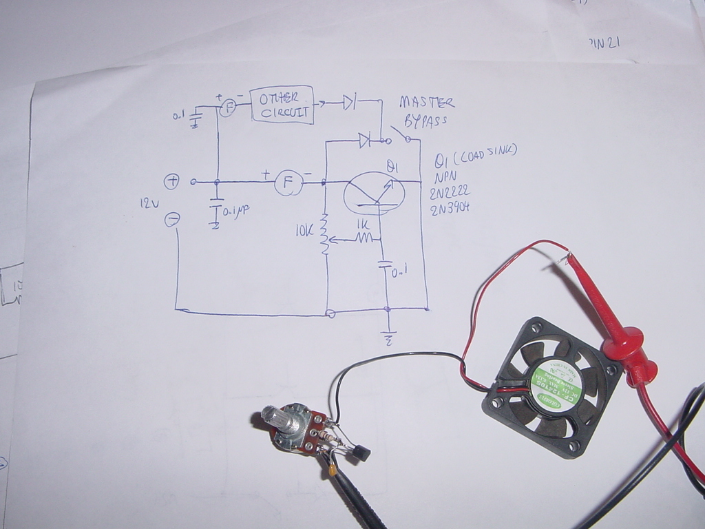

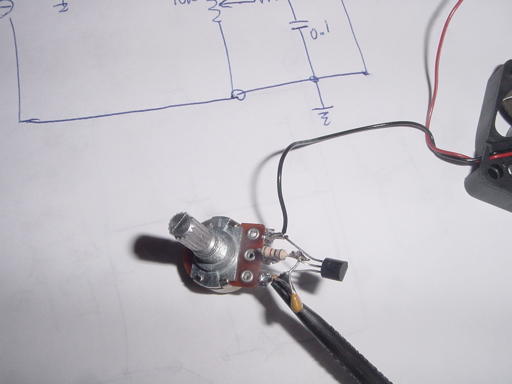

                Here is another minimum part counts circuit with low side controller (sink) instead of sourcing (High side drive) with Master bypass switch.
                I show proof of concept in the pictures.

                  Re: Potenciometer for fan regulator
                  Would like separate bypass switch for every fan and on/off switch for every fan, which both takes some space :-) Components on board are not problem, but ATM a guy wants six-channel controller into 5,25" bay…
                    Well on/off switch can be on the pot, that will eliminate 6 switch on the panel. so you will have 6 pot/switches, 6 bypass switches.
                      Interesting, didn't know these small pots with off switch. I think I can get some around here. And as long as this scheme of yours actually regulates outcoming power, having infinite resistance on base means transistor is closed, nothing going through. Hmm, seems nice :-)
                      As for fans, I have actually measured some and there is no strange volt-ampere characteristics going on when having it on low voltage, current goes down as well. Together with placing termistor in front of the fan, it whould be safe to mount like 20 fans on output (considering typical 150 mA power drain and 4 A transistor). Also depends much on used fans, but I mean like, it's just if somebody mounted more fans to one output than it is healthy, it should still survive, yes? Termistor would eat all the starting motor spikes so you could really connect many fans.
