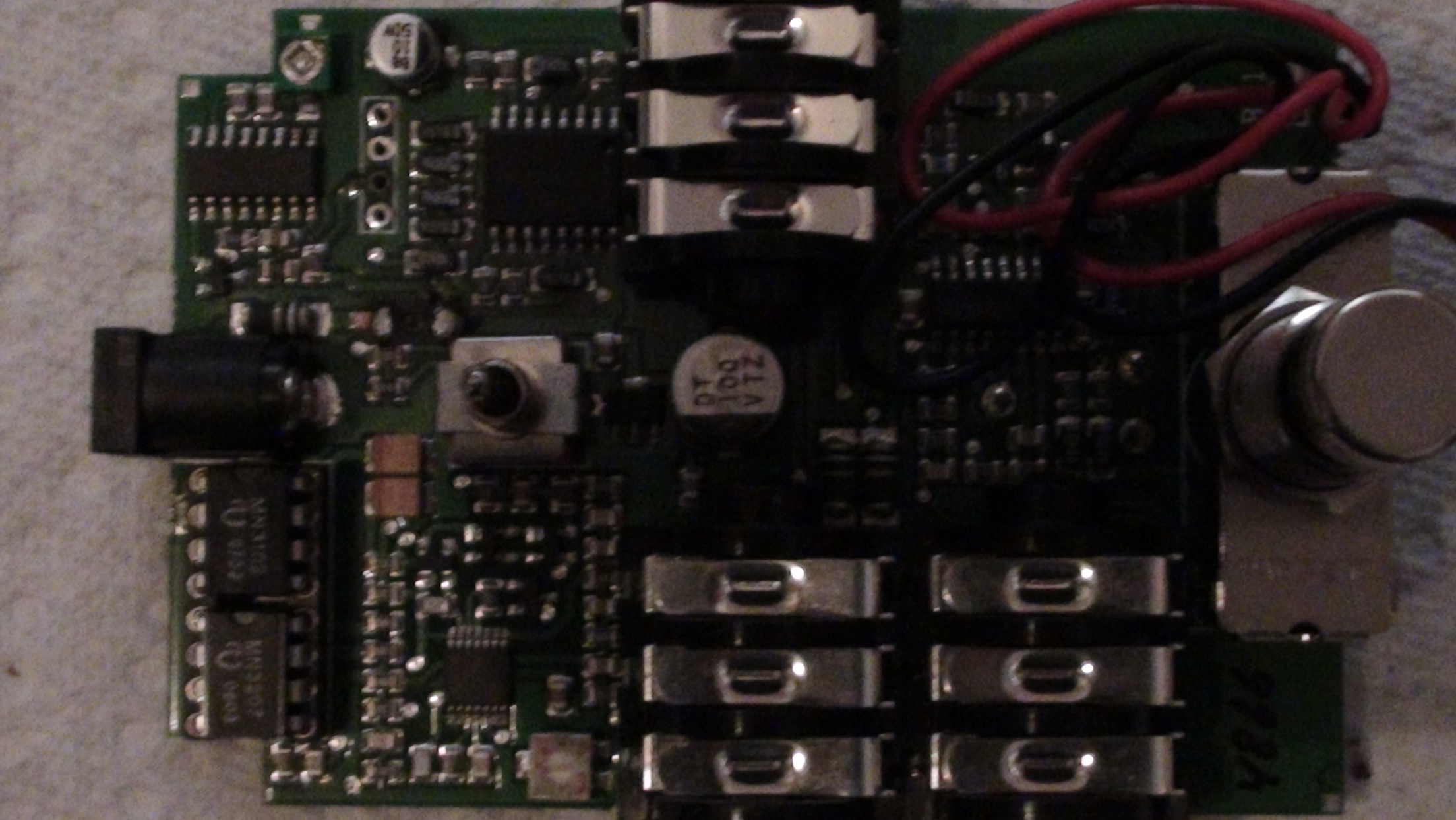

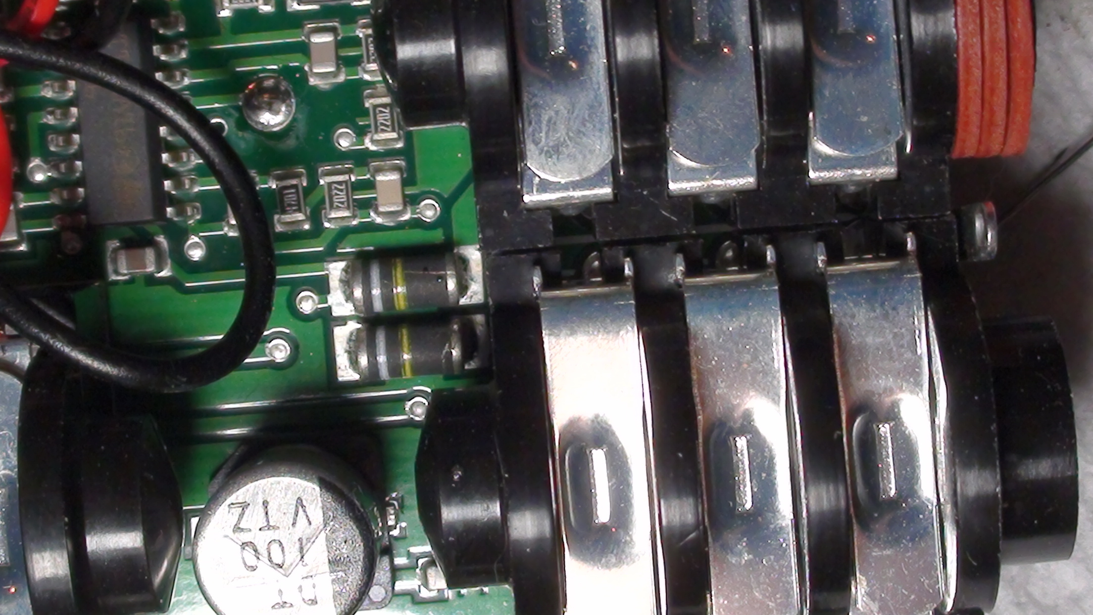

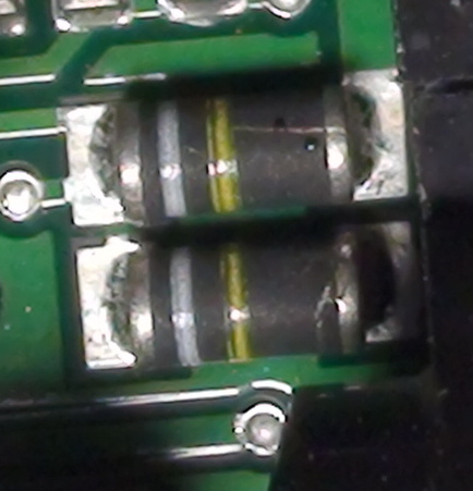

    Hello. I am working on an effect pedal for a guitar. I wasn't sure if I should of posted this in the audio troubleshooting / installation forum or here. I figured since I don't need any help in troubleshooting what's wrong with the pedal, I would post it here. I apologize if this is in the wrong place.
    The owner used a transformer that was rated for a higher voltage than the pedal needed. He fried a component on the PCB. The fried component kind of exploded a bit and burned off all the markings. After spending some time, I've come to the conclusion that there are three other components of the same type on the board. I am having trouble identifying them.
    They are blackish in colour and have a white and yellow band on them. I believe that the white band might be the cathode side and not a band per say. If I test the working components as diodes and have the black probe on my DMM on the side with the white mark, it shows a reading of some wheres around 5.6 Mohm's. If I switch the probes, I get O.L.
    Can some one help me identify these and perhaps find a place that sells them? I cannot find anything on the net. I am attaching a picture of the components. Thanks.

    Can you include a picture of the surrounding area? Maybe there are reference designators that might give an indication of what they are...

          You could try that - id agree that they are diodes and as you say the white ring is probably the cathode. The markings on these are not standardised so unless you could find someone with the same unit its almost impossible.

            I want to say its some sort of heavy duty zener diode or a 1N400X series in an SMD package.
            I have seen the 1N's in that package, perhaps the yellow band is a voltage rating?
            Yank em off and do a reverse voltage test on them.

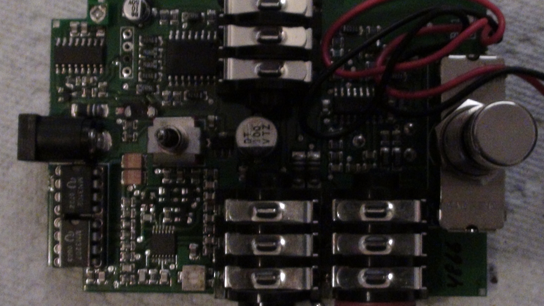

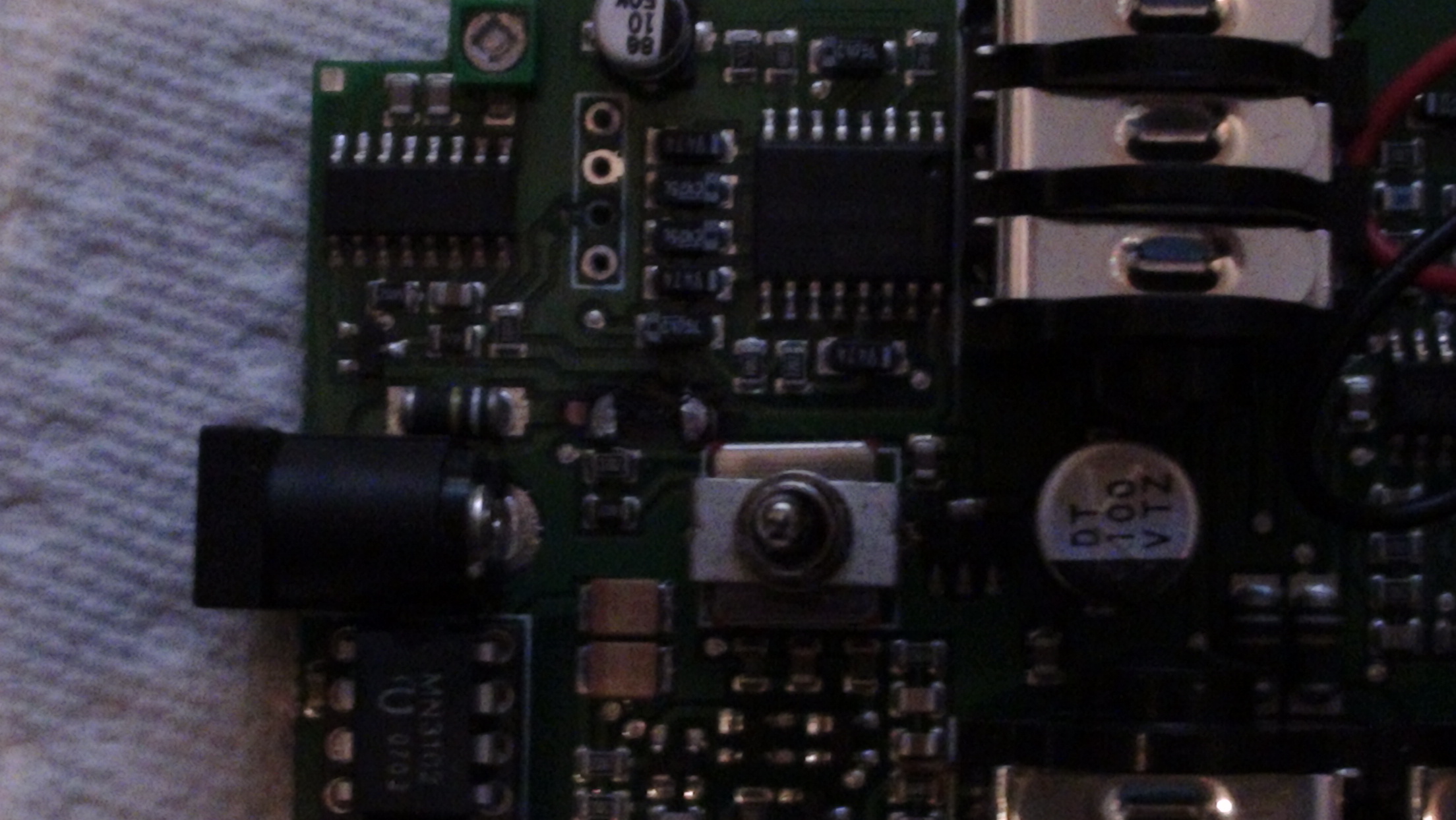

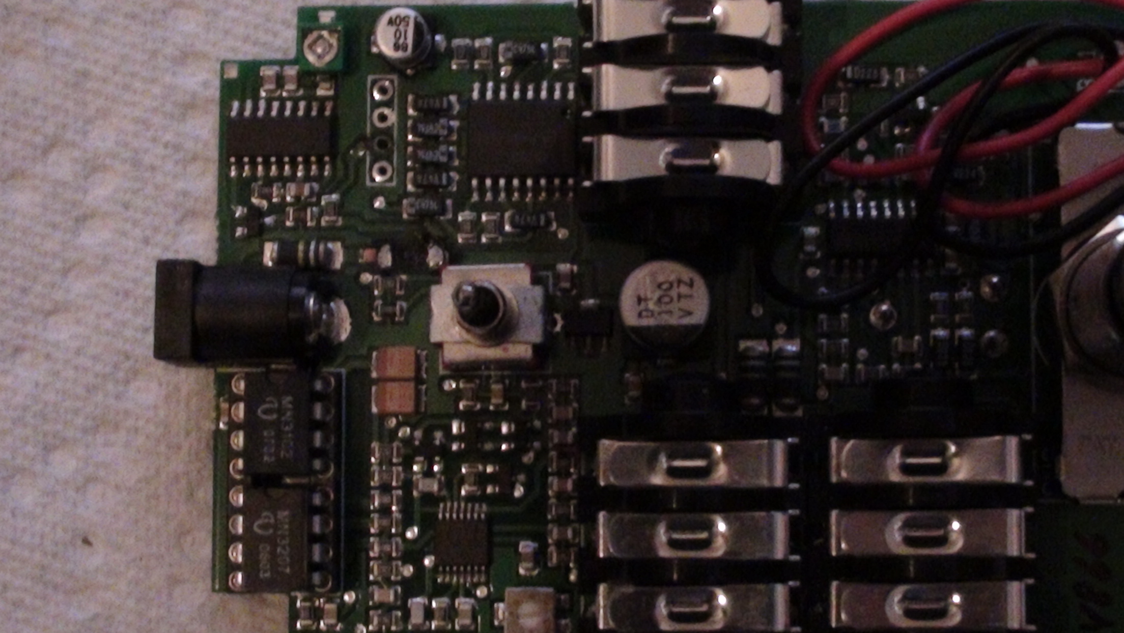

                    Here are some pictures of the board. I've included a semi-close up of the area where the burned part was. I have unsoldered the bad part from the board.

                        Is the band side of the same type of diode by the DC JACK connected to the center pin of the DC jack? So it has 3 same type of diodes on this board. The pictures are not clear enough for me to see the burnt section.

                          I do not believe the band side of the same type of diode by the DC JACK is connected to the center pin of the DC jack. I used the Ohm function on the DMM and it shows O.L.
                          There are three of the same type of diodes now. Four if you include the broken one. I can only assume the burnt one was the same component as the other three. It's burned too bad for me to be certain.

                            Re: Help identifying a SMD component.
                            Maybe
                            white-yellow
                            BYM 10-400
                            http://www.vishay.com/
                            search GL41G
                              http://www.ebay.com/itm/50-SMD-Diode...-/280723441133
                              I think we have a match.

                                Wow Duncanbest - pretty impressive - did you know the Vishey Diode colour band codes - how did you find it. I tried a few searches on colour bands diodes etc etc etc but came up with nothing. Well done.
                                  Great detective works Duncanbest! He can use 1n4xxxx series.

                                    Thank you guys so much! I guess the owner of the pedal decided to purchase a new one and said I could keep the old. I don't play guitar, I've only fiddled with one back in the day. I have friends though that play. Maybe I can fix it and sell it to them. Would any 1n4xxxx series diode work? Or should I find one with a 400v / 1A rating? Thanks again! I searched for a long time on the net and couldn't find anything!

                                      Yes, you'll need to find a replacement with at least 400V and 1A rating. 1N4004 seems to be OK although it has slightly higher thermal resistance.
                                      You might want to think about why they decided to use that Vishay part over a 1N4004...
