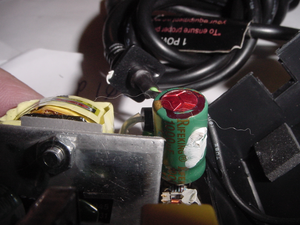

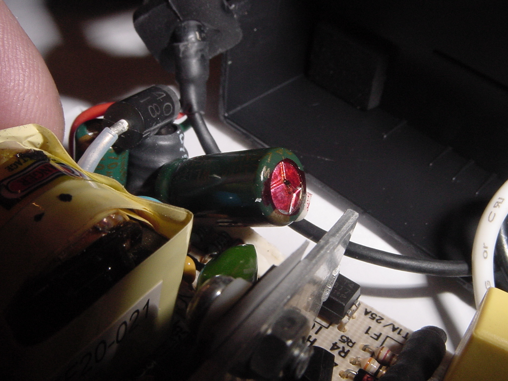

Failed 2WIRE AC adapter

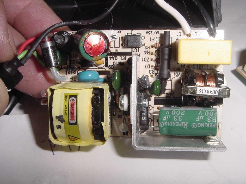

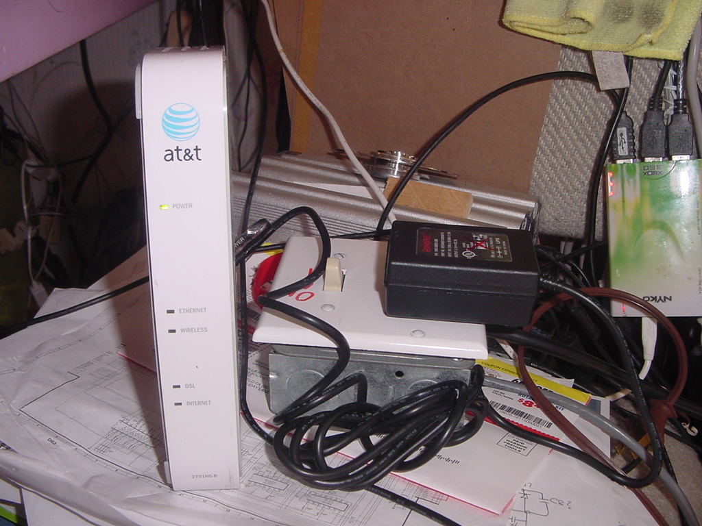

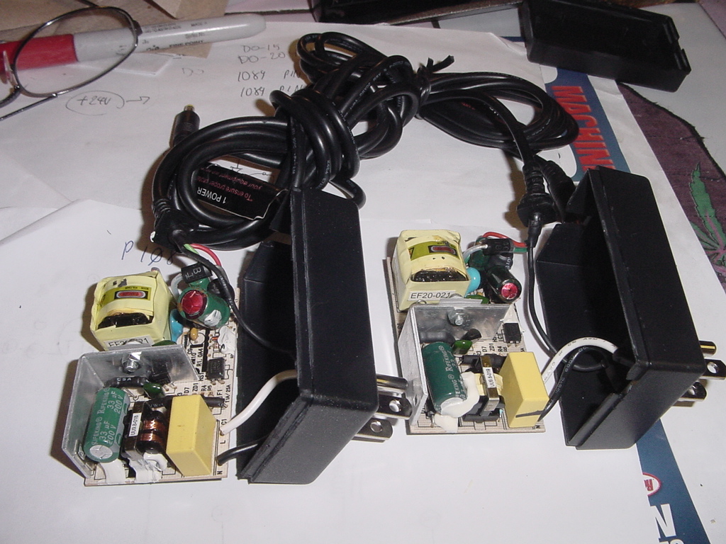

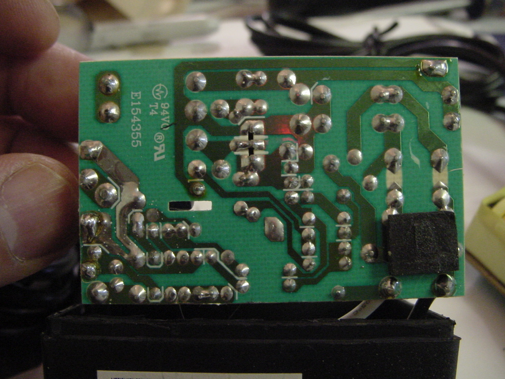

    Bad caps. The output shows 5V no load, 3.6V when hooked them up to the Modem/router.

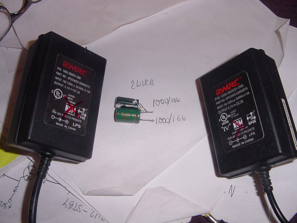

    It goes to show that by changing to 16V cap from 10V cap will not fix cheap cap problem that will fail anyway.

      Wow, great pics!
      LOL, 'Rifeking' another bad-cap mfg to add to the list!
      What year was this made in?

        The Modem/routers were acting up with intermittent drop out, etc.

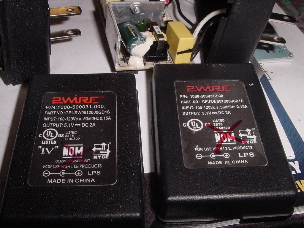

        Date code as stamped on the body are
        One is 0720ND, and another one is 0526NC.
        I use PANASONIC FM series, 1000uF 10Vdc.
        I did not replace the primary side cap, want to see how long it will last.

              as someone who did house calls for two years, let me say its ALWAYS those damn 2wire adapters for the grey/white routers. I've seen about 10 of those damn dead things. They build them shitty so at&t can make money selling the customer a new router, unless that person is renting it

                      i see plenty of these adaptors needing recap.
                      rifeking LOL.
                      one of the early bad cap brands.
                      must be really old stock that didnt get pitched.
                      did one a few days ago and it had rifeking.

                        And it's the new version that is a little bigger and has an extra 0.1A rating

                            Yup, cheap caps are cheap and will fail. The only thing worse than that is overworked cheap caps as is the case with this adapter. Then again, it's a 2-transistor self-oscillating design... obviously this adapter was designed and built as cheap as possible.
