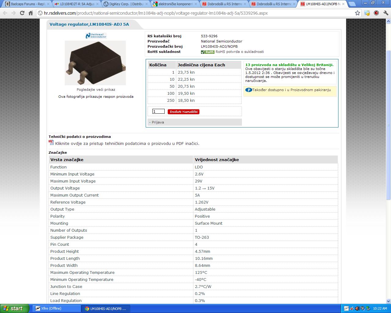

        • SmartVision
          • Jun 2011
          • 58
          Re: Regulator replacement
          What about this one :
          http://hr.rsdelivers.com/product/nat...a/5339296.aspx
          If you cant see the link look at the picture.
            Hi - I dont think you can go by what is in the photo on the rs site- it does say -Ova fotografija prikazuje raspon proizvoda
            Looking at the one you are suggesting it has 4 pins not 3
            and is a lot bigger
            I have re formatted the description - I think the differences are too great.
            Function LDO
            Minimum input voltage ?
            Maximum Input Voltage 12V
            Output Voltage 1.25 → 15V
            Maximum Output Current 5A
            Reference voltage ?
            Output Type Adjustable
            Polarity Positive
            Mounting Surface Mount
            Number of Outputs 1
            Pin Count 3
            Product Height 2.4mm
            Product Length 6.6mm
            Product Width 6.2mm
            Supplier Package DPAK
            Typical Quiescent Current 3mA
            Function LDO
            Minimum Input Voltage 2.6V
            Maximum Input Voltage 29V
            Output Voltage 1.2 → 15V
            Reference Voltage 1.262V
            Polarity Positive
            Number of Outputs 1
            Supplier Package TO-263
            Pin Count 4
            Product Height 4.57mm
            Product Length 10.16mm
            Product Width 8.64mm
            Typical Quiescent Current 5mA

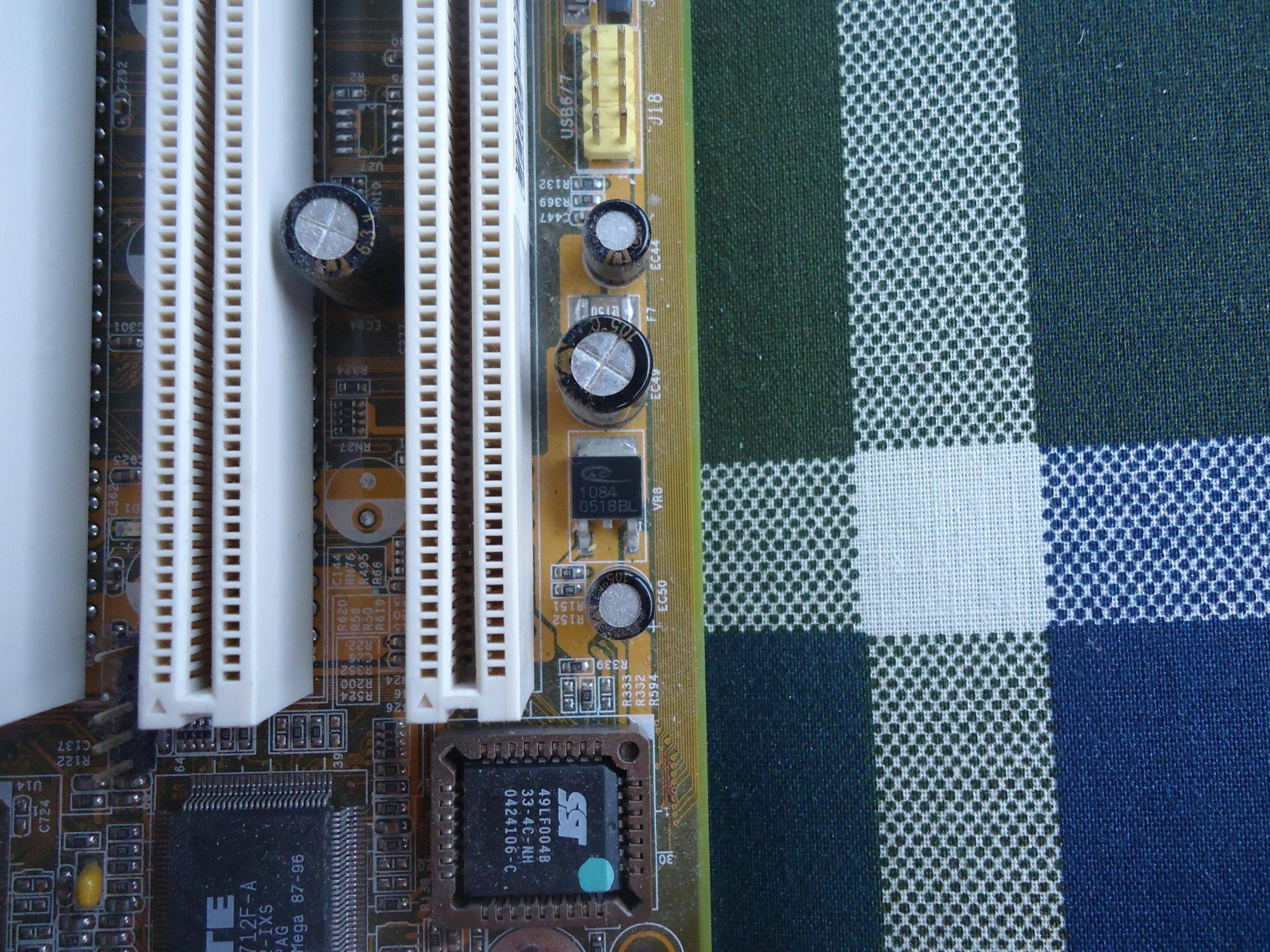

              • SmartVision
                • Jun 2011
                • 58
                Hi again
                I may found one regulator that might work (on old motherboard) , so can someone check it for me if its not a problem
                Look at picture.
                  "Ova fotografija prikazuje raspon proizvoda" <- This photo shows the range of products
                  It's serbian, not my native language but I think the translation is good. Anyways dunno much about VR's but the logical step to take is to search for the same exact part on another junk mobo, dunno if that one on the picture is but if it is the same part number should do ok.
