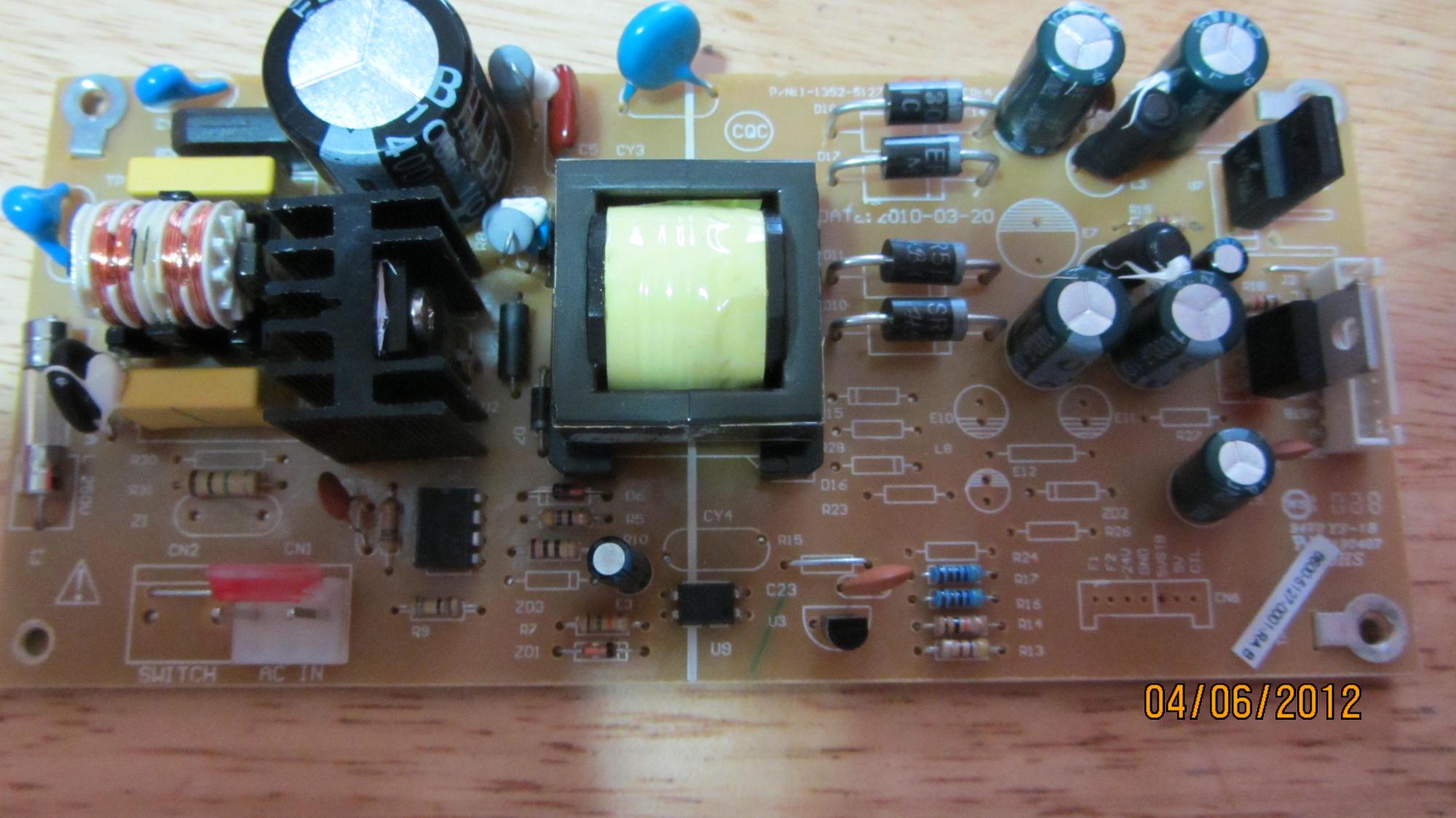

    I will include a picture of the PSU just for reference in case it helps.

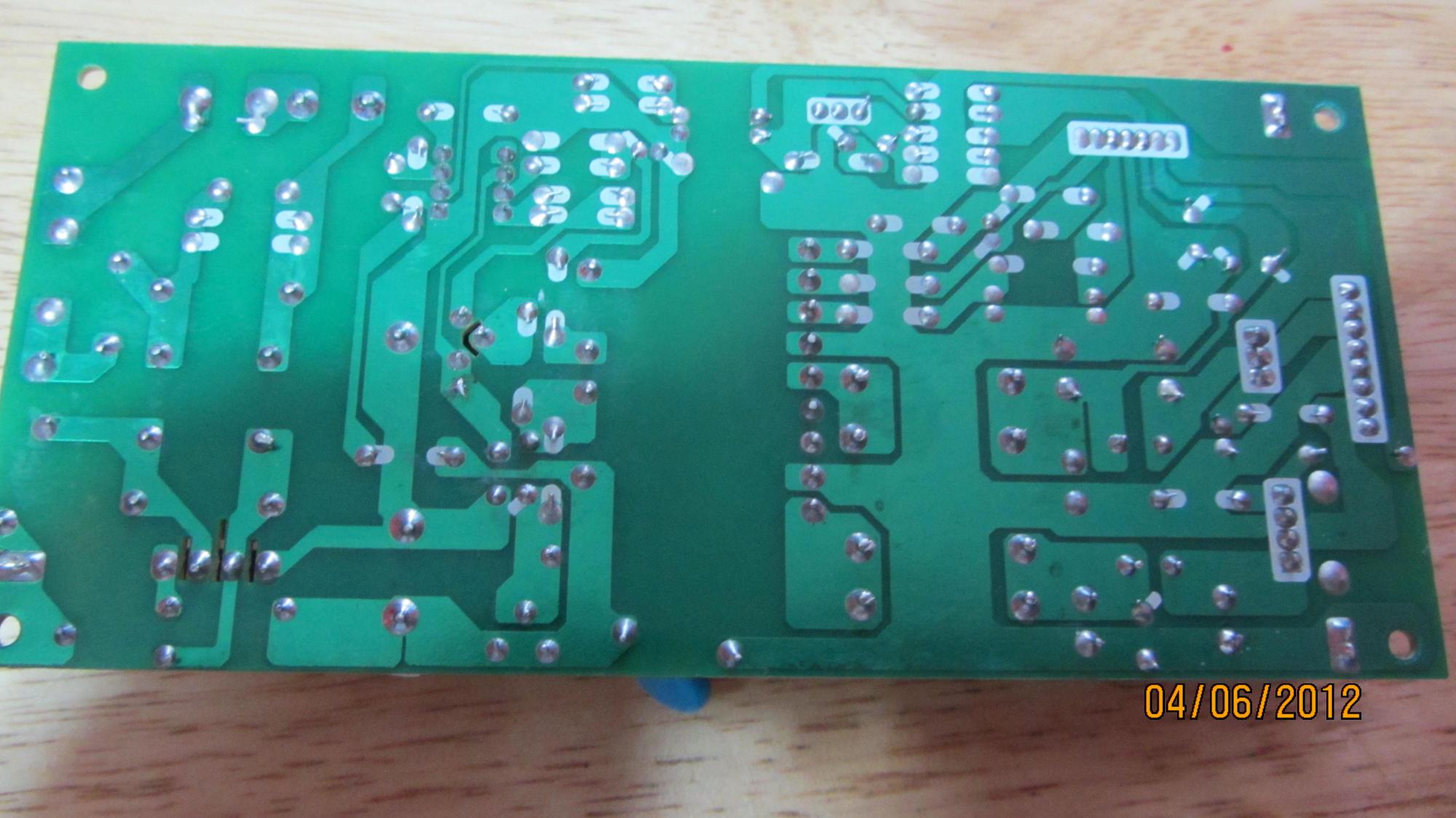

    picture is not big enough can you get it to just less than 2mb and also post one of the back of the board
    Re the green caps Teapo or what.

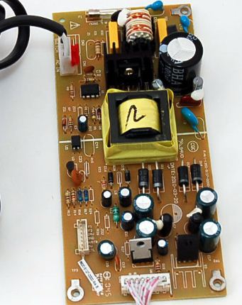

      Agreed, larger pic would be nice and is that a picture of YOURS or only an example pic from someone else? Basic method would be checking whether the output rail voltages seem to be stable and in the range what they are connected to would need... with and without the load(s) connected.

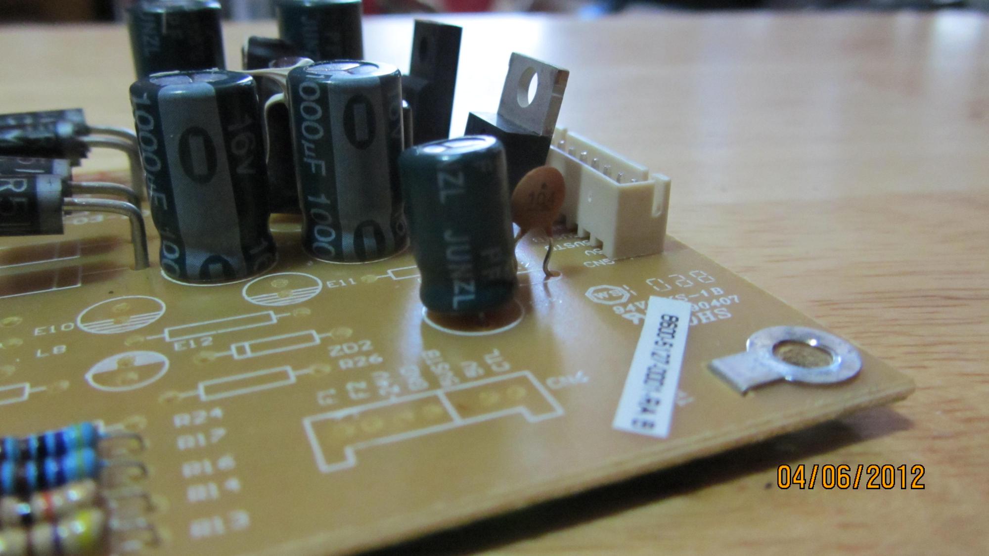

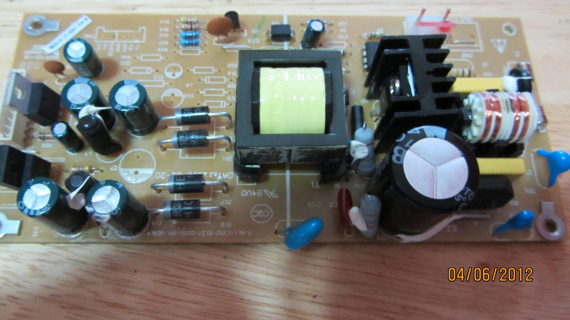

        OK got out the good camera and took some pics maybe this would help.

          @999999999 - good spot. not his board then!
          @infringer - so what make are the caps.
          Duff high ripple caps might make the transformer noisy.
          Test the voltages as 999999999 suggests and post the results along side
          the expected results as shown on the board.
          EDIT haha JUNZL - never heard of them
          What is the big cap

            Big cap is 100uf BHA Y style CDT03 rated at 105c hrmm so how often do inductors go I guess I am having troubles pinning exactly where the problem lies upon visual inspection all fuses on the main board and the Power Supply seem to have continuity and none of the Caps look like they are in bad shape. But I will have to get out the LCR meter to check for sure I just figured there might be a problem area that would be simplistic to start at without having to go through everything being that there are some old timers with a knack for this stuff on this forum. I'm learning I hope to be able to find them problem areas quickly in due time but for now my hunches are newbieish.

                Cant find anything at all on BHA caps- Id suspect as poor. Unless you have an ESR meter testing the caps will not prove much unless you find one thats shorted.

                    it was the power board there is a 4 pin component next to the transformer that goes and takes out the big capacitor on the board...

                      ^ What? The only 4 pin component I see next to the transformer is an optoisolator, I'm not seeing how its failure would take out a capacitor nor how the cap would be taken out but not have vented or exploded.
                        Re: Insignia BRDVD4 powers on with blue light blinking then shuts off.
                        Yeah, that does not make sense, the large cap is exposed to the rectified DC from power line by the bridge and could not careless what happen to the OPTOISLATOR for the feedback circuits to maintain the output voltage.
                        Unless he meant the Bridge rectifier (4-pin) next to the Common mode line filter choke.
                          I've had a shorted bridge take out a cap, but only on the second time round (after replacing the fuse)... the first time it seemed to have survived.
