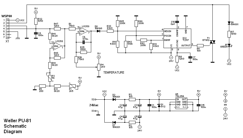

            Re: "Upgrading" a Weller WECP-20?
            Found a schematic of the Weller PU-81, but no success on the 80.
            • DMCrimson
              • Feb 2012
              • 58
              • Finland
              Looks like I need to do a comparison on the pcb against that. Any info on the transformer?

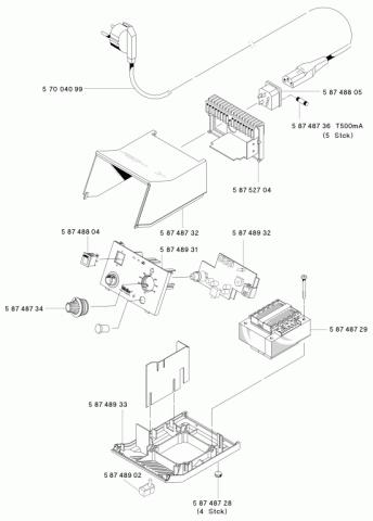

                Soldering irons don't run 100% duty cycle, you can under-spec the transformer i.e Weller PU120T (for WTCPT) is a 60W unit with a 40VA transformer.
                I am confused with the part numbers we are talking about
                WS 81 - 80W temp. controlled soldering station set (240VAC mains)
                WS 81T - 80W analog temp. controlled soldering station set (240VAC mains)
                PU 81 - analog temp. control power unit (base PSU)
                WSP 80 - soldering pencil
                The part number: 810 87487 29 TRANSFORMER 230/24VAC 80VA
                So it looks like an 80VA transformer is used. Run the 50VA one you have and see if it runs too hot.
