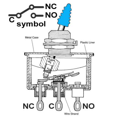

        So the voltage is only showing on the first pin of the switch (The shortest one). The way I understand how this switch works, is that when it's switched on, it jumpers the first and second pins together, and the second pin passes on the voltage to the rest of the PCB. So should I just jumper the shortest and middle pin to see if the switch is broken?

          Re: How do toggle switches work?
          I included a image to help you visualize.
            Ah, beautiful... So it is just jumpering... So as suspected, since the second pin is getting no voltage in the ON position, the switch is probably dead...
            Question... Why have a third "NO" pin for OFF? Why not just leave it not jumpered? Is this for continuity of ground when the AC Adapter is plugged in and it is off?
              I believe they connect the unused pin to The pcb for support as for them been connected together more pad = more strength.
              As far as I can see it has no other benefit.
                    QUOTE=mockingbird;195649]Great... Newark seems to stock these switches... Now it's just down to getting the exact same one... Ouch, $5 for a switch?[/QUOTE]
                    Ususally the sliding/rocking contact gets fouled with gunk or fried from arcing.
                    Depending on the switch's size and if you can't take it apart, it's best to pay $5 and save yourself some trouble.
                    Or, you could scavenge/recycle a switch from something else.
                    P.S. Just seen the datasheet for your switch. Epoxy filled = toss when broke
