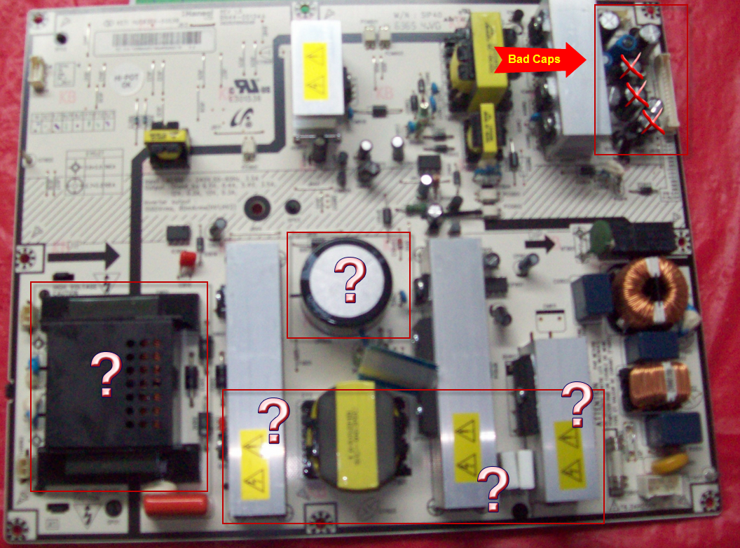

    I have been trolling and reading the forums here for a few hours and trying to figure a few things out.
    1. How long for the specific capacitors on my board to discharge?
    2. Good SAFE method to discharge said capacitors.
    3. SAFE procedure that will prevent a SHOCK to me or the board.
    I have read around and feel 100% confident that I can solder and replace the caps just need to learn more about the specific caps I see and need to replace.
    Like most people on the boards my bad caps are the ones situated in an assortment of 5 near the power supply area. They are each 1000uf 10v. How long after being unplugged will they be safe to remove? What is a good method to discharge such a rated capacitor?
    I also have noticed a MUCH larger capacitor in the middle of the board that is a 400uf 350v. This is the one that really scares me? How long to discharge? and best SAFE method to discharge?
    I have NO idea about the electronics portion of this project. I have fixed other small solder issues in the past but REALLY want to avoid a shock of any SIZE at all costs.
    I want to educate myself with the proper knowledge and tools before removing the board and frying my finger.
    TIA,
    Jason
    TV: Samsung LNS4051/XAA
    Purchased: Oct '06
    Symptons Started: 5/11
    # Bad Caps: 3
    Bad Cap Ratings: 1000uf 10v
    You will see in the attached picture the bad caps as well as components that I have questions about that are marked with "High Voltage" warnings.

    The 10v ones won't hurt. (10v is not high enough to make any significant current go through your skin.)
    The large one is primary-side and will hurt, a LOT, if you touch it. It has up to ~340V. Measure the voltage on it with a multimeter, discharge if it's above 30V with a resistor (5W, 10-20K). It'll probably discharge on its own though.
        Depends. Essentially, how much juice (uF-V) and how much load (R) for the juice to pour into. It's right up there with the "RC Time constant". If there is no load, then you're talking about the self-discharge (leakage) rate, which for some serious caps, can be months.
        Through a high-enough (use Ohm's Law) resistor. For safety's sake, use the voltage rating on the cap. For a typical input filter, we'll use 450V (the uF value only matters for how long we'll be appying the resistor to get it discharged). We'll also try for a safe current, say 100mA or so. Now, plug that right up in there...
        R=E/I --> R=450/.1 --> R=4500 ohms (closest value is 4700).
        Now, for the wattage...
        P=IE --> P=.1 x 450 --> P=45W (Whoa!)
        Not many of us have a 4700 ohm 45W cement block lying around (I don't), so all we have to do to bring this down is ramp up a factor (or two). So, let's make that a 45K resistor, which will bring the current down to 10mA, and the wattage at 450V will drop to 4.5W (much better). So, a 47000 ohm 5W resistor should do the trick. Factoring again gives us 470K .5W, which is even better, as even I've got some of those in my spare parts.
        After getting your value/size, just run some alligator/hook clips to the leads of the cap(s), and measure with the DVM until it reads zero.
        Will Radio Shack have said resistor if I need it ? TV has been unplugged for almost 24 hours now, so hopefully its discharged.
        Maybe, if you do the math right. A pair of 1Meg .5W twisted in parallel will give you a 500K 1W equivalent - just about right! RS should have those.
        To measure with a multimeter (which I have) I just need to set it to a reading level and touch the probes to the bottom solder connection points?
        Yup. Most DVMs use "Auto-ranging", which means you click the dial to "VDC", and touch your probes/clips to the cap's leads. If you have an older style DVM with range selection (two dials, one for measurement (AC/DC/Ohms/Cont/Diode) and one for range (2-20-200-2000)), then set it to VDC AND set it to the highest range FIRST, and work your way down (saves having to change fuses all the time).
        Well, you could solder leads to your resistor, shove it into a non-conductive tube (PVC pipe?), run the clip out the back end, and use the lead out the front as the probe. Clip to ground, probe the positive, wait, test voltage, probe again, wait, test, ad nauseum...
        Since these are the output caps on the SMPS, these are usually tied to a load already (most SMPSs need to "see" some kind of load to even start up), so they tend to discharge really quick (a few seconds). It's those (as Monty Markum said in the movie "Midway") "Big Bastards up front" you gotta watch out for. This is because the load is switched in/out by the MOSFET, and if the supply is turned off when the MOSFET has the charge still in that cap(s), then it doesn't see much of a load, and waits for you to come sniffing around. If that MOSFET went *poof*, chances are good there's no charge left.
        What about the other areas of the board with the "?" once the "big one" is discharged we should be good?
        Maybe. Use your DVM to make sure.
        Also I have read that when replacing I should up the voltage a little on the caps (10v -16v) is this good thought? Should I replace with same or slightly higher?
        That, my friend, is a 55-gallon can-o-worms you're opening up. I was taught that the designer should allow for 150% of rating, minimum. So, if my circuit runs at 12V, then I'll design it using 18V caps as minimum. Since I don't see any of those at Digikey, I can go a step up (25V), or cross my fingers and use the 16Vs. Now, if you're the poor SOB fixing what I just under-engineered, then you might want to use the 25V and send me an e-mail telling me how much better you are than me. IF I gave you the room to do it, as the 25V cap may be quite bigger than the 16V, and won't fit. In that case, I'll just politely give you the finger. If I use Teapos or L-Tecs, I'd be using both fingers.
        So, the short answer (too late!) is to up the voltage if it'll fit, keep the voltage if it doesn't, and stay with the same uF rating if at all possible (+/-20% is okay). Lastly, try to keep within the same type/family/series (e.g., KZG, FC/FM, MBZ, etc.). If you're not sure, ask.

          Believe it or not, I forgot something...
          All those High-Voltage! warning stickers? They're there to warn you that the HEATSINK is attached to the tabs of the mounted components, and that they may be at a high-voltage (I was taught anything over ~50-75V) potential while powered.
          So, don't touch the big metal "radiators" with your fingers, or use them as ground points for your DVM or scope, while plugged in and you'll be fine.
