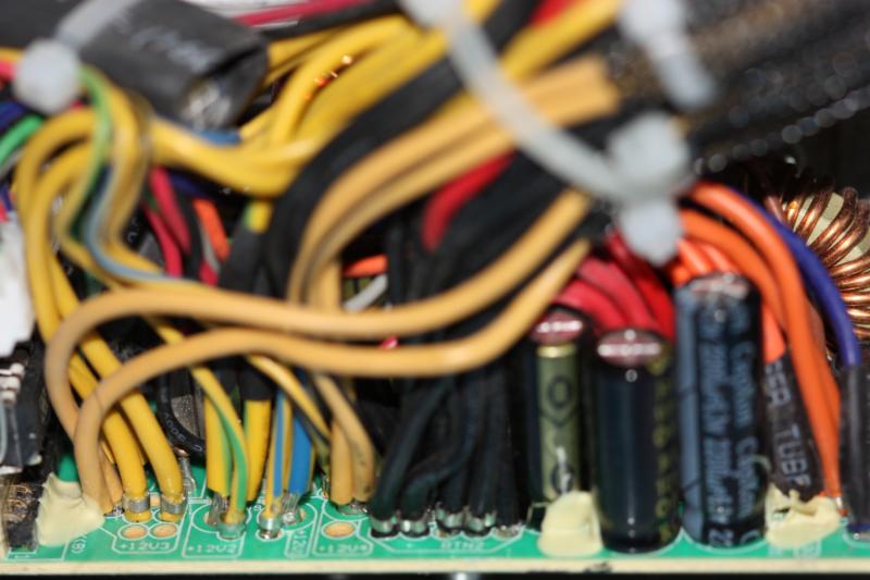

    Hey everyone.
    I have been reading though this forum for the past week. I'm very impressed by the community. I'm still very new so I apologize for my ignorance. I just bought my first solder station and I'm eager to learn, yet my formal education is limited to a college physics course. On to my question:
    I always thought lower impedance was best until I came here. I've done my best to read through the FAQs and other posts but I'm still kinda confused . Generally what I got was that when replacing a capacitor on a motherboard, replacing a cap with a lower impedance is better. However, on a PSU, you should closely match the impedance with the original or else it will "detune" and you'll get more ripple. Can anyone elaborate on this?
    What about replacing caps on other devices (not the power supply portion), should I always use replacements caps with lower impedance?
    Does the max ripple current rating on a cap need to match or is fine as long as its better?
    Also I've seen experienced members replace caps in power supplies where the impedance is not in spec with the original (ie original is 75mOhms and the replacement is 30mOhms). So I'm confused as to when this is ok to do.
    Insight to any of my questions would be greatly appreciated! Thanks!

    I always go by the rule that when replacing, get something that is as close as possible from the data sheets of the original cap. Too good capacitor can be bad depending on how the circuit is designed. However i always try to stay on the "known good" brands.
    Someone else more knowledgeable might be able to give a more in detail description on where and why its suitable to change and not change from the original values.

      Many people (including some long time members) have gotten the idea that if low ESR is good then lower ESR is better and that's not always true.
      If those folks that replaced PSU 75mOhm caps with 30mOhm caps checked the output on an Oscope they would probably find they have more ripple in the output rather than less. That is because the caps work in conjunction with coils [inductors] in the PSU output to be most efficient at the expected ripple frequency. If you change one without changing the other [meaning coil & cap] it is very possible to make it inefficient at the ripple frequency of concern.
      - If you are going to change ESR drastically in a PSU then you should do all the math for the filter circuit and consider changing the inductor too.
      - There are a few situations were there is no choice but to change ESR because replacement caps [of good brands] with equivalent specs simply don't exist.
      The ripple current rating is simply how much ripple the cap can pass without overheating. It is very much like the watt rating on a resistor or the amp rating on a wire. Changing it won't affect the operating characteristics of the circuit like changing ESR can. But, making it too small could cause the cap itself to overheat and fail. [Same idea as using too small of wire for something.]
      When it comes to motherboards you first need to realize that different caps on the board have different jobs and are in different kinds of circuits. What you can 'get away with' for some caps on a mobo is a no no with caps doing other jobs.
      *In general* lowering ESR on mobo caps has proven safe and problems are very rare but that doesn't mean insanely lowering ESR is a good idea.

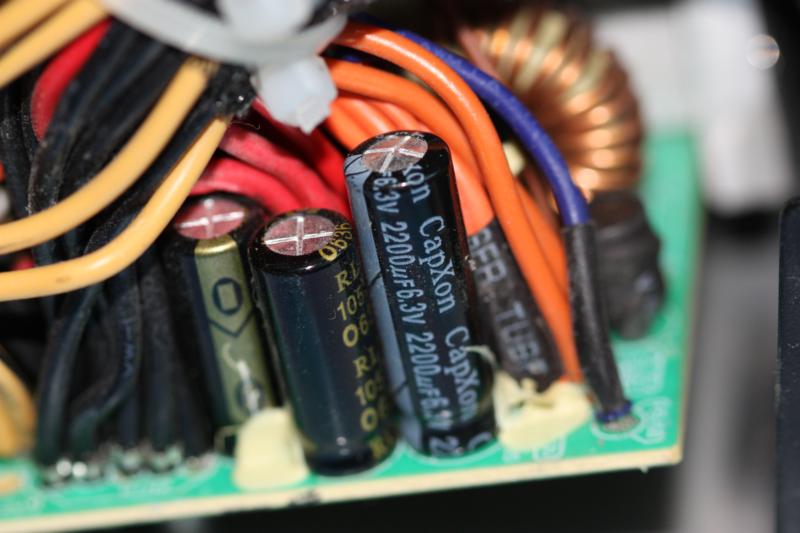

        awesome! thanks for clearing that up for me. I'll do my best to stick as close as possible when working with PSUs. I'm not sure if its best to start a new thread, but I have a OCZ 700W gamexstream PSU that has 2 bulged slim (8mmX20mm) 2200uF 6.3V Capxon KF caps. The problem is that the data sheet for capxon KF caps don't have this size cap. They only have 10x20 and 10x25, with impedance of 90 and 95 mOhm respectively. Is is safe to assume the impedance is slightly less than these as the pattern suggests? perhaps 80-90 mOhm?
        The only 2200uF 6.3v 8x20 cap I found where Nichicon HMs with an impedance of 16, so that's out. I'm thinking I'll have to go with a diameter of 10. I haven't been able to find a possible replacement cap with a proper impedance .

          Originally posted by momaka
          For CapXon KM use any of the following: United Chemicon LXY, LXZ, KY; Panasonic FC; Nichicon PW, PM, HE; Rubycon YXG
          For CapXon GL: United Chemicon KY; Panasonic FK; Nichicon PM, HE; Rubycon PX
          For CapXon KF: United Chemicon KZE; Panasonic FM; Nichicon HD; Rubycon ZL
          Most of these are available on Mouser and Digikey. Rubycon ZL, PX, and YXG are available at badcaps.net only.
          Looks like you also have some OST RLS there. I just replaced like 15 of them on an Asus nForce motherboard. I used Nichicon PW to do it. Anything in that class would be good too.
            [Within a series] the ESR and Ripple specs follow & change with the can size, so when you come across a custom ordered size look in the data sheet to find the closest uF/volts cap with the same can size you actually have, then use that cap's specs. It will be close if not dead-on.
            I've run into those 8x20mm 2200uF KF before.
            I ended up using HM because there was no way to use bigger than 8mm in that PSU.
            Some of the 8x20 were actually heat-shrinked to prevent grounding.

                    Thanks for the explanation. So if I must use 8x20 HM series caps, how significant will it affect the ripple and affect my computer? Will there be risks to my computer?
                    Also I made a mistake initially on the size of the Capxon 2200uF 6.3v cap, the size is actually 8x25mm (not 8x20). Since the diameter was the limiting factoring in choosing another cap I don't think it really changes much right?
                    One of the 2200uF caps is indeed heat-shrinked. When you say to prevent grounding you just mean so it doesn't come into contact with any nearby coils/heatsinks and short right?
                    Mockingbird,
                    The OST cap next to it is actually a 10x20mm RLP series cap, with a higher impedance than the RLS series.
                    Thanks again for replying so late when you're all tired
                      Usually not. Why ripple may sometimes go higher is because it's not ripple - it's control loop oscillation. If they power supply's control loop wasn't compensated properly it will oscillate when parts shift values or are changed with different ones. When we say that ripple could be higher, it could go maybe 10-20mV higher... which isn't a risk. Oscillation brings a tell-tale hiss from the transformer - if the transformer is quiet the control loop is likely okay.
                      Correct.
                              Depends on the specific circuit.
                              If the filter is just 1-cap & 1-coil it will be different than if the filter is a full pi filter.
                              If a full pi filter it will be different between changing the value on only one side of the filter as opposed to changing both caps.
                              Also if the cap isn't in the final OP [output] filter it might not affect ripple at all.
                              If you really want to know the equations are all over on-line.
                              You will have to figure out the values of the inductors in there first.
                              The HM suggestion is because this is one of those times I mentioned earlier where availability of replacements gives you no other choice.
                              Keep in mind you don't have to blanketly use HM to replace all these caps.
                              You could use HM in positions where there is no other option and something else in positions where you have more wiggle room for the can size.
                              It can but you can just modify my ZIT equivalency scenario and look for a ZIT that is 8x25mm instead of 8x20mm
                              That's a really big ZIT.
