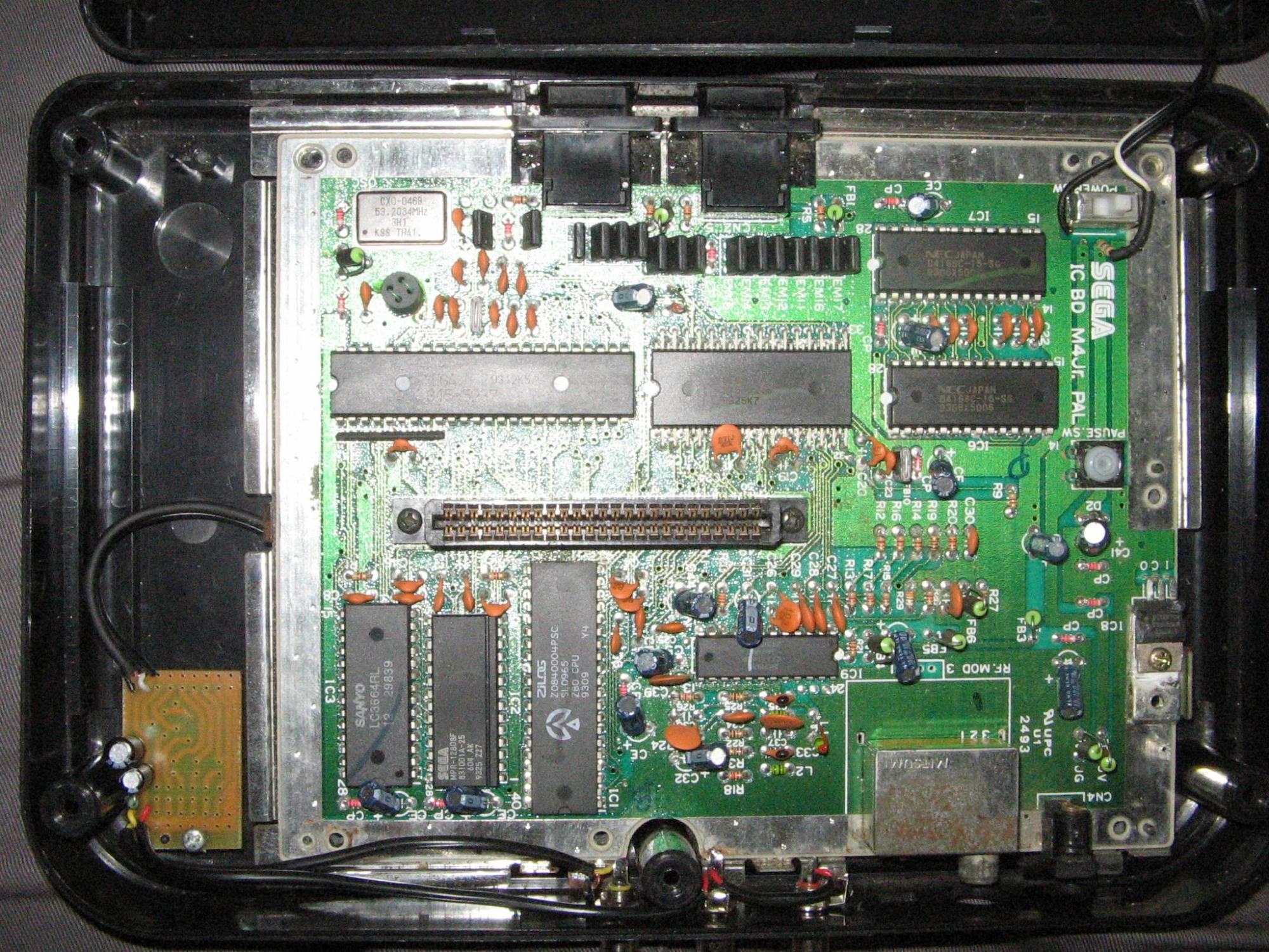

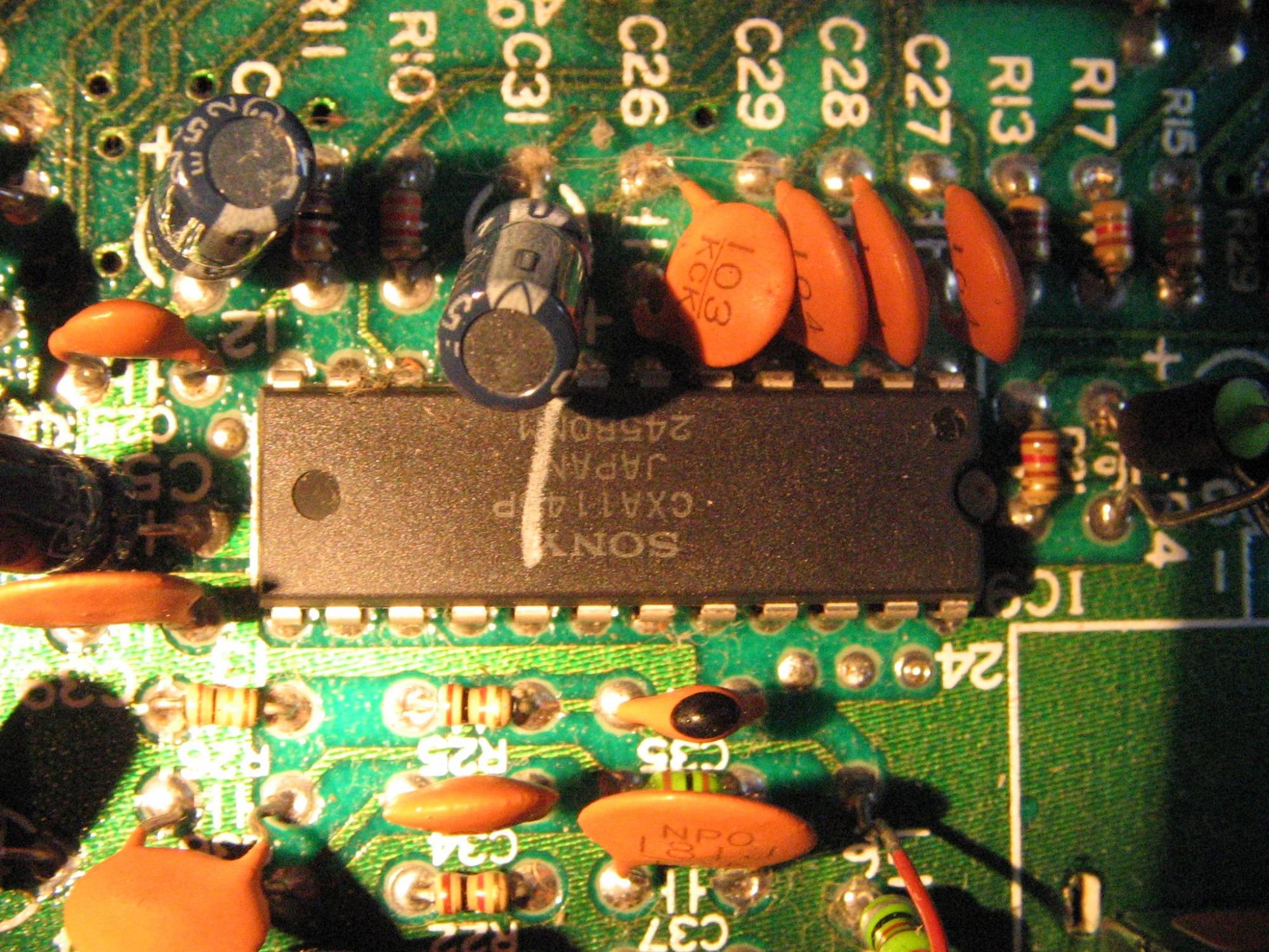

    I have recently finished adding A/V out connections to two Sega Master System 2 consoles.
    The SMS2 uses the Sony CXA1145P IC which provides a Mono audio output, and Composite, S-Video and RGB video outputs.
    The only thing lacking is the wiring and a couple of components, which are easy to add (see: http://knol.google.com/k/konsole-kra...gsu6gmugnec/3#)
    My modification is essentially the same, except it looks much better and uses shielded wire for the signal wires.
    Now, everything works fine, the magic smoke is still inside, I don't doubt the modification itself as many people have done it.... BUT with some positions of the DC power plug, I get buzzing in the audio.
    If I slowly turn the plug around in the jack, at some points, I can make the buzzing go away, in some places, power interruption, and the console resets.
    I get the impression that the jack is worn, there is a bad connection, possibly mild arcing causing the buzzing? Maybe they need cleaning?
    Is this a known issue with old power jacks (remember these console were made in 1990) or could it be something else?

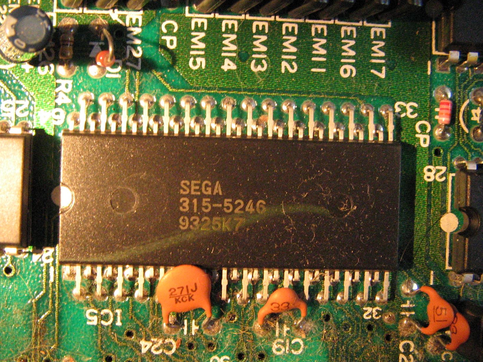

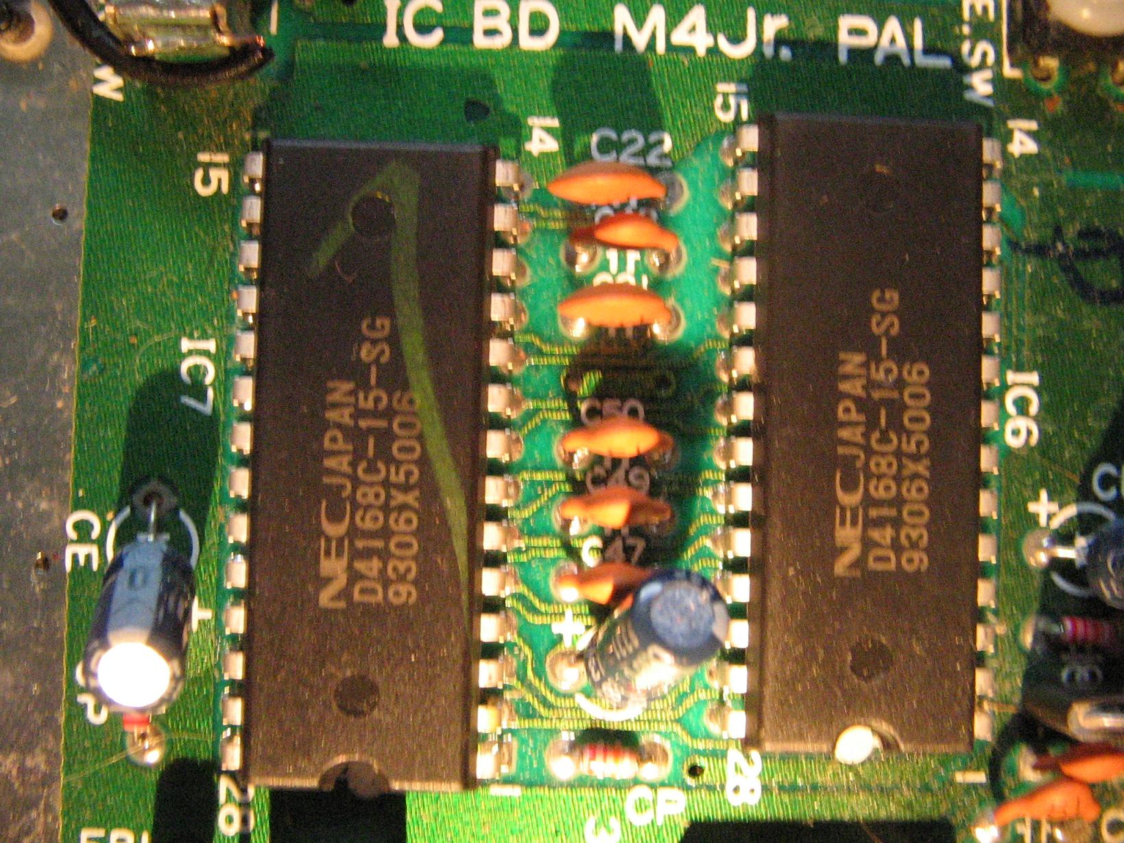

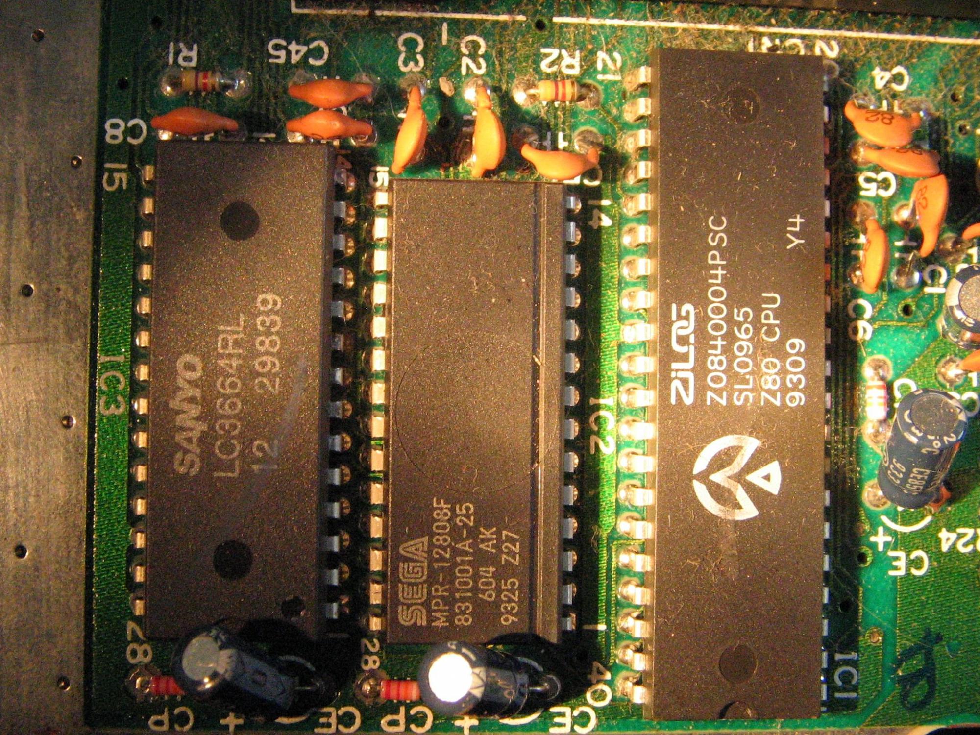

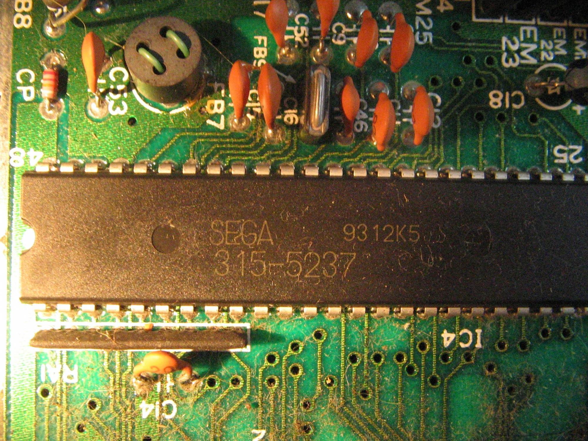

                    I've taken some photos of mine, and it looks like my BIOS chip is a MPR-12808
                    MPR series according to the Internet means that it's a mask-ROM
                    (See: http://www.smspower.org/Development/ROMPartNumbers)
                    On the good side I can't see it would be able to get corrupted or anything, But of course on the bad side, you can't reprogram it to find out either...
                    BIOSes appear to be available here: http://www.smspower.org/Development/BIOSes
                    I guess if you can find an EEPROM with suitable pinout you could give those a try or something, but it may not be the BIOS ROM which is causing your problems, might be something like a bad voltage regulator causing the CPU to lockup, who knows...
