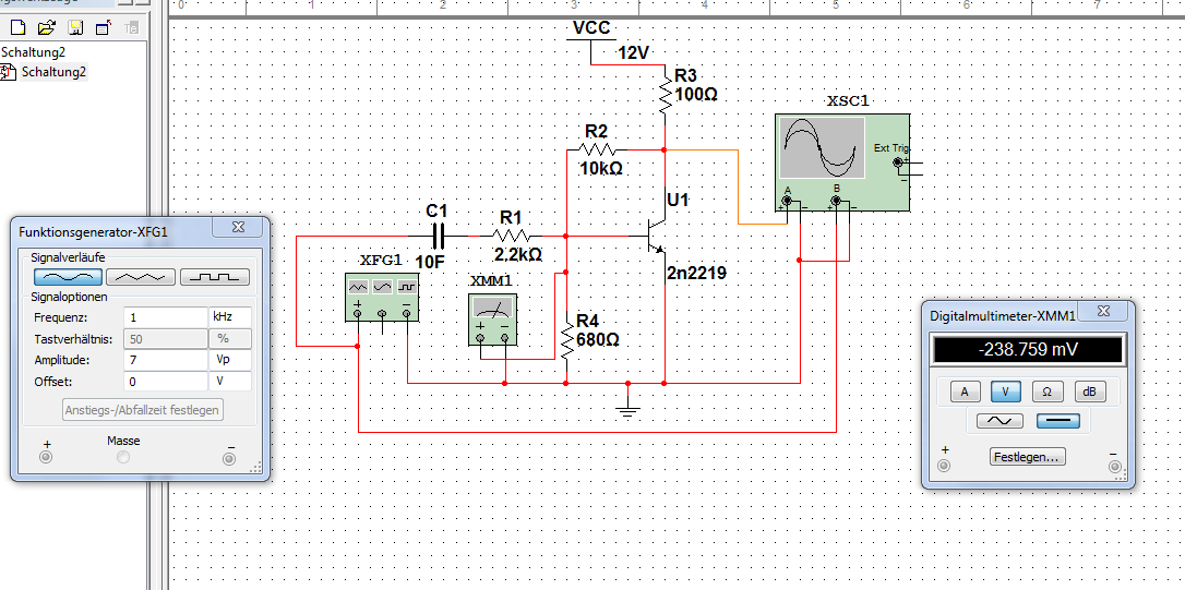

    Multisim troubles
    please delete :/.

    Re: Multisim troubles
    Are you trying to design a common emitter amplifier? If so, you have your top base resistor wired to the wrong place. Edit: Just threw it in LTSpice - it does swing negative due to the input signal. There are two things wrong in your circuit.
    #1. Your biasing is wrong.
    #2. Your input signal is too high in amplitude. 7 volts AC peak is 14 volts p-p. The DC supply voltage needs to be at least this value minus the voltage drop of the transistor. Since you are not using a split supply, your DC supply is 12 volts. And since you're trying to get some gain as well... all you will get is a square wave with DC offset on the output.
