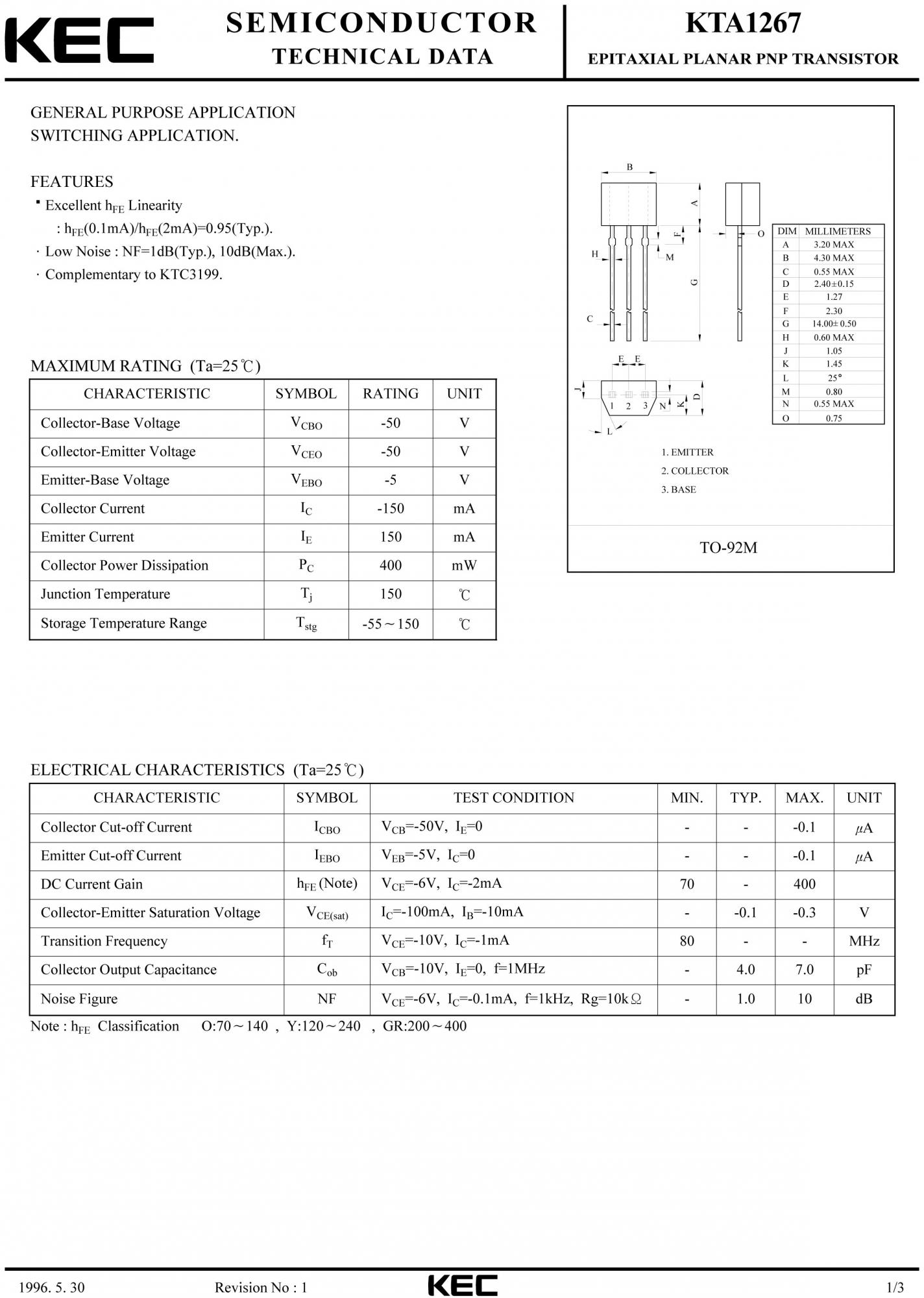

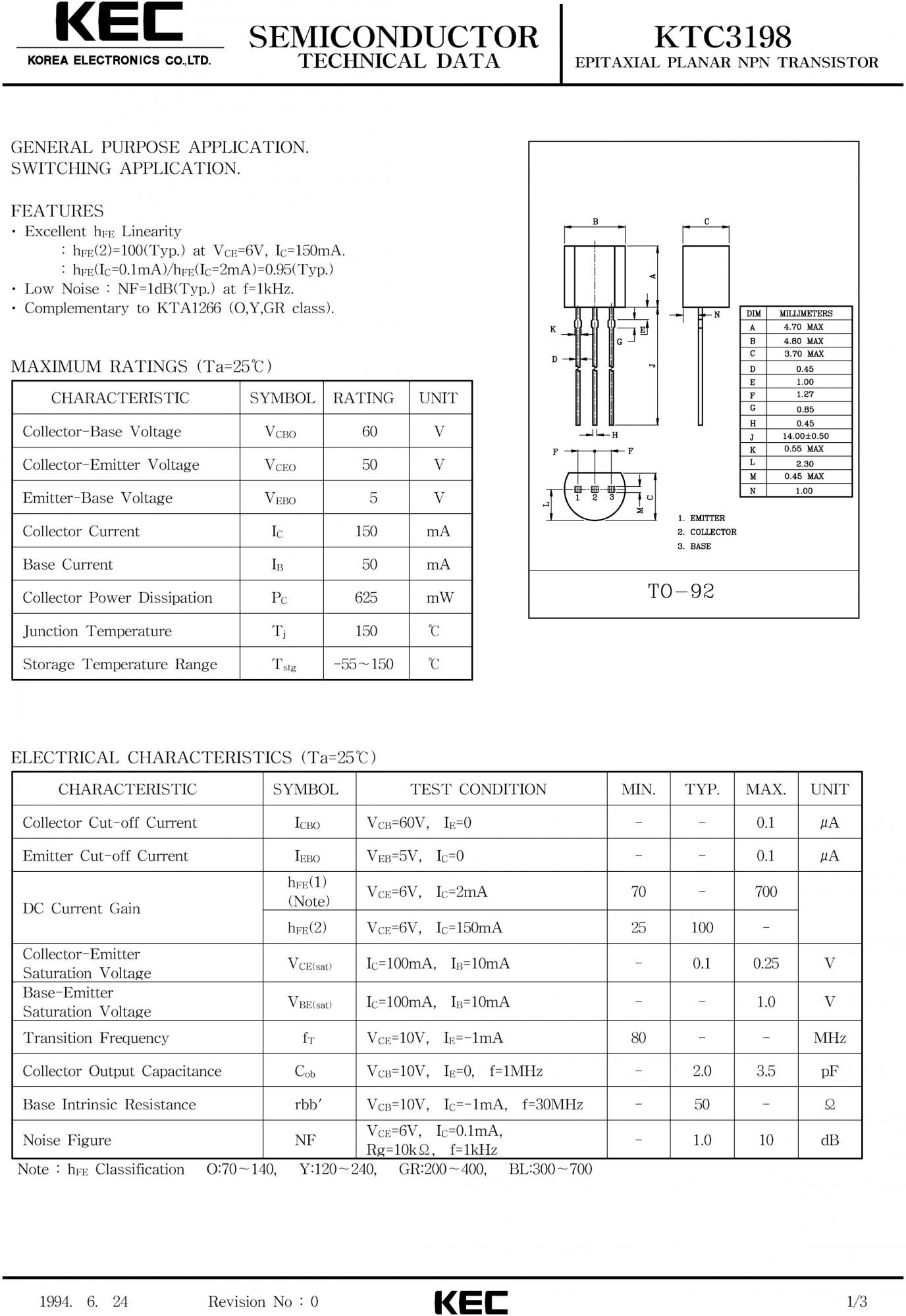

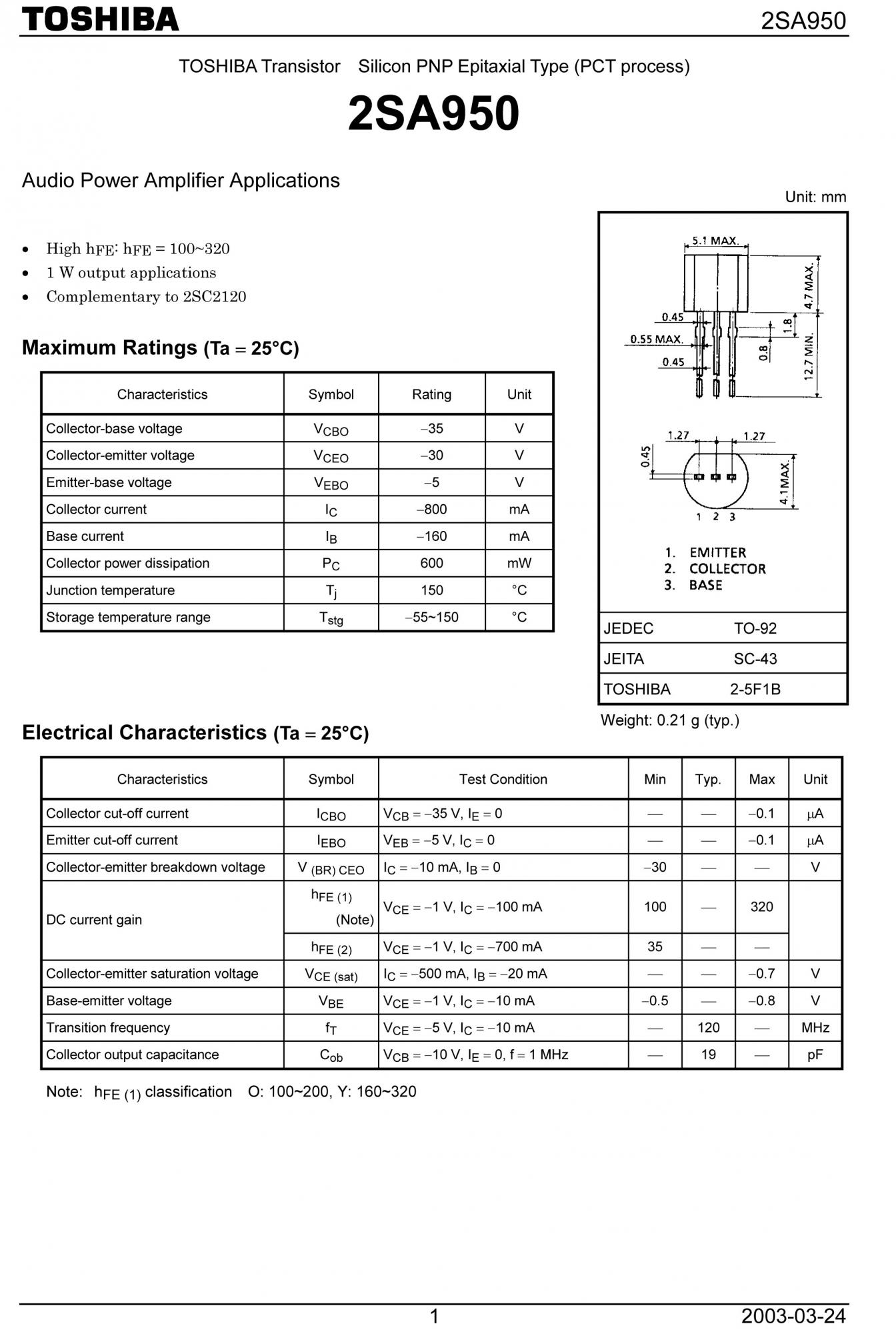

    I'm working on a philips 32PFL3504D/F7 and I found some bad transistors. I was wondering if anyone has a way to cross these over to another brand or maybe a site that would carry all 3 that I need. I really don't want to order from several places due to high shipping costs for penny parts. Or if someone on here that might want to sell me some?
    Part #'s i'm looking for are....
    KTA1267, KTC3198 & 2SA950. These numbers are taken from the service manual for this tv. I've also added pictures of the data sheet for each I need.
    Re: Transistor Help - Please
    For the KTA/KTC you can use the common 2N3904/2N3906 which you can get for super cheap even at Radio Shack. For the 2SA950 i'll have to take a better look, i would have said 2N2907 but that has a higher saturation voltage and will heat up more. If there's room you can buy 2907s anyway and use two in parallel.
