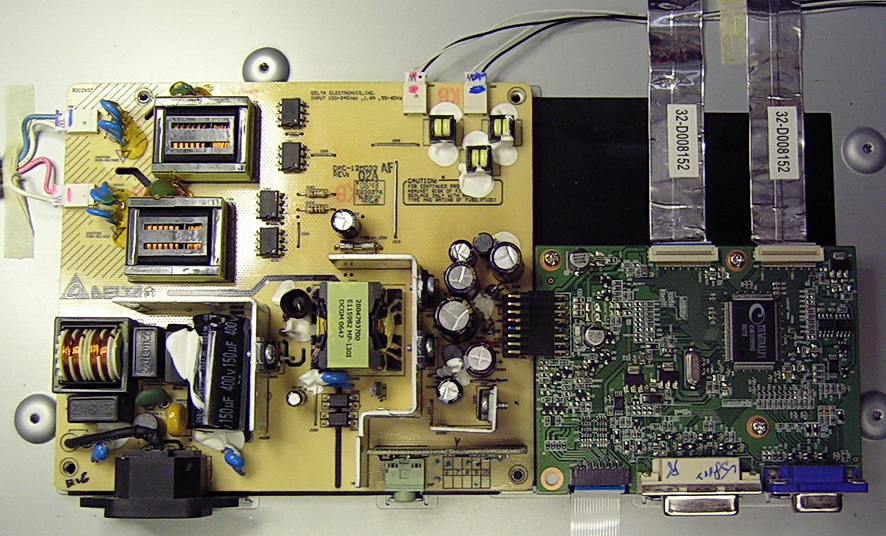

    Re: Reversed polarity cap killed PSU board - FIXED!

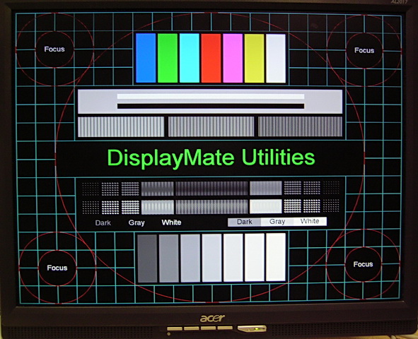

    Done. Working! Running 4 days continuously.
    Short version:
    1 - 2200uF/10v FM - replaced missing one (One that was reversed)
    1 - 4A pico fuse - replaced blown SMD one on 5v line (W crosses to 4A in 2 different manuf sheets)
    1 - 22uF/50v FM - replaced Rubycon YXG in start up section
    More details and some other photos will be up later.
    Toast

        Re: Reversed polarity cap killed Acer AL2017 PSU board

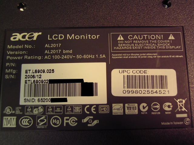

        Acer AL2017 Mfg. 12/2006
        PSU Board: Delta DAC-12M033 AF, Rev: 02A

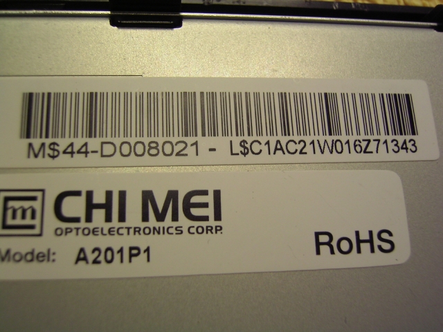

        Panel: Chi Mei - A201P1

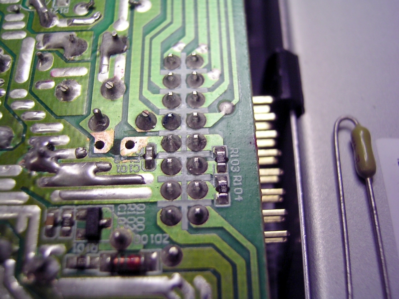

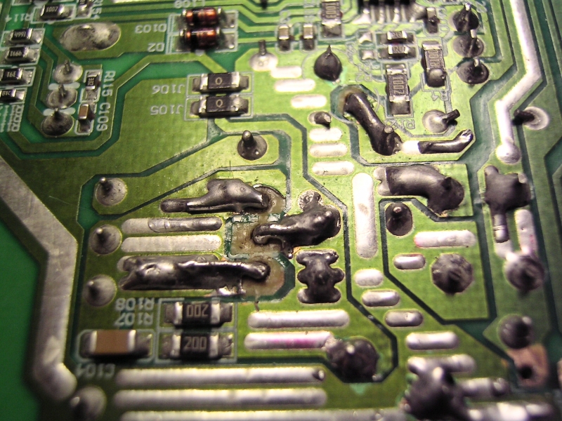

        Fuse replacement with Pico fuse. Cleaned mask from trace and drilled holes to accept said fuse type, shown on right.
        Repair of damaged diode pack traces. Removed and remounted diode pack with fresh thermal grease. Cleaned off mask from traces. Drilled holes oversize and inserted wires I pre-bent at 90° to fit alongside diode leads. Fluxed and soldered in place and over-flowed wire back to good trace areas.
        Was not getting any output from main transformer as measured at diode packs. Laid scope probe across transformer and found only a low frequency sine wave. Not correct. With nothing else apparently damaged, and the missing signal at the transformer, I suspected the small cap.
        Even though the cap was a Rubycon YXG and seemed in good condition and in spec on capacitance and ESR. The specs for all caps used there follow. I do not know (nor understand) why the Rubycon would not allow it to run as the original Capxon is higher ESR by the datasheet.

        I wonder if there is another problem that I should investigate, but after it ran for 10 days with no issues on either test patterns, browsing, or videos, I am not going looking for trouble.

              Very nice. The diode pack all I did was run a tiny piece of wire between it and the nearest compatible trace. You told me to remove it!!!
