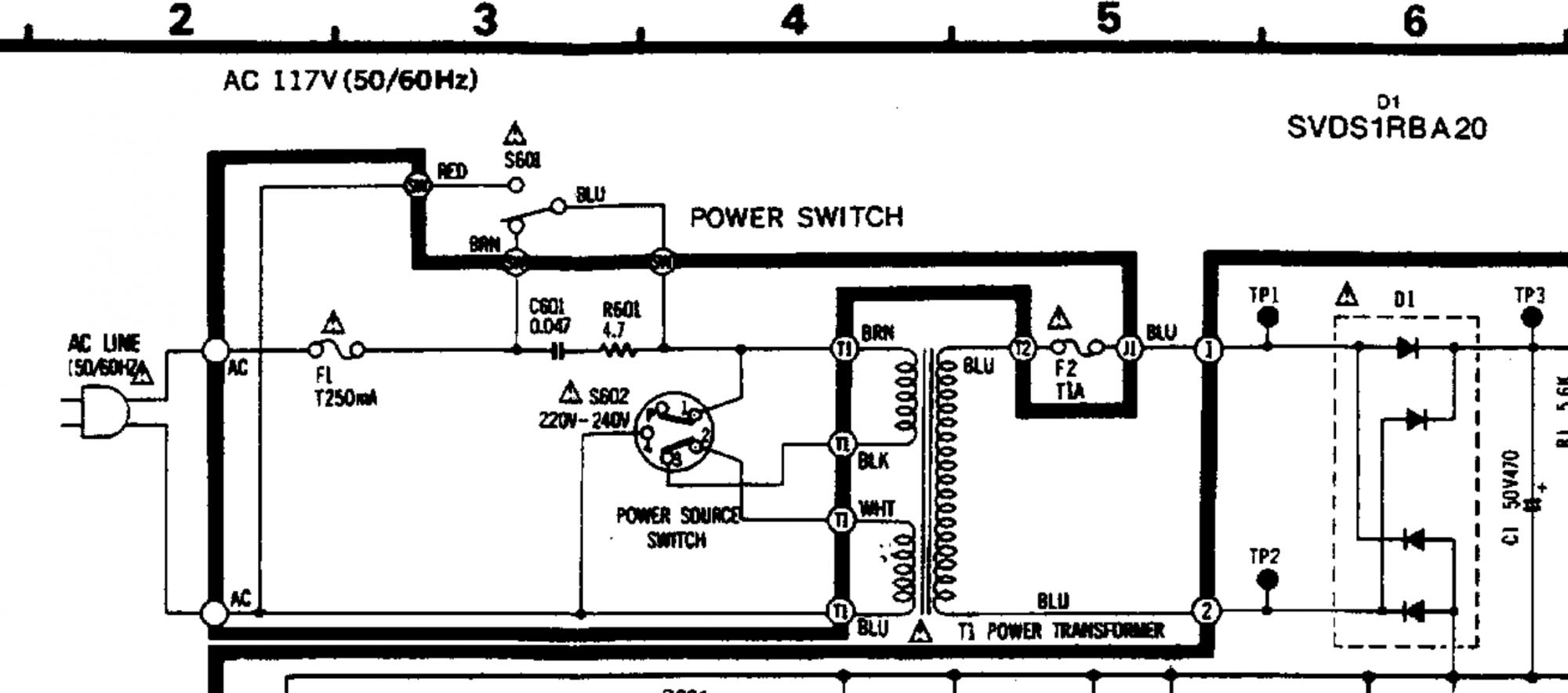

    Snubber Capacitor Vs Class X2 Capacitor
    Is a snubbing capacitor fine to use in place of an X2 suppression safety? The only real difference I see is that the dV/dt is around 3 times higher than the recommended Class X2. Is this a positive or negative issue in this turntable audio device? See C601
    • 31265
    Re: Snubber Capacitor Vs Class X2 Capacitor
    a big polypropylene cap should be fine - you have the resistor to limit current
    • Lee Majors
      • Oct 2023
      • 14
      Oh really, ok great! Well, it's definitely a very big polypropylene hehe. CORNELL DUBILIER 940C20S47K-F. 630 VAC 2kV VDC, dv /dt 1.712kV/µs, Peak current 80A.
      I assume this will suppress noise, EMI etc?
      • eccerr0r
        Solder Sloth
        • Nov 2012
        • 8704
        C601 doesn't suppress much noise no matter what cap you put there. It just saves your switch and that bit of noise your switch makes.
        • Lee Majors
          • Oct 2023
          • 14
          Oh Ok, That is good to know. I guess the bulk capacitor after the bridge rectifier is doing all the ripple smoothing and noise suppression. Thanks, I'm learning some good stuff!
