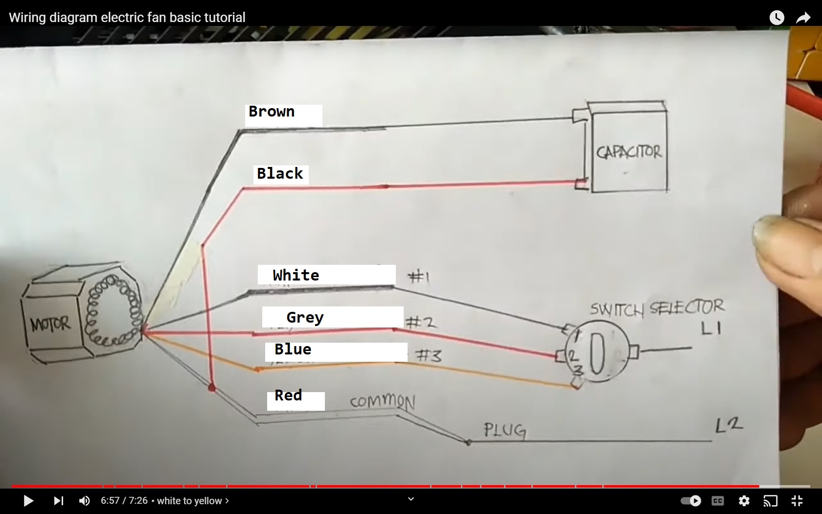

    During the investigation, I confirmed the wiring, confirmed the 3 way switch is fine, the Capacitor measures the correct Microfarads. So I went to the Motor;
    No smell of burnt and it spins very easily. I started to measured the continuity between the 6 wires.
    I have included a diagram from a YouTube video I found but basically the wiring is identical. The only exception is the colors of the wires between the motor and switch are slightly different.
    Anyway am I correct in the assumption that I should not measure continuity between any of the wires (Gray, Red, or Yellow) going to and from the switch\motor?
    Thanks,
    Chris

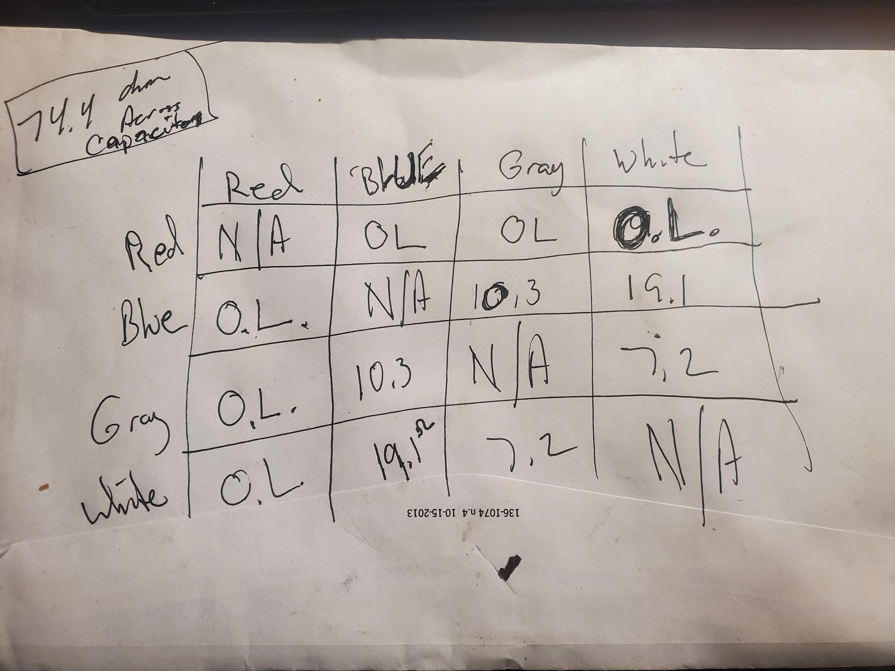

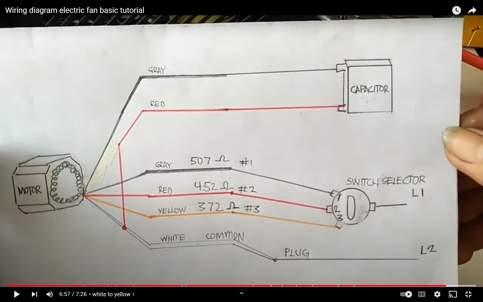

                All,
                I went a little deeper into the motor;
                sam_sam_sam, as asked the resistance of the Capacitor wires (without the capacitor involved) is 74.4 ohms.
                Next I made a Table of wires Resistance between the remaining 4 wires.
                Remember the wire colors I mentioned previously in the image I pulled from YouTube do not represent my motor but the wiring setup is identical. I updated that previous image to represent the actual colors now and included it with the latest posting.
                I included the resistance Measurements.
                As you can see from the table the Red Wire is open. Also that is my common wire.

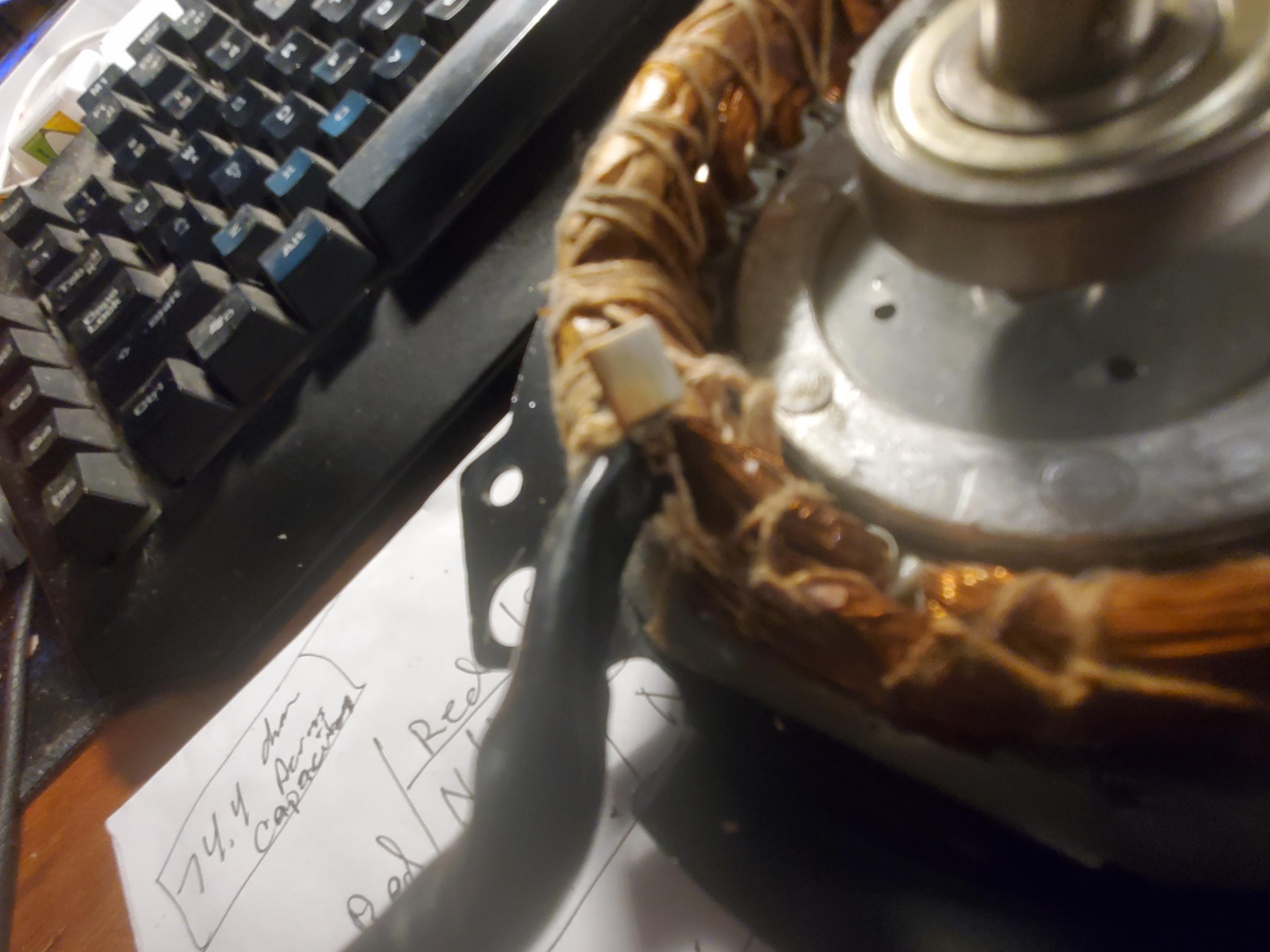

                So I started to look at the labeling on the motor. The motor has a label that says it was thermally protected.
                Looking at the motor closely I could see a white component (image included).
                I believe that image is the thermal protector.
                I confirmed this is what is causing the Red to be Open by taking a screwdriver and crossing the two wires going to it. Then measuring my resistance values once again.
                Red -> Blue measures 33.3
                Red -> Grey measures 45.6
                Red -> White measures 53.6
                So my question I guess now is it possible to get another thermal protector or should I by pass it and make it a garage use only fan (monitored fan)?
                Thanks everyone for the help,
                Chris
                  • 31154
                  Re: Electric Motor Question....
                  thats a thermal fuse.
                  bypass it and see if everything works
                  if it does, we can find a cheap source of them - pay attention to the markings on it - they com in different temp ratings
