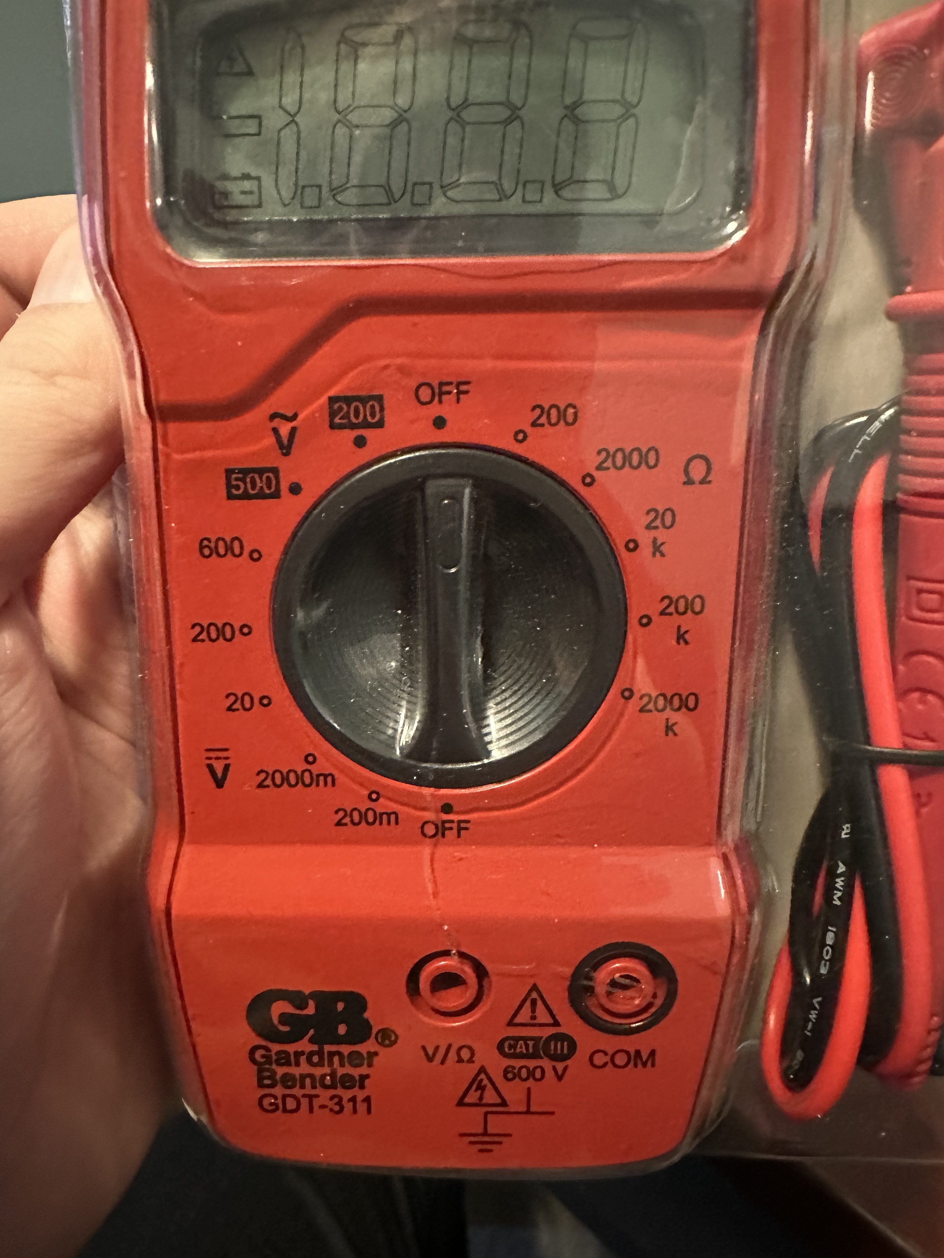

                  Originally posted by andrewsawesomr
                  Re: Artist seeking to tinker with electronics safely
                  ... If you want to check how charged the capacitors are, put your multimeter on 500V DC (the V with one straight line and one dotted line)...
                  The multimeter I bought doesn't appear to have a 500V DC setting. Should I assume the 600V is the one I should use?
                  Also, does it matter which probe is connected to which side of the capacitor, or is it interchangeable?
                    • 31294
                    600 setting,
                    leads will work both ways - not that it matters but if you get them the wrong way it just puts a "-" sign infront of the reading
