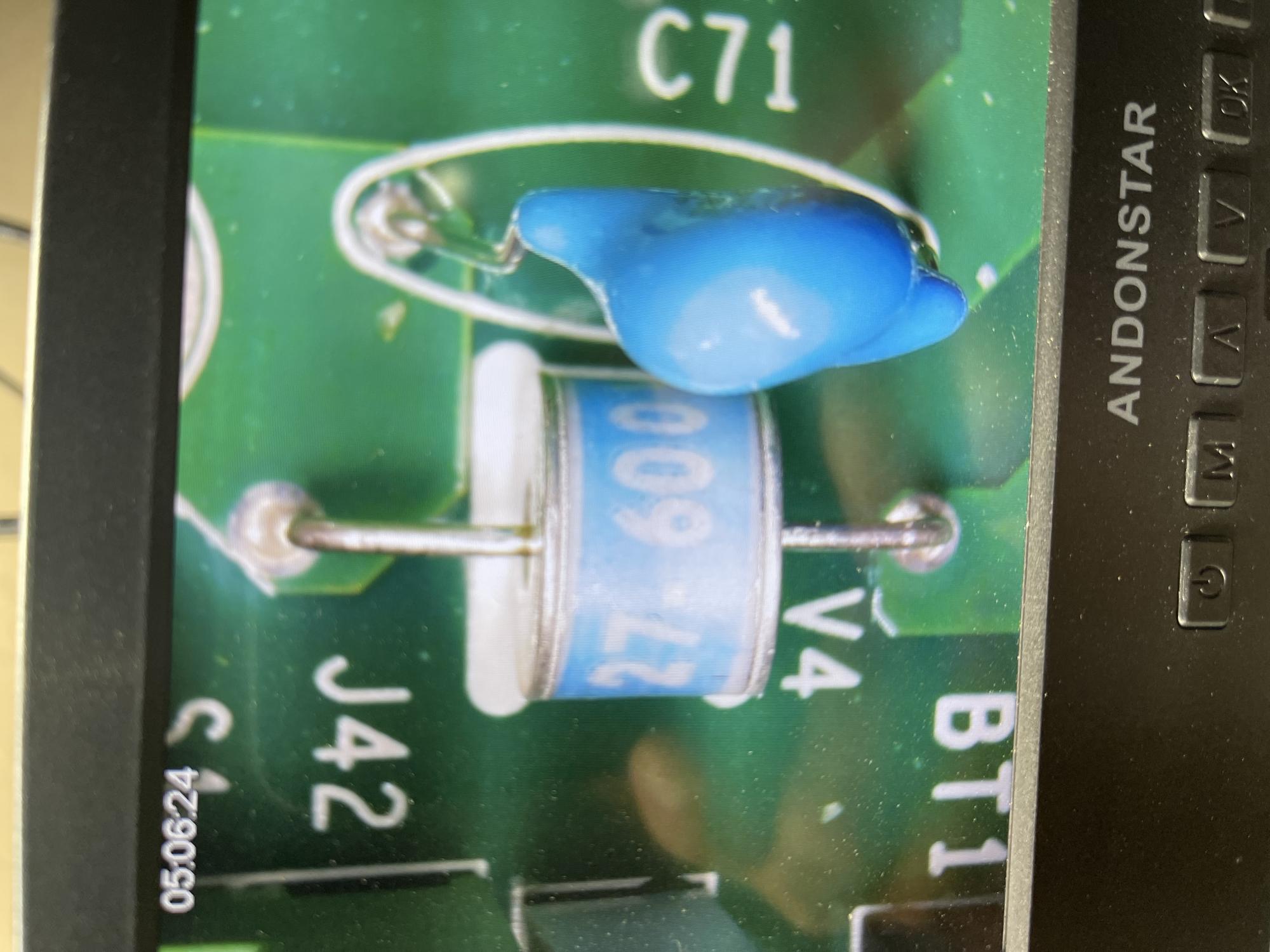

    Hi folks, can anyone tell me what this component marked “V4” is and maybe if there is a way to test it?

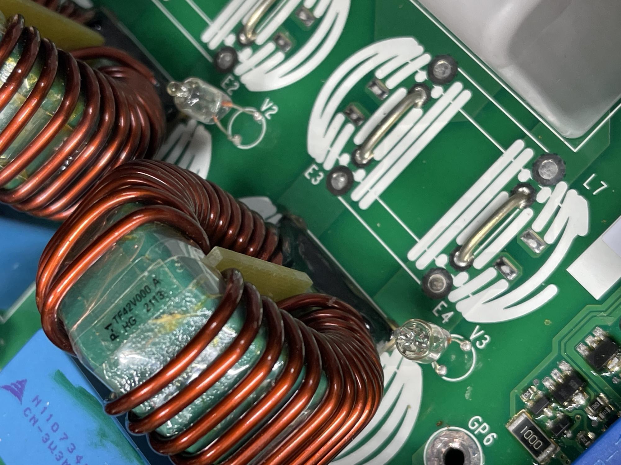

    does it look same as v1 v2 v3 ?

      No, V1, V2, V3, and V5 look like miniature bulbs

        V4 looks like a gas arrestor or gas discharge tube. The others look like neon bulbs.

          Thank you! You are exactly correct. Is there any way I can tell if it's good or not? I suspect it's probably good as I don't see any signs of leakage or physical damage.
            • 31090
            Re: Can you identify this component? Photo included
            it should meter open circuit

              Yes it does
