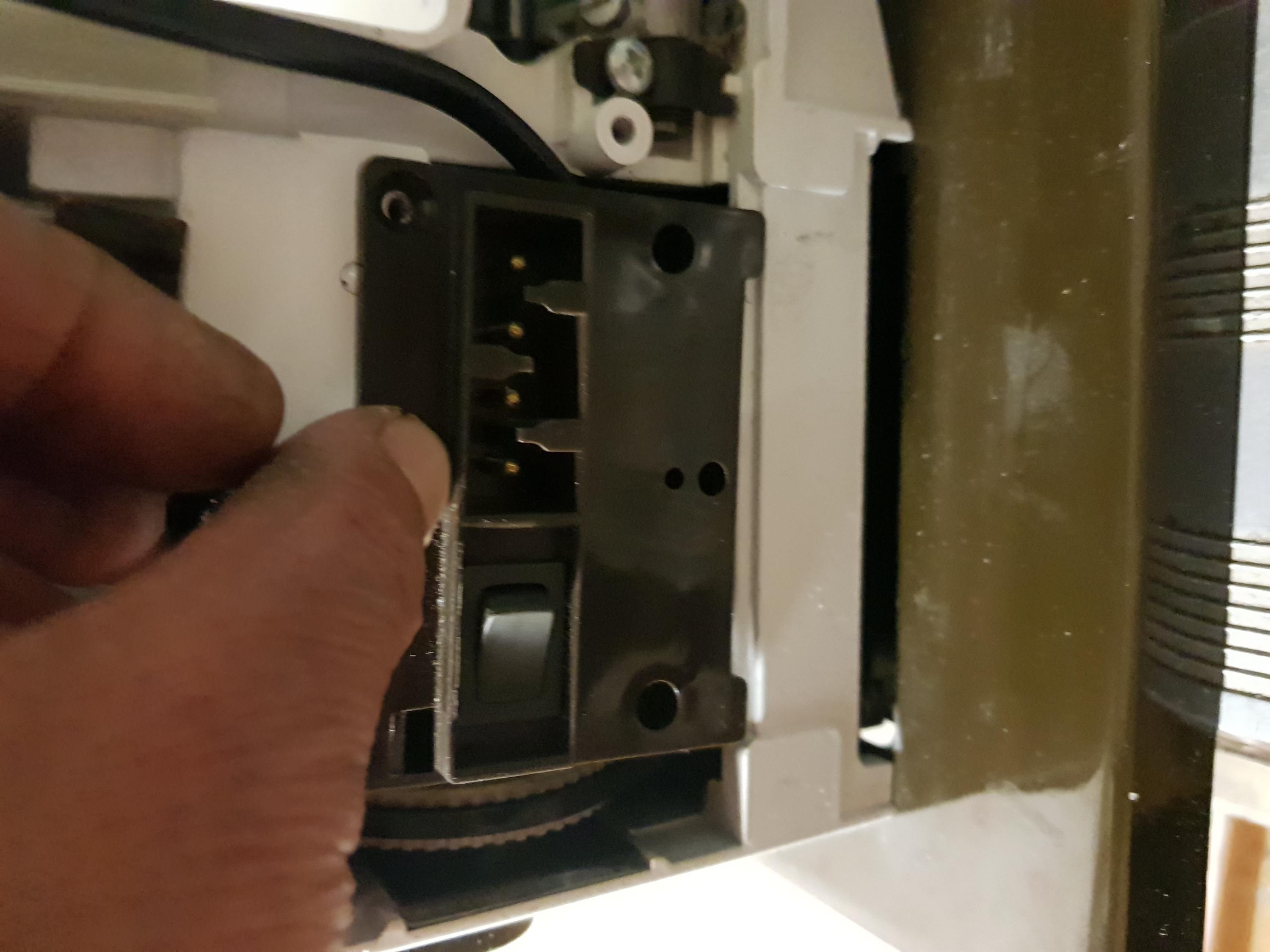

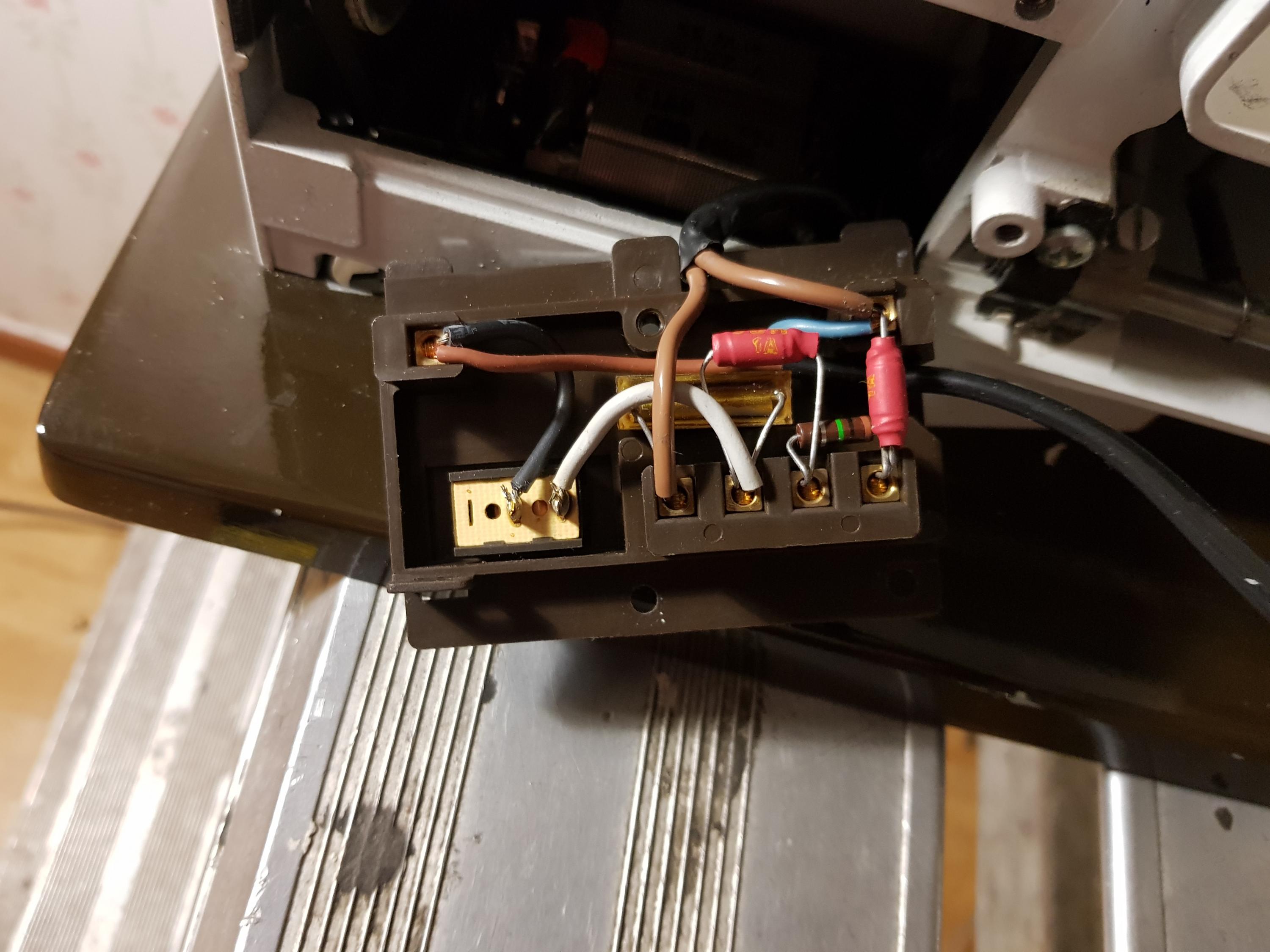

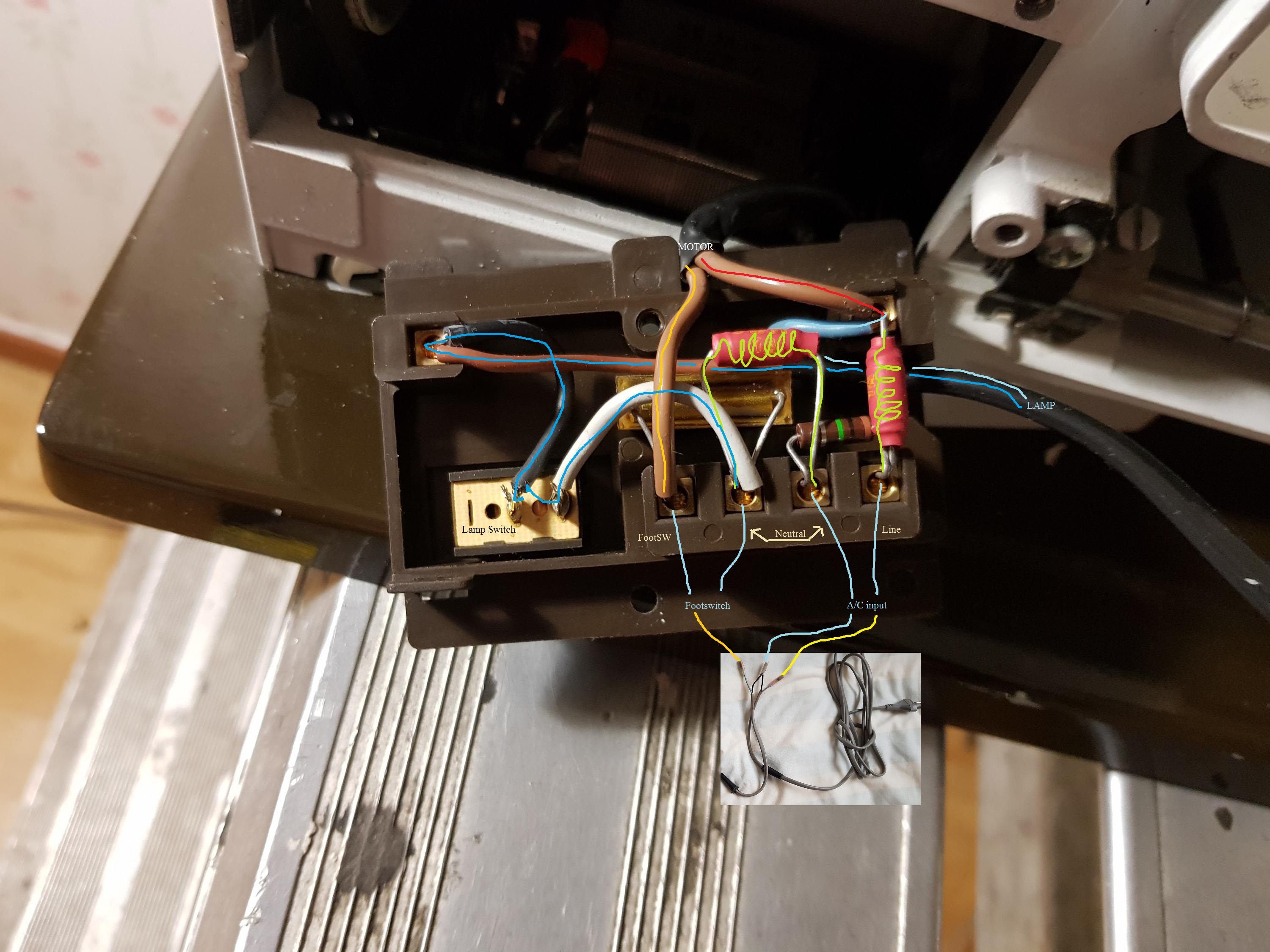

    can someone say how to put this plug together, there are two cords, one goes to the pedal and the other from wall plug to sewing machine. Don't know if the pedal should get its power from the motor, it's a bit confusing because the two cords coming from the motor are brown colored, don't know which is live or ground the blue and brown cord comes from the lamp. if anyone knows grateful
  • R_J
    • Jun 2012
    • 9624
    Re: Sewing machine Husqvarna 1610 electric contact
    I'm not sure what you mean by "how to put this plug together" as it looks like it is already together.
    Going by picture 1, it looks like the connector next to the switch (2 pins) is for the foot pedal, and the connector on the right (2 pins) is for the a/c line. Post a picture of both the foot pedal and the a/c line cord.

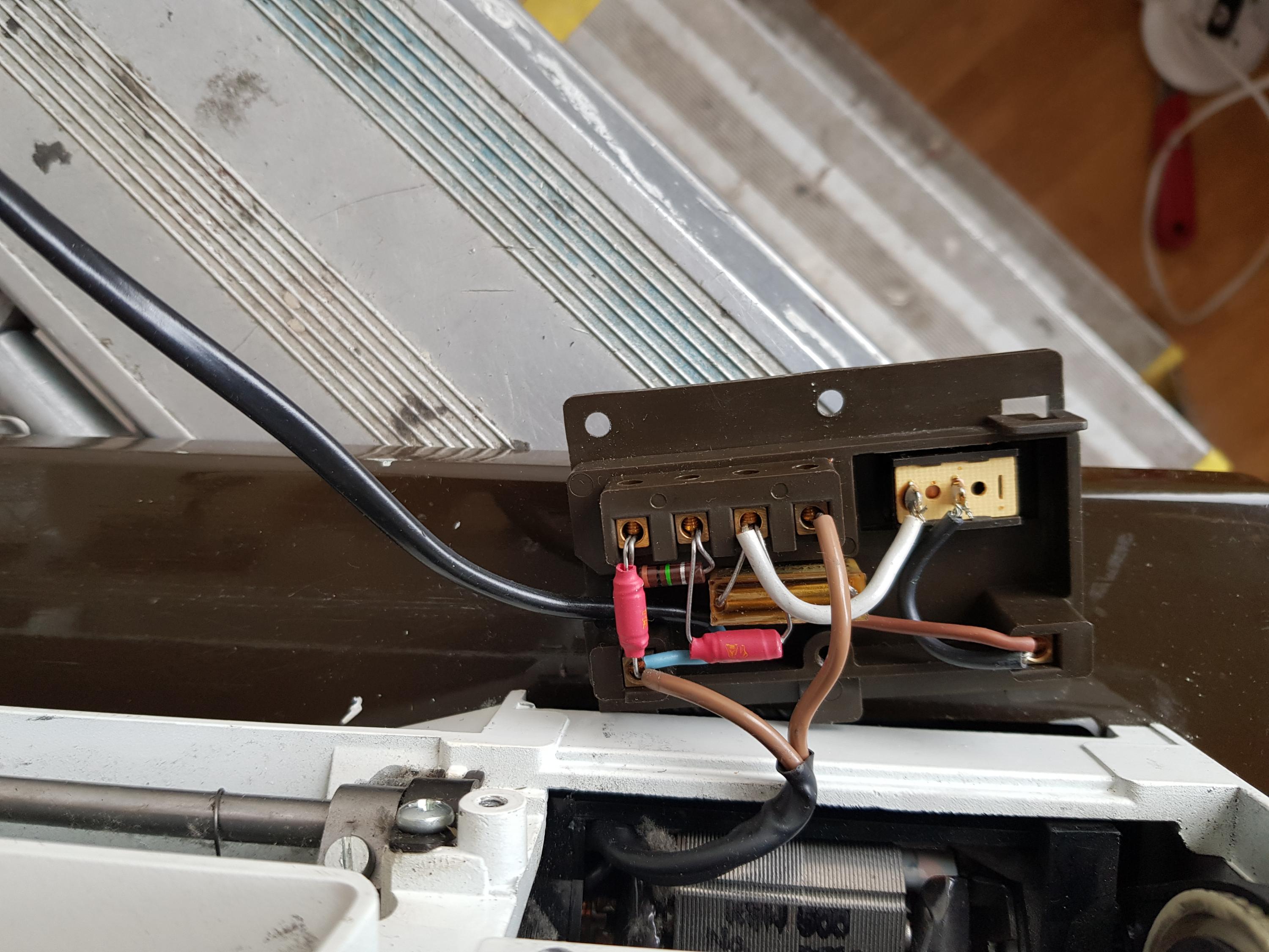

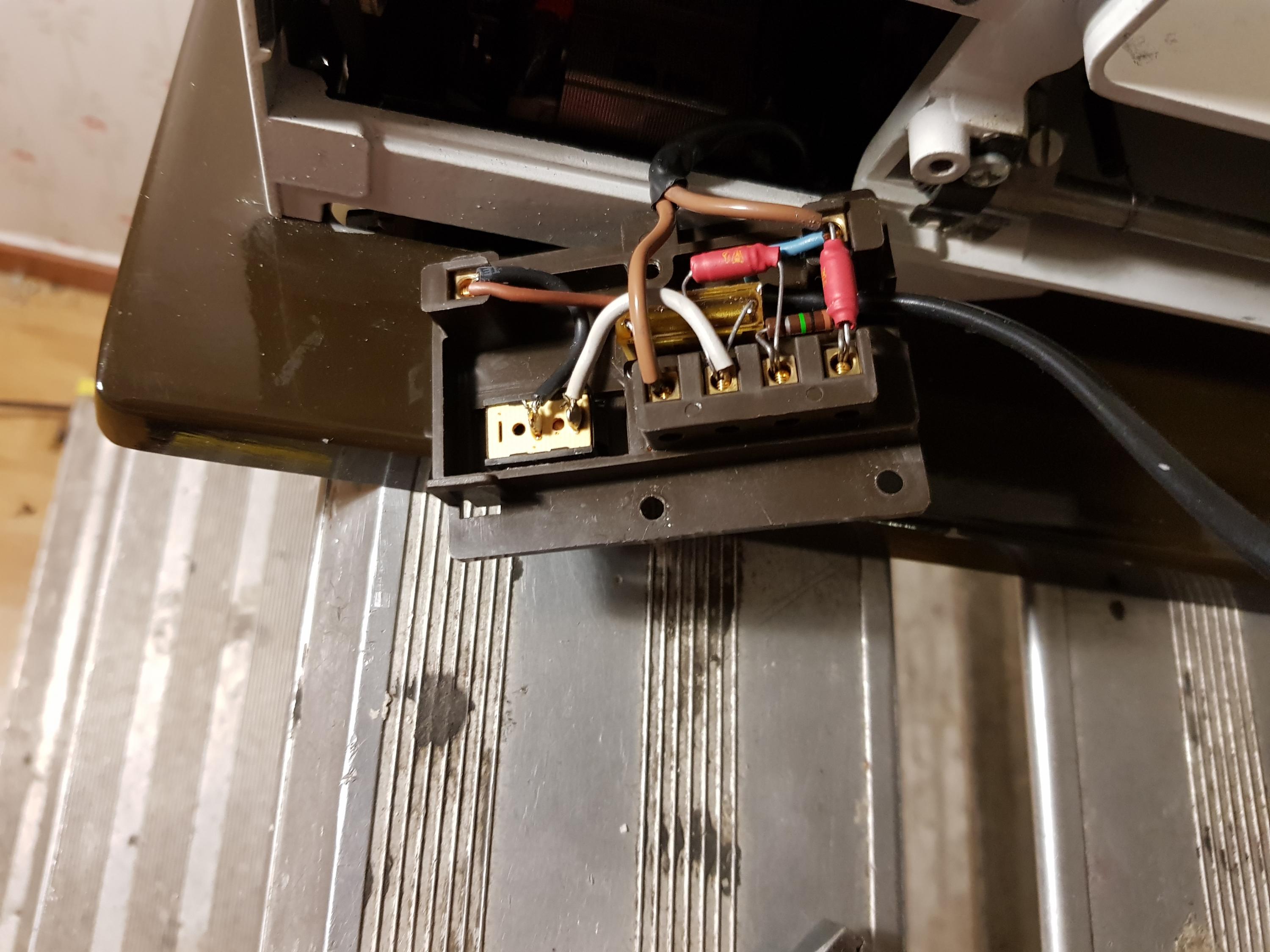

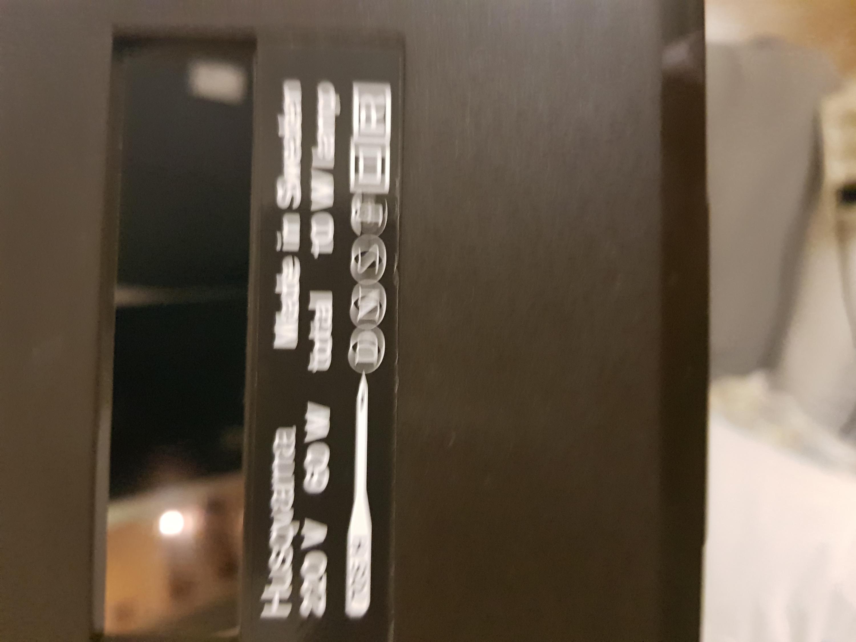

      here some other pictures. The cord is connected ground together and live as you see in the picture it must be wrong if you can point which is ground or which is live on the plug on the sewing machine

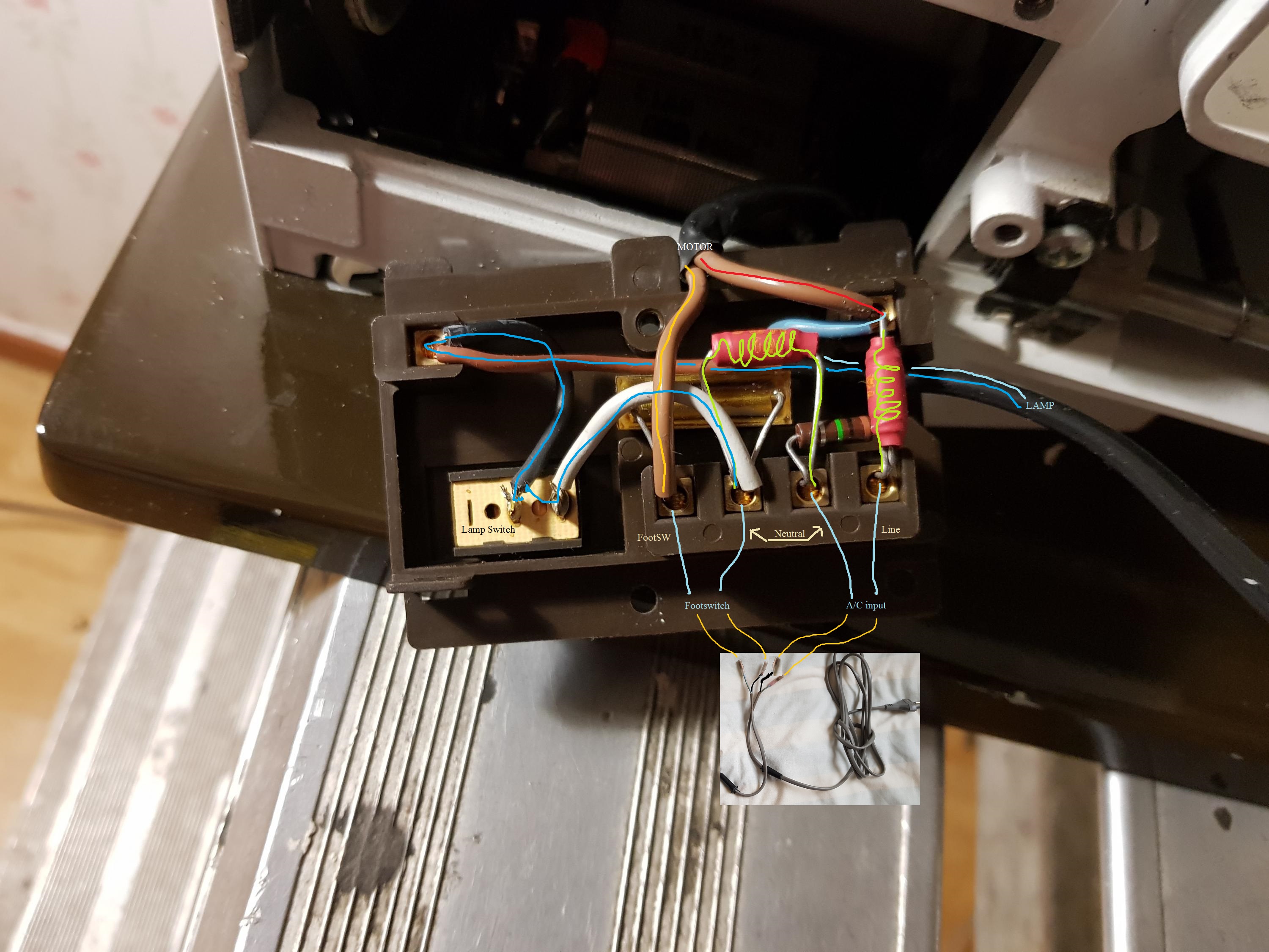

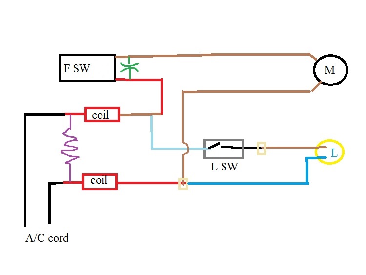

        It seems this foot switch is not for this model sewing machine, The machine uses 4 wires, and I would think the footswitch is on the neutral or ground, but in this situation I don't think it really matters. The footswitch must just turn the motor on and off, it is not a variable speed footswitch.
        The first picture connects the wires using black as neutral as the two center pins are connected by a coil. The second picture has the two black wires separated and each connected to its own pin on the sewing machine. Either should work.
          then the white wire is + Live? = "the two center pins are connected by a coil " have to be Live ?
            I have no idea which pin is the LIVE pin on that plug in your country, It looks like the plug can be inserted in the outlet either way, so it would not matter which is the live pin as neither is connected to the machine case.
            All you are doing is turning a motor on and off, with a foot switch, how complicated can it be?
            In Canada the White wire is neutral and the live wire is Black, if the plug is not polarized, it doesn't matter
              in our country Sweden brown is neutral and bleu is live or bleu = + and black neutral and if it is grounded then it is bleu + brown - and yellow-green soil.
              But this construction in the machine only matches half way bleu and brown that goes to the lamp but then the white that is to laid. Going by picture 1, it looks like the connector next to the switch (2 pins) is for the foot pedal, and the connector on the right (2 pins) is for the a/c line. Post a picture of both the foot pedal and the a/c line cord.

                live neutral reversed shouldnt matter much . it would confuse me as brown is live and blue neutral here .
                on another note the correct cable with plug is available to buy new .
                  It is pedal with variabile resistance, not only on off switch. Motor speed depends on how much is pedal presed. Motor is stoped if no presure on pedal, go slow if some touch is present, and go full speed if stepped on it to the flor.

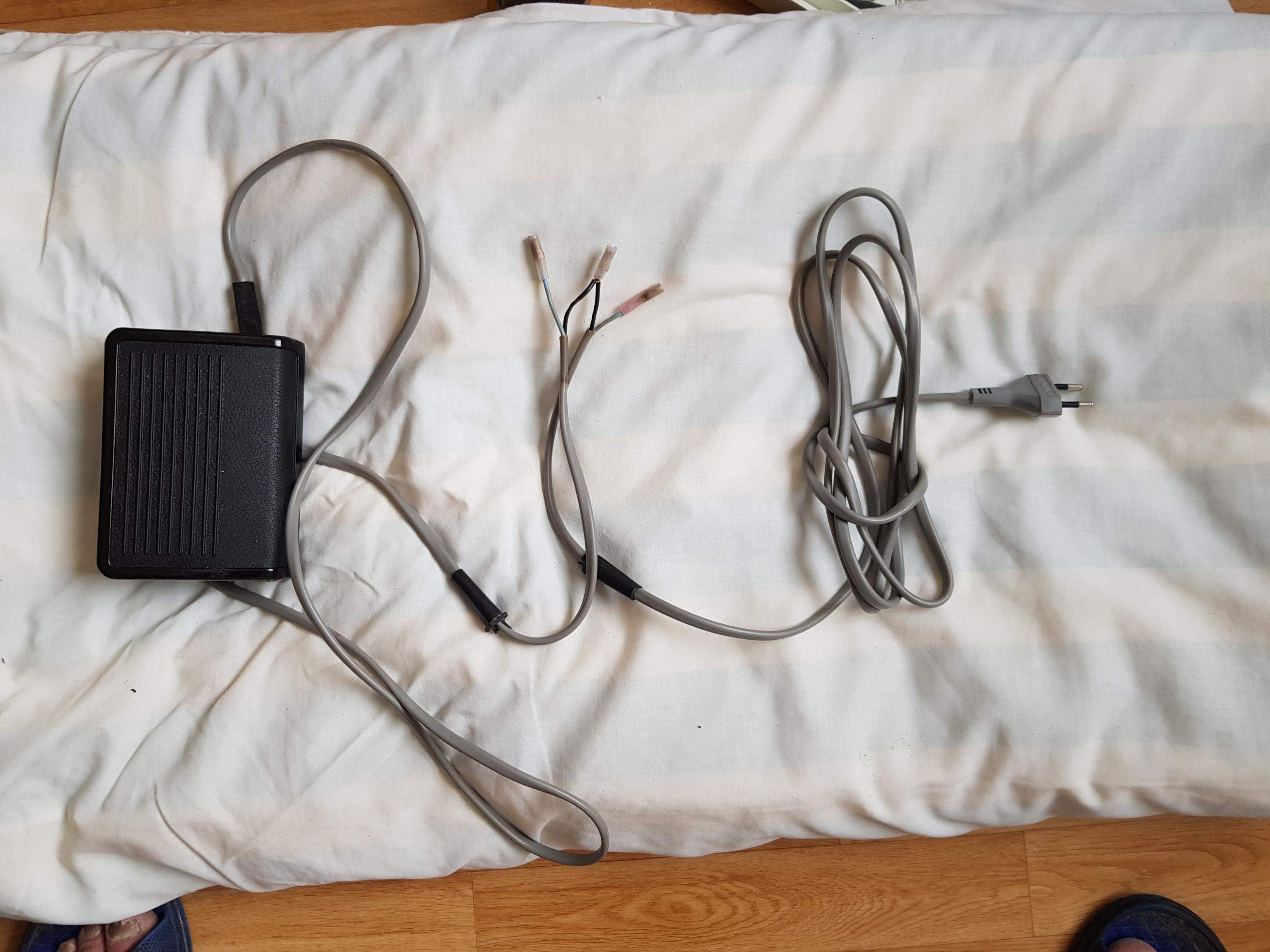

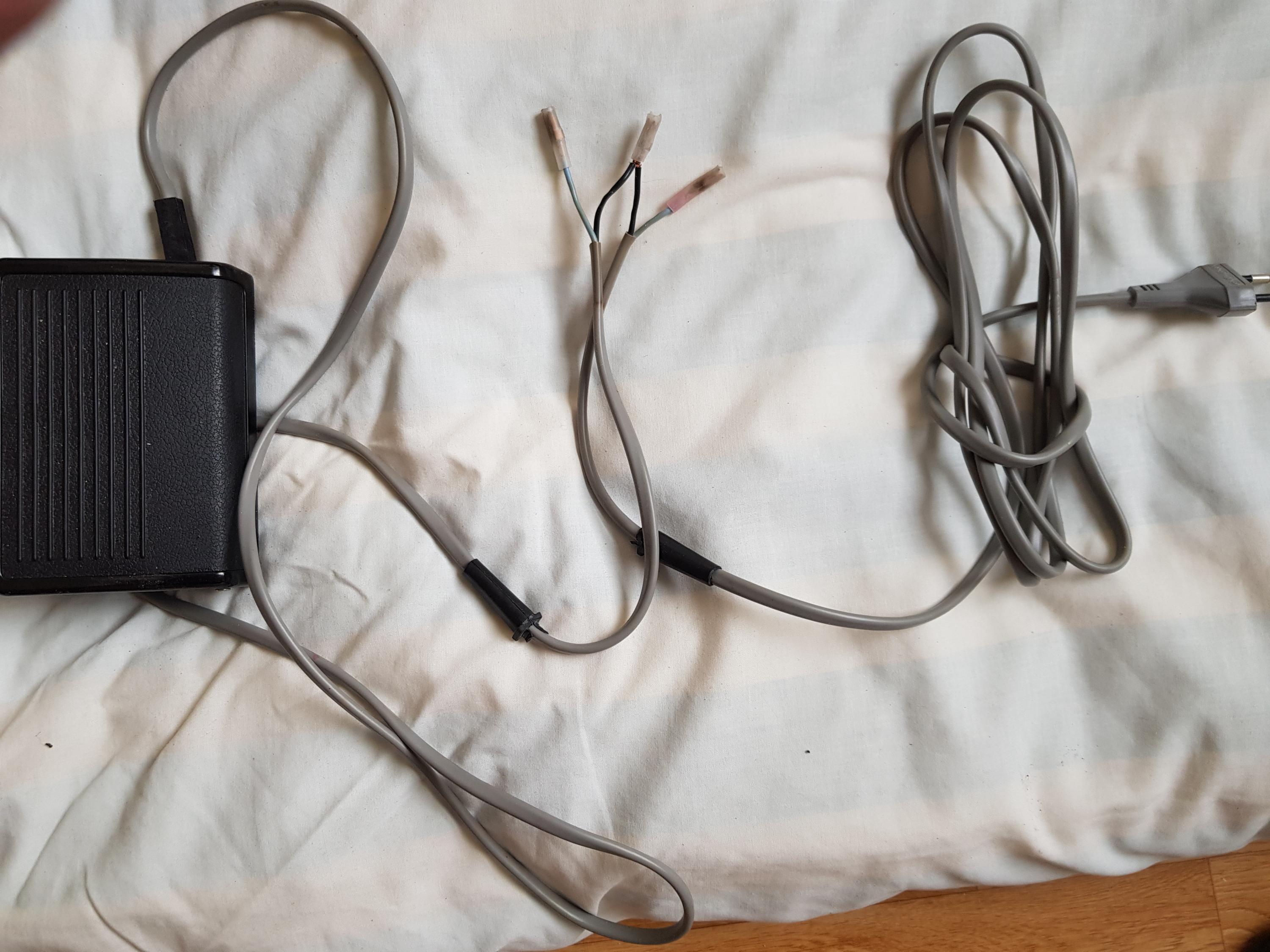

                    have searched to buy but can not find do you have any link to it? It's an old machine but looks like new except for this missing connector
                    but i think the correct coupling is -++- it's a bit confusing with coil in those two middle connectors
                      Lets hope the variable resistor can handle this motor's current. I know most foot pedals have a variable resistor and switch, but some are meant to control a motor speed controller not the motor directly.
                        Maybe this will help, disconnect the two black wires from each other so you have two separate cables, one for the power and one for the switch.
                          The problem right now is not "The variable resistor" except how do I connect the pedal plus the power to the machine? which cord to go to the right hole (plug) is -++- option ok = -+ pedal +- wall socket ?
                            There is no + and - it is AC voltage, connect it like I already showed you. Is that a polarized AC plug ??? if not who cares which way it is connected.

                                I think it's a polarized AC plug

                                  see how it is shaped the male plug enters in one way

                                    The motor should not be a concern, the only item that would be a concern would be the lamp. The lamp socket (the outer part that has the threads) should be connected to neutral. other than that, everything else should be isolated and never exposed to a live line

                                      The lamp is no problem because it is already plugged into this connector it is the one that has the bleu cord and black cord and it should be bleu =+ (live)and black - (gnd) and it is in its place isolated
