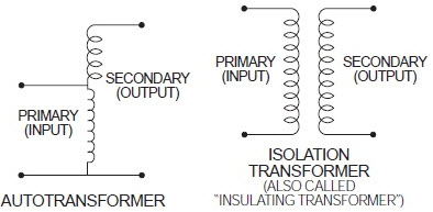

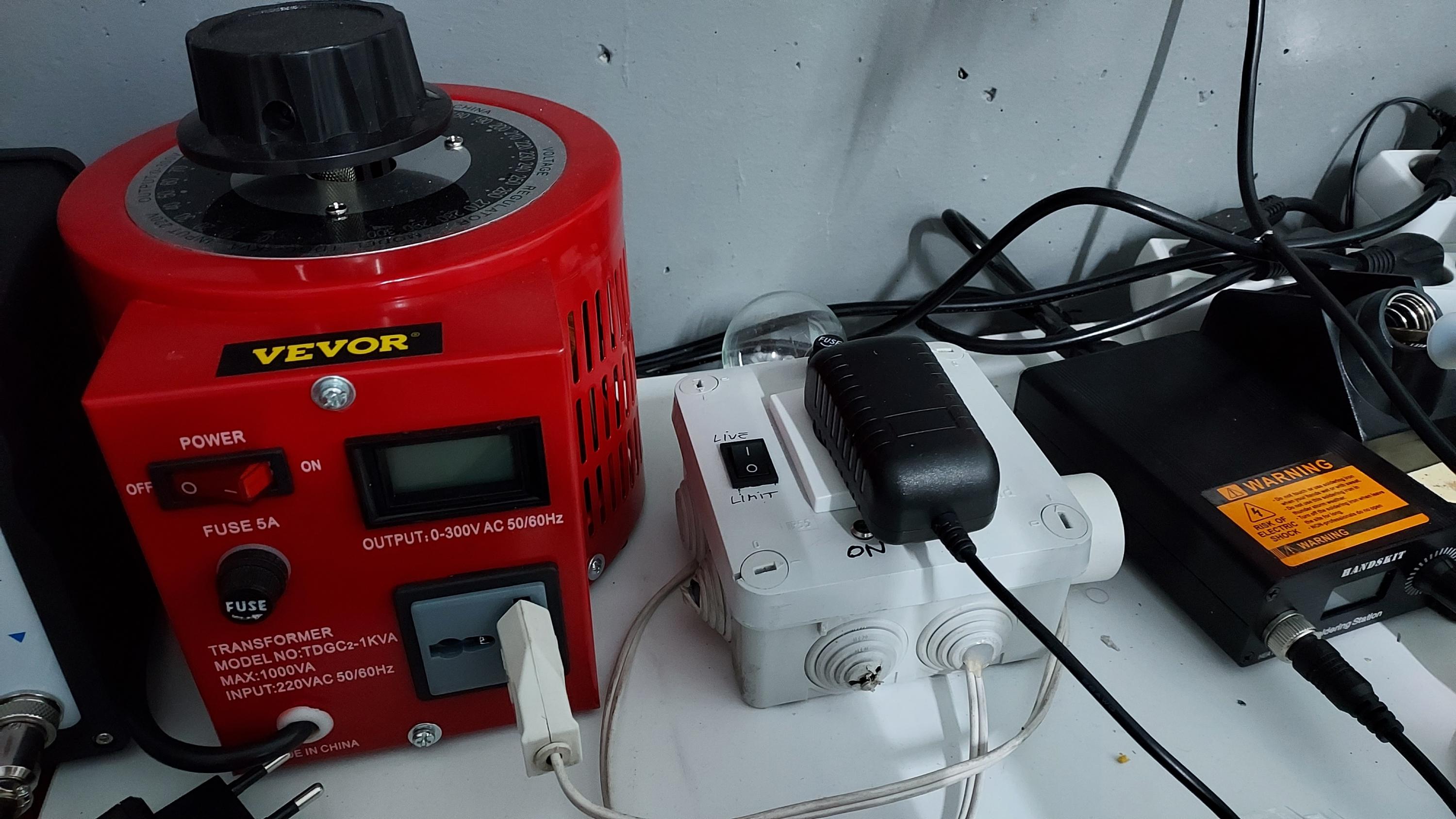

    1. Is this a right isolation transformer to isolate it from ground and work more safer for instance with SMPS?
    I bought this transformer where I have plugged a serial lamp and from it I plug the PCBs I want to test.
    2. Isolating correctly the oscilloscope
    I am not sure if connecting the oscilloscope at the isolation transformer will be good idea when measuring things with HOT GROUND........or maybe better to use batteries and have it fully isolated.
    I'v bought a second hand osciloscope and I have built a 5V battery for it.......is it a good configuration? or both are good?

    That is NOT an isolation transformer, it is a variac (autotransformer) It will not isolate anything from the a/c line.

      Thanks R_J for highlighting it!!...
      So better I buy a real isolate one before I die.
      What about the oscilloscope external supply? Battery powered is a good isolation from ground, right?

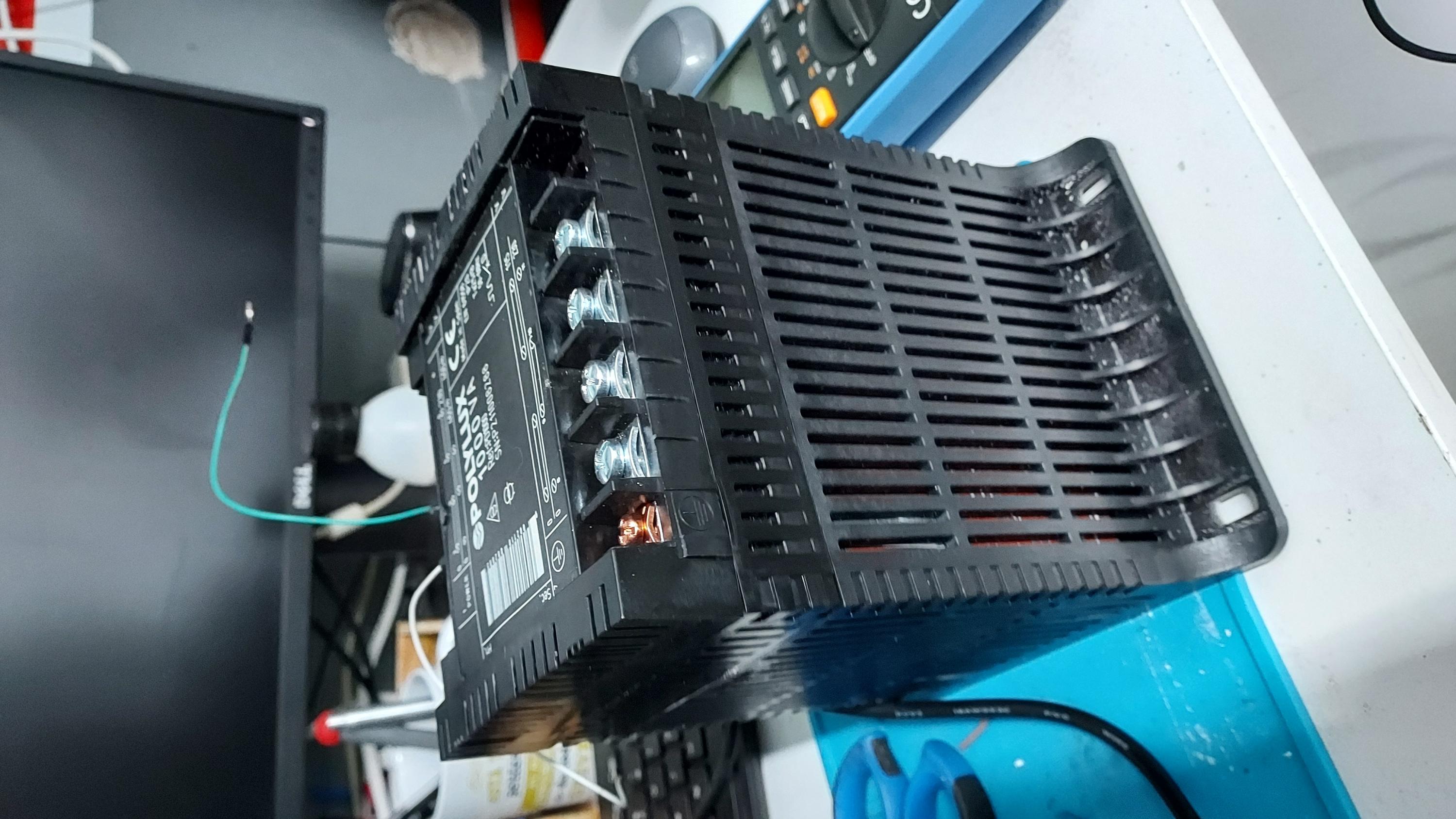

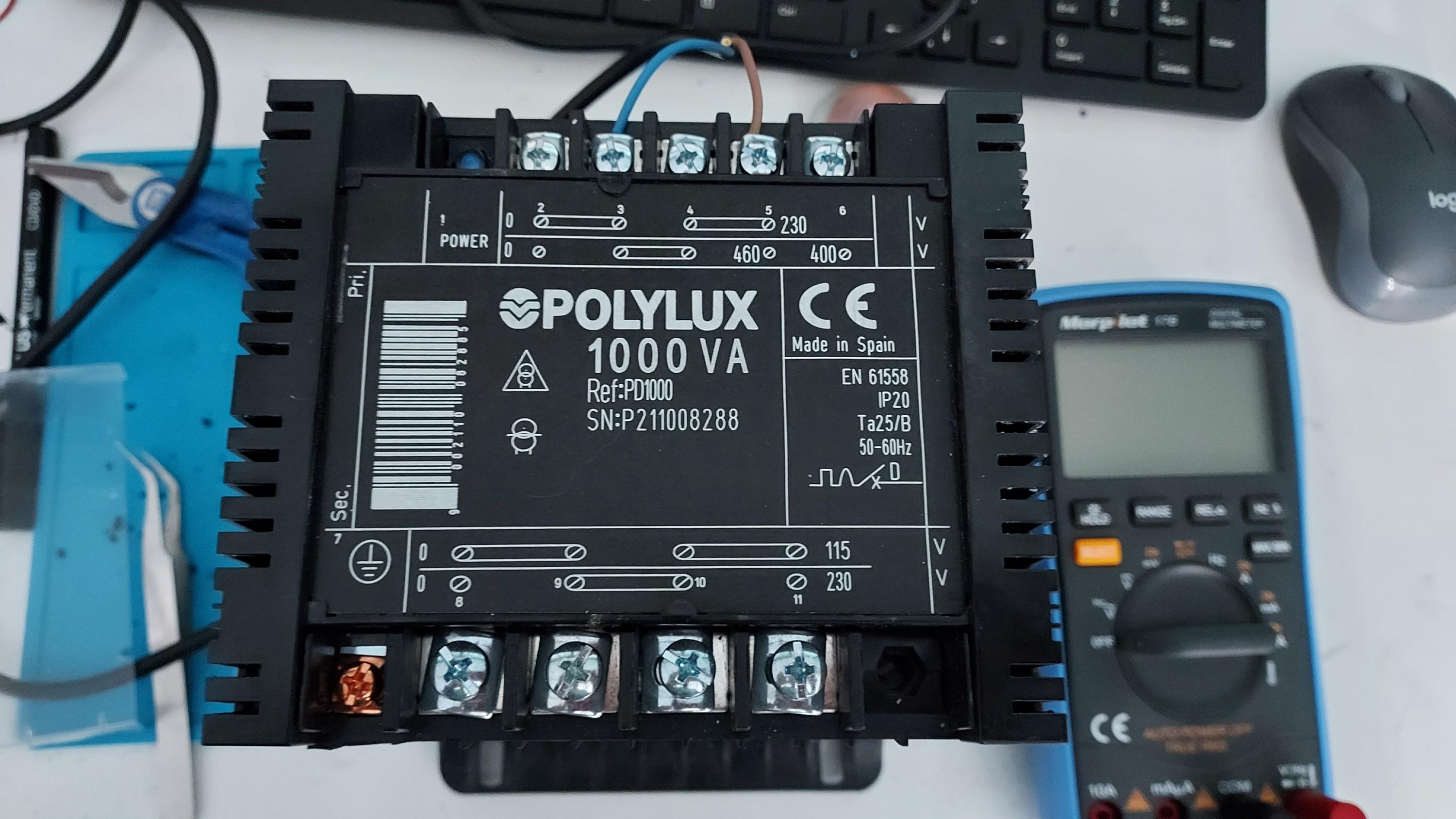

                  I got a Real isolation transformer (1000 VA). However I put 230V on the input and I only have 180V on the output. I am wondering whether to use it or not. The idea goes as follow:
                  I connect the transformer to the main. The output for this transformer to the VARIAC and setting it to 230V. The VARIAC's output to the serial lamp.......
                  Will it be ok or better I keep the current config?
                  Thanks you your patience of keeping me alive
                  Regards,
                  Francesc.

                    isolation transformer should be 1 to 1 so something is wrong .
                      • 31265
                      Re: Am I working safely?
                      got a picture of it?
                      • Francesc V.
                        Tempus fugit
                        • Nov 2022
                        • 231
                        • Catalonia
                        2-4 1 ohm
                        3-5 1 ohm
                        ( I also tried to feed 230 in both "inductances" at same time; same result)
                        I am getting about 180V between 8-11 in the secondary.

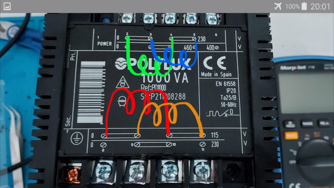

                          Thats a nice one
                          You are doing something wrong with wiring.
                          I guess that in primar is two 230 windings, first between pin #2 and #3, and second between pin #4 and #5.
                          Secondary might be between pin #9 and #10
                          Check double before plug in...

                            its wired wrong .. looks like it needs the jumpers .
                            looks more obvious here ..
                            • harp
                              • Jun 2022
                              • 644
                              • Planet Earth
                              Yes... external jumper settings (connection link) may represent this ilustration indeed, but how he get 180v?

                                Fixed!! I was missing 3 jumpers.
                                2-3,4-5,9-10
                                So.....I will use it instead of the VaRIAC.

                                    No! I have to say that is the most counter intuitive transformer plate description I have ever seen, and I have seen some confusing crap!
                                    Good work getting it working without it blowing up!
